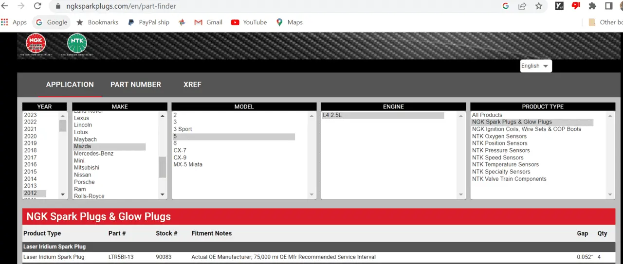

2014 Mz5 Sport with 113,600 miles (182,800 km). In addition to the oil change, drained and refilled ATF, replaced the serpentine belt and spark plugs! It's overdue on the plugs. (And most likely the belt.) We'll see how NGK Iridium IX work out. (y)
Hate to break it to you, but those are the wrong plugs. You needed to get the NGK OE Laser Iridium, not the Iridium IX's.
If you haven't installed them yet, I'd definitely exchange them.
I don't think those are the wrong plugs. NGK Iridium 4344 (LTR5IX-11). Got them at RockAuto. So far so good.
They're not the right plugs, I promise. The correct part number is LTR5BI-13. Notice that NGK states that the LTR5BI-13 is the actual OEM plug. And they should know, they make them.
OK, I see what you mean. You're referring to the OE reference. NGK's list also includes other plugs so I don't see how any of them are wrong parts.
Laser Platinum Spark Plug PTR5A-13 2467
Ruthenium HX High Ignitability Spark Plug LTR5AHX 90220
Iridium IX Spark Plug LTR5IX-11 4344
G-Power Spark Plug LTR5GP 5019
Because the way our motors are, they always, always, run better with the original equipment plugs.This is especially critical with the Skyactiv motors. Luckily our 5's have the MZR, so it's not quite as critical. But still, the price difference is only a few bucks each between the correct plug, and the "yeah, I guess it'll be okay" plug.
Just because RockAuto, AutoZone, or O'Reilly's says a part is compatible, doesn't mean it's the right one to make the engine perform as well as possible.
I can absolutely tell you this: if you ever have to replace any type of solenoid or sensor, ALWAYS insist on OEM.
Thanks for the input and feedback. I've had nothing but good experiences with NGK plugs of all sorts, in a variety of vehicles. Several sets of Iridium IX's included. All were a fit based on NGK web site first and foremost but other web sites made those references too. So looking forward to seeing how the vehicle behaves in coming months.

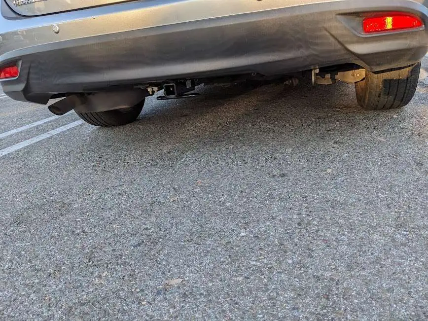

I've installed a draw-tite hitch. Installation wasn't hard, I didn't even have to bend a heatshield for that. I wonder why.
Can you please recommend a bicycle rack for 3 bicycles that would fit?
