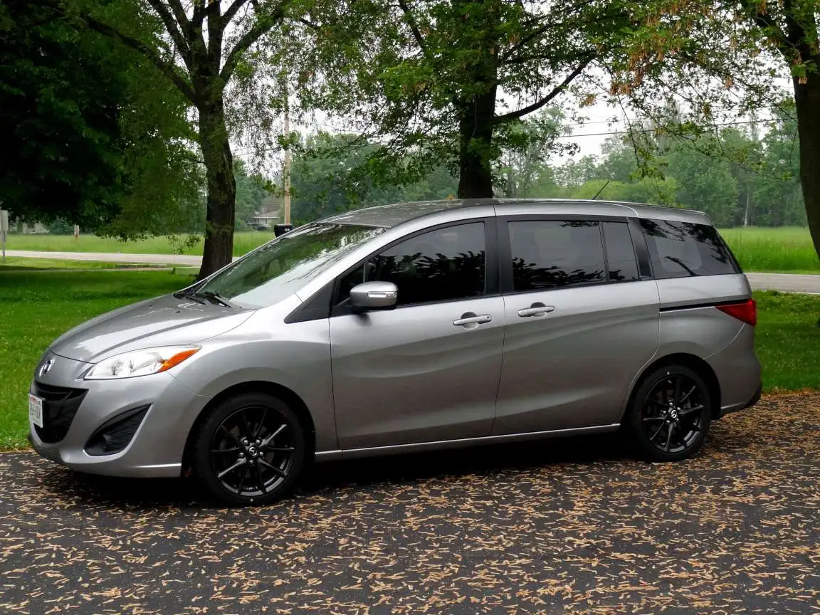

Yes, those are first gen Mazdaspeed 3 wheels. I finally got the part number for the center caps: G22C-37-190A.
Looks complete now :)

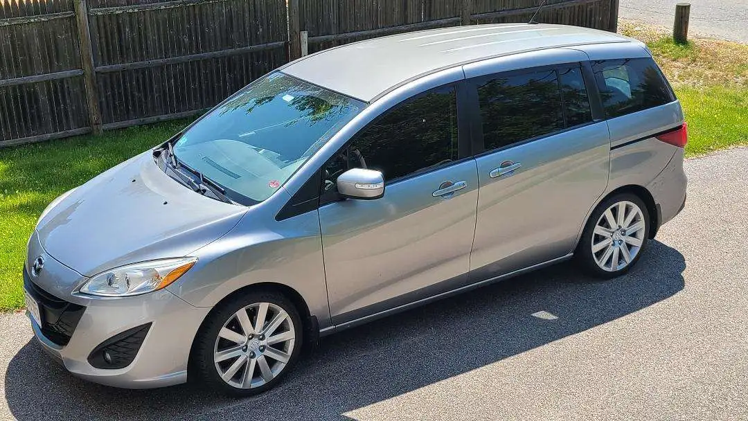

Installed the KSport coilovers, preload was way too low but looked good slammed. :ROFLMAO:
I raised the car about an inch all around after the first fit and rolled the rear fenders. Front fenders were already rolled so they weren't having a rubbing issue. But I think for my next set of tires I need to go from a 225 to maybe a 215.

These look nice! Were they originally for the MZ3? I need to get a new suspension kit; plenty of banging around when I go over bumps 😬

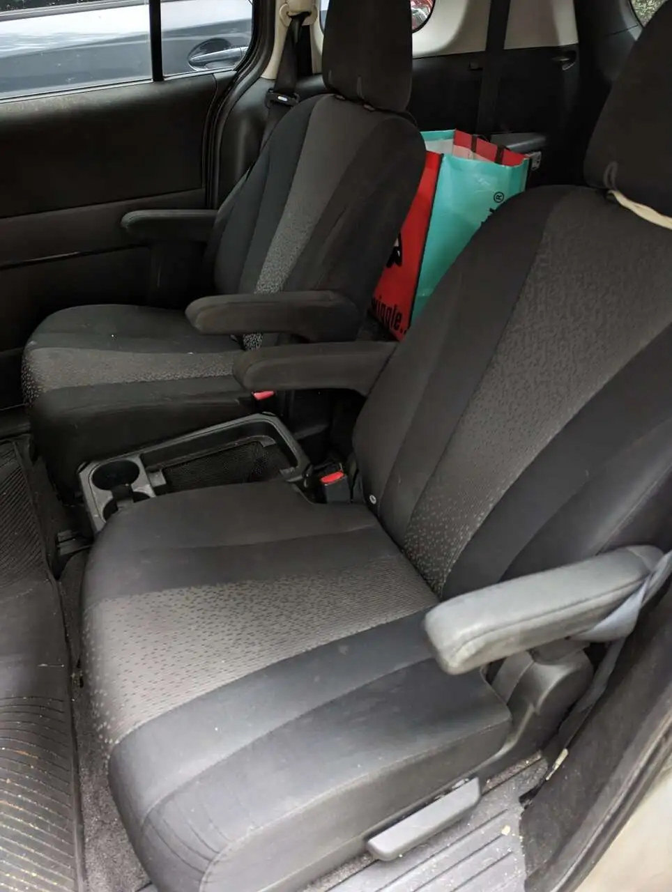

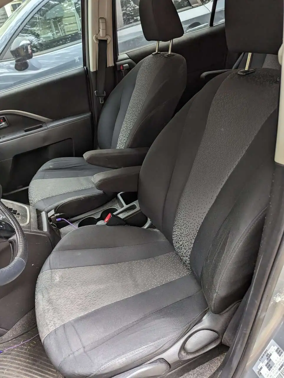

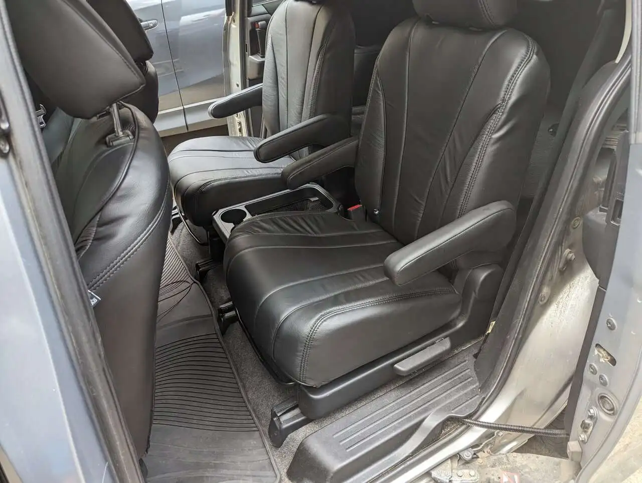

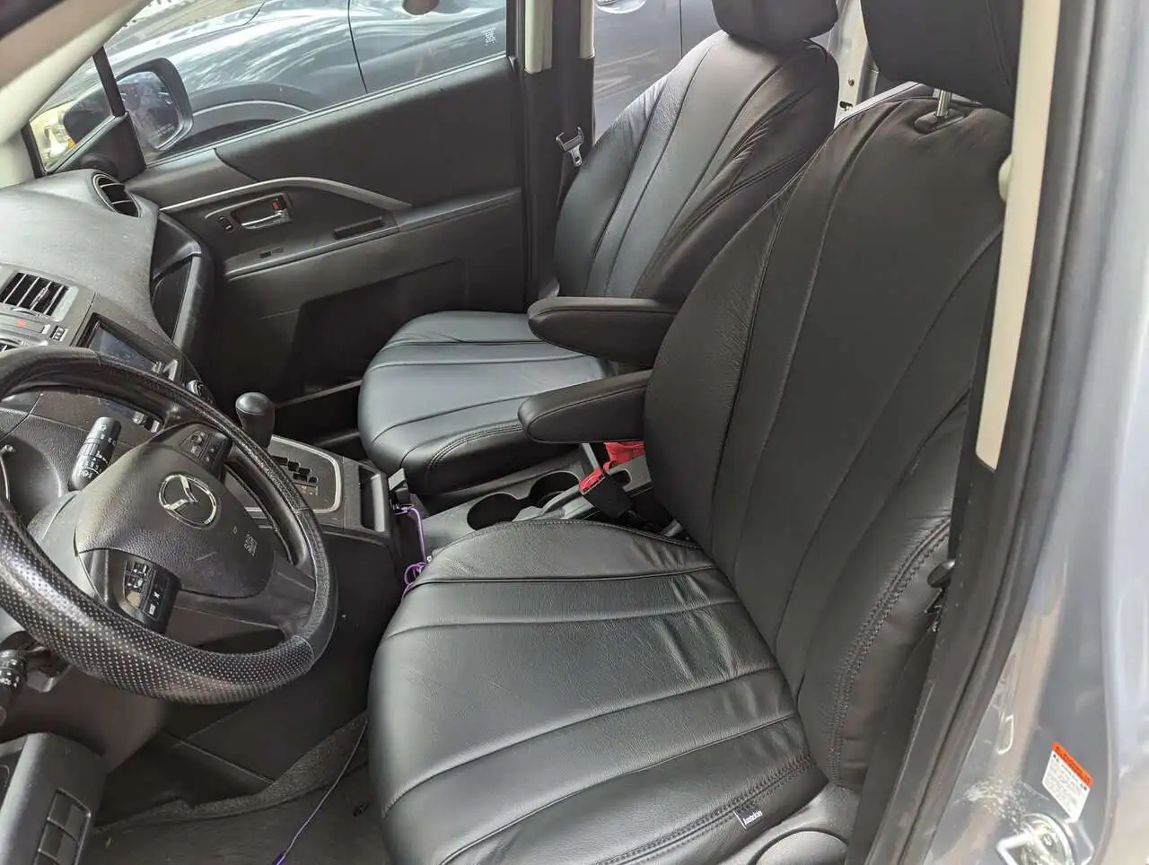

Looks good! Did you get the third row done as well?
I had the seats in my Focus reupholstered by Katzkin and I really liked how those turned out. The extra cost the third row might incur is keeping the wallet safe for now lol...
No, that was an additional $500 for something that gets used maybe once a year.

Sorry for the late reply, I bought these off Redline360 and they were listed for a 2006 Mazda5. I am not sure how much crossover from the Mazda3 to the Mazda5 suspension wise. I havent worked on a Mazda3 or looked at them closely underneath. Pretty sure there is some crossover but maybe not 100%.
KSport has these listed on their site, although the stock image is totally wrong.
You can usually tell if the coil overs are "designed" for the Mazda5 vs the Mazda3 by the spring rates. Mazda5 coil overs will have slightly higher spring rates due to the extra weight of the car. That being said, the two models are interchangeable, and the dampers included are probably the same regardless the springs rates included.
