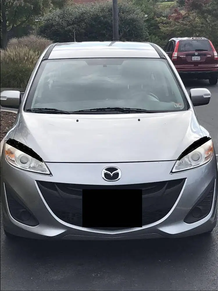

I love the side and rear look of my 13' M-5 Sport. But the front kind of looks like a child with a big grin on their face. I was thinking about painting some lines on the headlight like this 👇
What do y'all think???

Go for it! Lots of options to achieve this - you can use traditional spray paint, or a rubberized paint like Plastidip or Superwrap. My only concern would be whether the heat from the headlights would cause any issues.
IMO your best option would be buying actual "eyelids" made out of ABS plastic or fiberglass. They seem to be available on AliExpress and Amazon, just be sure to buy the right ones for your year.

I looked around and couldn’t find any that was made for a 2013 5. Would a set for the same year Mazda 3 work? They look to have almost identical headlights.

When I did a quick Google search for Mazda5 eyelids, I think I came across a forum post that said the Mazda3 eyelids wouldn't work because the headlight shape is too different.
The Amazon link I posted above should fit. Any eyelids for a 2012-2017 Mazda5 will work.

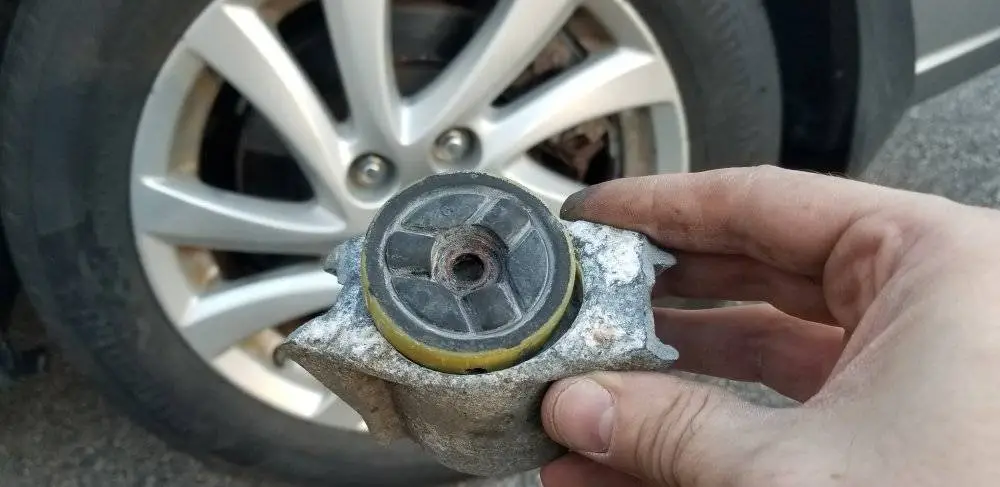

Today was more of an unpleasant surprise, but better to have done it now before the weather turns to total sh%t. I replaced both of the rear shock mounts two years ago. I had to settle for whatever local parts stores had in stock. Even though it has not snowed at all, the roads have been treated a few times so far this season. However, it's been only about two years since I replaced these suckers. This is typically a simple job, but it took me forever to get the shock bottom bolt out. Alas, I replaced it with a new KYB mount. Time will tell.
