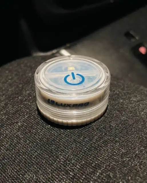

My cheap fix to the poor boot lighting in my M5. The Lluxpro puck light. Super bright for its size, 10hr battery life, replaceable battery, and IPX6 waterproof. About $20 at Lowes for a 5 pack.
