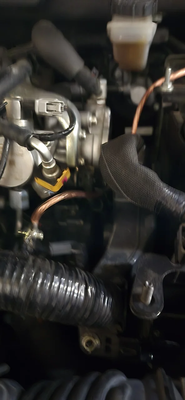

Been driving around with 3 extra cables and still haven't obtained the readings yet. It looks like I am more muscles than brains. 😭
Here is the other obvious grounding point, where the 2 factory wires are attached.
