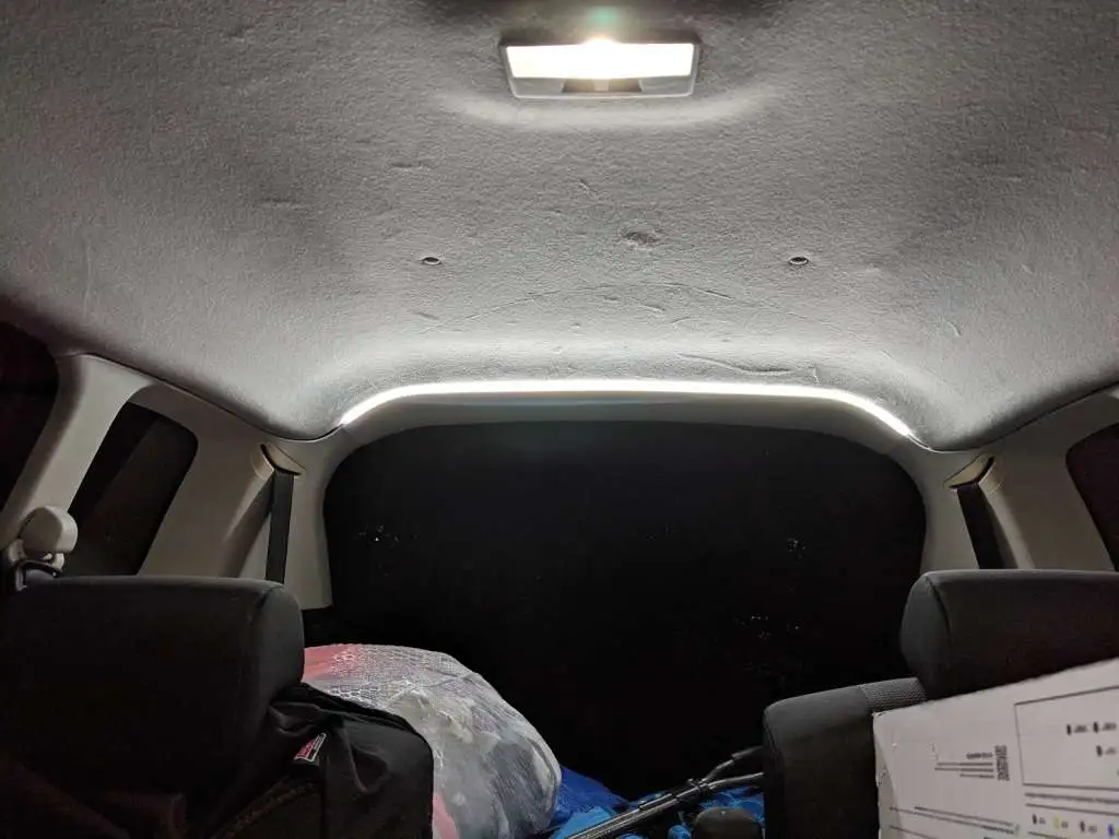

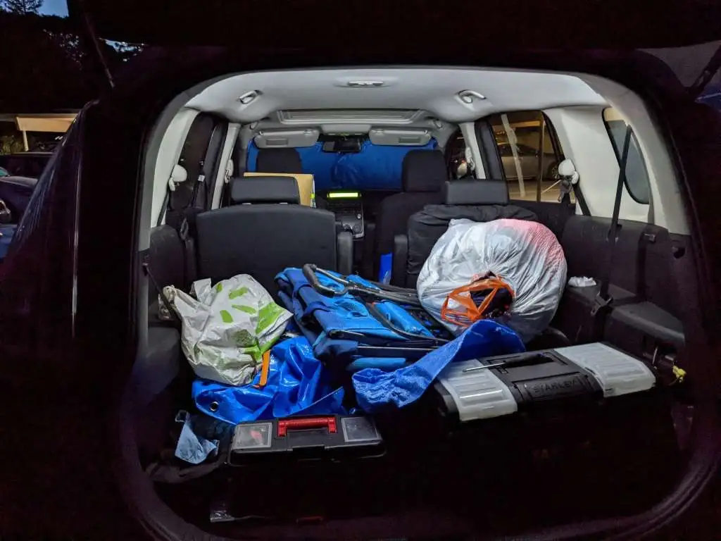

May I suggest an easy mod for the cargo area lighting?
Just wanted to share mine:
Got a silicone led strip (12v) from aliexpress for really cheap, like $5-6 including delivery. link
Then, soldered a wire directly to the strip, added some connectors, and soldered receiving connectors to the cargo light bulb (so that the switch would work). Removed the original light bulb (I also had LED there and it was not very convenient).
Installation is quite easy - just carefully tuck the led strip under the trim, it has a kind of groove for that. Use double-sided sticky tape if you wish, but in my case, it was not even necessary. Fish the wire to the connectors at the original light bulb section. You don't even need to remove the plastic trim for that, you can do this by wiggling the wire carefully.
As a result, when I open the cargo hatch at night, I don't have this super bright light shining into my eyes, but rather a soft white light covering more area. See attached pictures.
Great idea! Did you buy the 1M (39") length? The dim trunk has always irked me and this is such a cheap and clever solution!
Great idea! Did you buy the 1M (39") length? The dim trunk has always irked me and this is such a cheap and cleaver solution!
Yes, the 1M length is enough. I actually had to cut it a little bit - make sure to cut at the markings between LED units, not the units themselves. I also used some glue gun stick to seal the openings instead of the plastic plugs that the strip came with.

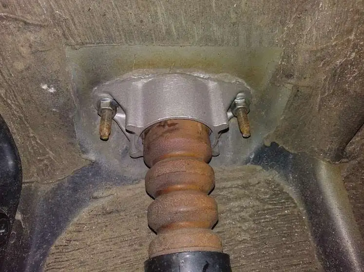

New rear shock mounts and shocks as it was all apart anyway. Heard a clunk and rattle after hitting a very minor bump in the road on my way home from work.
Mounts: KYB SM5619 $14.83 ea
Shocks: Monroe 5607 $35.53 ea
Both from Amazon because they were available for next day delivery.
157,700 miles.
