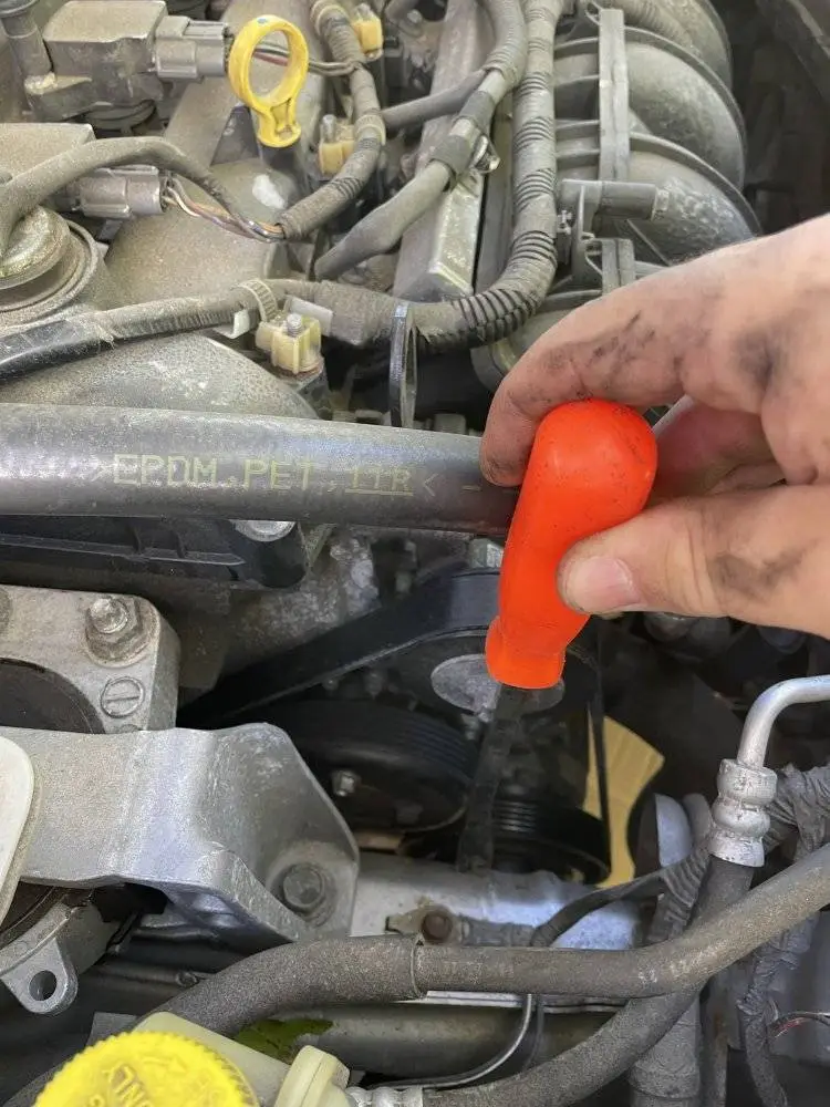

Serpentine belt today at 104k miles. Original was severely cracked. Looked at a bunch of instructions and videos, all of which suggested using a little plastic wedge tool to get the belt to stretch into place because the ‘12 model doesn’t have a tensioner pulley like the 1st gen models. Then I found one video by a mechanic who apparently had to do a bunch of these and decided to find a better way.

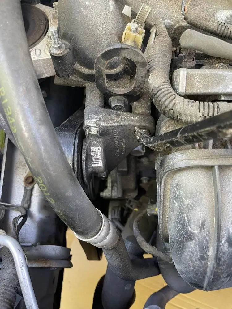

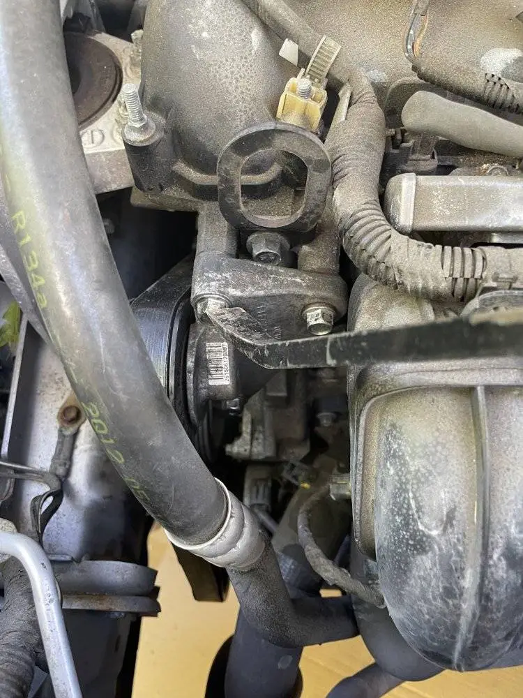

Cut the old belt loose, and route the new belt around every pulley except the top forward one. Then loosen the top two bolts holding the top pulley bracket in place. The whole pulley/bracket will rotate towards the right of the car when you loosen the bottom bolt. Pull the belt over the pulley, and then using a pry bar between the frame and the pulley mounting bolt lever it up into position. Stick the top bolts back in and torque them down. Less than 10 minutes including jacking up the front end so my son could help guide the belt around the pulleys from below. No special tools needed. (13mm socket, ratchet, 3” extension, and a 2’ piece of pipe because I can’t find my long pry bar)

Remove these two bolts
Pry here (I used a 2’ pipe because this pry bar wasn’t long enough)

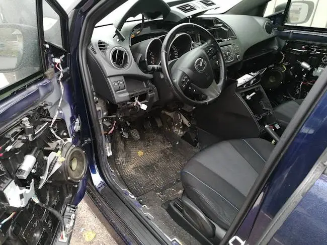

Wasn't just what did today, was actually whole weekend project
Installed amplifier under front passenger seat, changed the front speakers for 2-way setup.
It's was really PITA to get the wires in the door, but I made it.

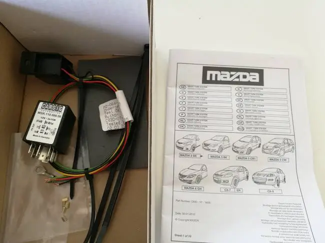

Also when the glovebox was out, installed Mazdas original "smart turn system" to bcm wires.
Smart turn system is extra relay what makes triple blink when changing lane.
I love the smart turn signal system retro fit you did. Do you know what years of Mazda 5 that works for?
What's the part number for the smart turn signals?
Part nr. C830-V7-160B
According to instructions it fits both gen 5's
Also interested in the smart turn mod. Any comments on where you got it, how much it cost, and what the install involved?
I just checked the smart turn signal system and unfortunately you can't get it in Canada the part number doesn't even come up in their system at Mazda ☹️
