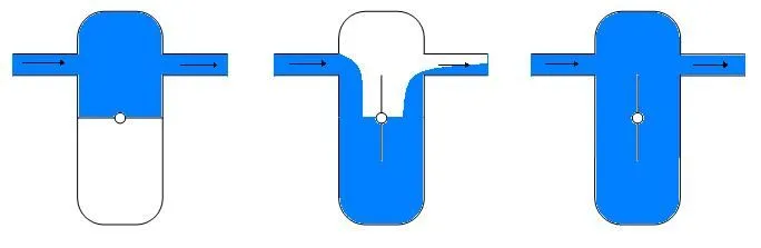

That is so weird. I figured that it would have the extra area below 5200 for pulse charging, then close it off above 5200 to keep the velocity up. I was thinking that I would make it switch over at 0 psi to give a straight shot to the valves. Oh well, that sucks. Thanks for the heads up.
Yeah it really threw me too.. I figured it was simlar too... figured bigger chamber volume for simulated longer runners which is better for low end... but NOPE!

So:
Under 5200 rpm: The solenoid is activated (12V relay) by power from the ECU allowing vacuum from the manifold to pull the VICS valves shut (ie - block off the extra runner volume)
Above 5200 rpm: The solenoid is deactivated (the solenoid valve is normally closed, blocking vacuum [open circuit]) allowing a spring to open the VICS valves and reveal the extra runner volume.
To summarize: below 5200 rpm there is less runner volume than above 5200 rpm.

The chamber is always full of air, so there is no lag time... it's just changing where the pressure waves bounce off of... whether they bounce off the butterflies or off the back of the chamber... so it kind of kills your theory... the butterflies leak just enough that that chamber will always be full of air... and any "recovery" time would be less than a millisecond... so that won't have any visible affect at all. The VICS actuator is the one that has an arm that goes to the middle of the intake rather than the other actuator that goes to right where the head and intake manifold meet... they are the two big brass weird looking things on the passenger side of the manifold.

Excuse this if someone has explained it that way before, but I couldn't find an explaination of exactly how it works.
This is the only thing that would make sense to me. The extra chamber is more for pulse tuning, which I would think makes more sense for N/A applications than F/I. Most people know that there are intake pulses that are causes but the intake valves opening and closing (accelerating and decelerating the speed of the intake charge). So I assume that the extra chamber is designed to make the intake pulses line up with the timing of the intake valves o keep the charge inertia up. I can see why having a cleaner intake manifold would be great for MSPs since those pulses don't mean crap once the turbo starts spooling.
So basically I think that it has less to do with airflow/air column length an more to do with the rhythm of the intake pulses.

Your explanation of how it works is correct... however what is incorrect is that the FI cars do benefit from it... if you look at my dyno sheets they are at 10 psi comparing the VICS closed and the VICS open... with it open ("activated") there is more power by a LARGE margin... so that extra chamber helps... no what it does down low I don't know, and in an FI car I do agree it is more useless down low as we typically have enough boost to compensate for any lack of power around 3000 rpm's.... so yeah... I left the actuator on the side, and the butterflies in the manifold, but removed all of the solenoids and wiring.
