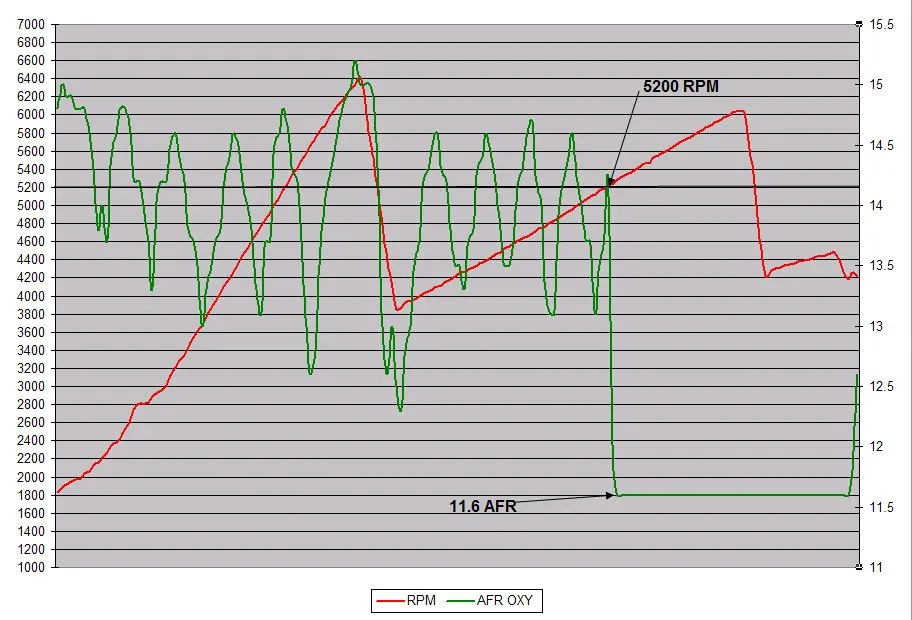

Sorry to bring this back but I am still a bit confused. Please clarify this again for me. I attached a chart that I made from my MPI datalog. You will notice that at WOT in 2nd gear, at 5200rpm, my AFR drops significantly to 11.6 and stays there until I let off. This happens because VICS physically closes or opens? Or is it because the VTCS opens or closes? And if I remove the VTCS, which I plan on doing anyway, will that fix it? Basically, what exactly is happening at 5200rpm and how do I prevent this from happening? Am I just not getting enough air volume into the engine? I also noticed that this only takes place in 2nd gear and up. One more thing I forgot to tell you, I am NA with the auto sportshift trans. See sig for mods. Thanks all.
The vics butterflies open at that point... but the reason for your AFR drops is the VE (volumetric efficiency) of our motor goes to crap after that point... that's why revving out to 8000 rpm's doesn't help a lot. Porting and polishing, and modification of the valves, and some cam changes are th eonly way to prevent it from happening.
You don't see it in first gear because the loads on the motor are likely not quite high enough, and it will happen quite a bit quicker.... you can adjust all fo this with the MPI and that will help you out... just add "negative" fuel to correct it out.
Let's say I disable the VICS from opening. Won't that keep my AFRs from dropping but would that hurt my power up top? What do you mean exactly by volumetric effiiciency? The engine is getting too much air volume that it can't handle or not enough air volume?
I tried pulling a ton of fuel with the MPI at that range but it just does the same thing.
Keep VICS from opening (by lockign actuator in the pulled spot) and the AFR's will get even richer and you'll lose a ton of power (noticeably so).
Volumetric efficiency means how good the motor is at pulling air in at a given rpm... how much actual volume of the cylinder is used... You don't actualy get "100%" filling on every stroke... if you kept the pressure the same at the bottom dead center stroke, and used that as your 100% if you left that open to the air... the motor probably peaks out around 80% filling during normal operation... (i don't know the real number, but I could calculate it roughly based on fuel consumption)... as you get toward redline on our motor, it drops off considerably.... maybe to 50 or 60% ... so suddenly as you pass 5200 rpm's you are getting about 20-30% LESS air that makes it into the motor... now if you inject the same amount of fuel as at 5200 rpm's you suddenly are a whole lot richer...
You should be able to pull fuel out... or the MPI may not be capable of doing so... it sounds like it is not doing it for some reason. Either something is the matter, or the MPI can't lean out fuel.
