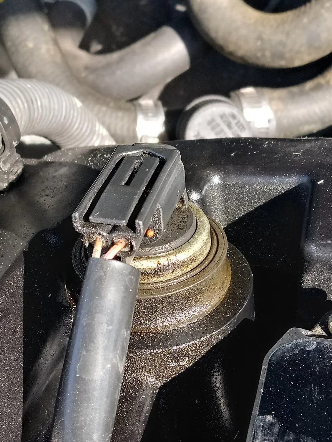

The is a gasket on top of the valve cover that leaks, its for the oil control valve. Those leak very slow.and on top of the valve cover so it doesn't spill down on the hot surfaces so you wouldn't smell it.

The oil valve gasket is on the top left of the engine
^theres a picture of where mine leaked at, it was suggested to replace the OCV, ocv gasket, and valve cover gasket because one guy I spoke with had replaced the OCV gasket and head cover gasket only and it turned out to be the OCV valve itself that was leaking. So I replaced all 3.
Have you removed the top engine insulator/cover and inspected the valve cover yourself? Just recently I found ours was pretty wet with oil all over it. Some was coming from the gasket portions around the spark plug holes, around the edges, and the oil control valve itself.
Keep in mind that I never saw any wetness underneath when doing oil changes, or smelled anything dripping on the exhaust. But the valve cover itself sure was messy. I installed a new OEM Mazda valve cover gasket and OCV gasket last weekend. With parts retail prices, the time it takes to clean up the valve cover itself, and the gasket mating surface on the head, apply the new sealant to the head and then install the gasket back in place, I can definitely see it being $200 with shop labor rates.
I'm hoping this will at least somewhat reduce the oil consumption/loss I've been seeing between oil changes.
