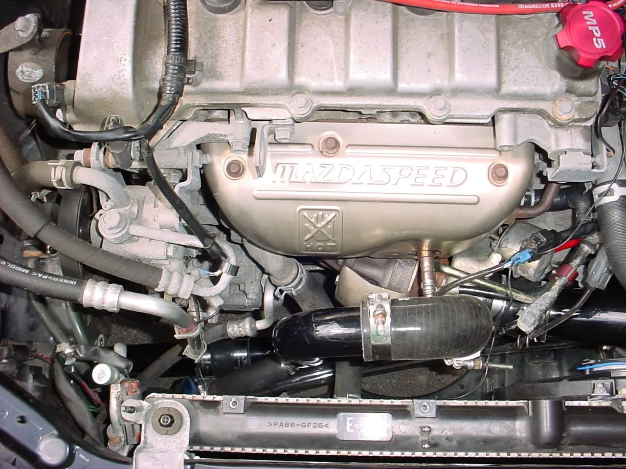

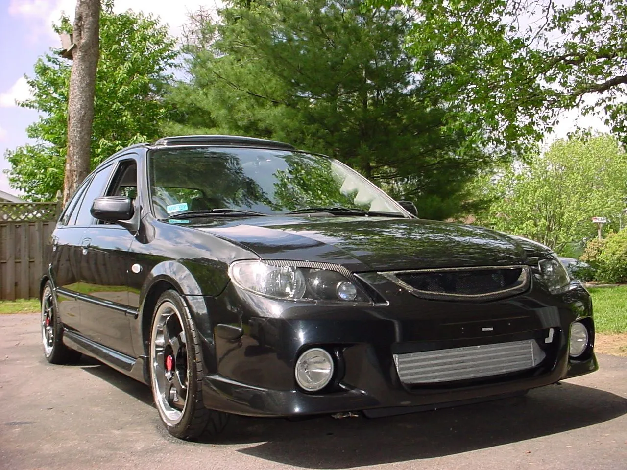

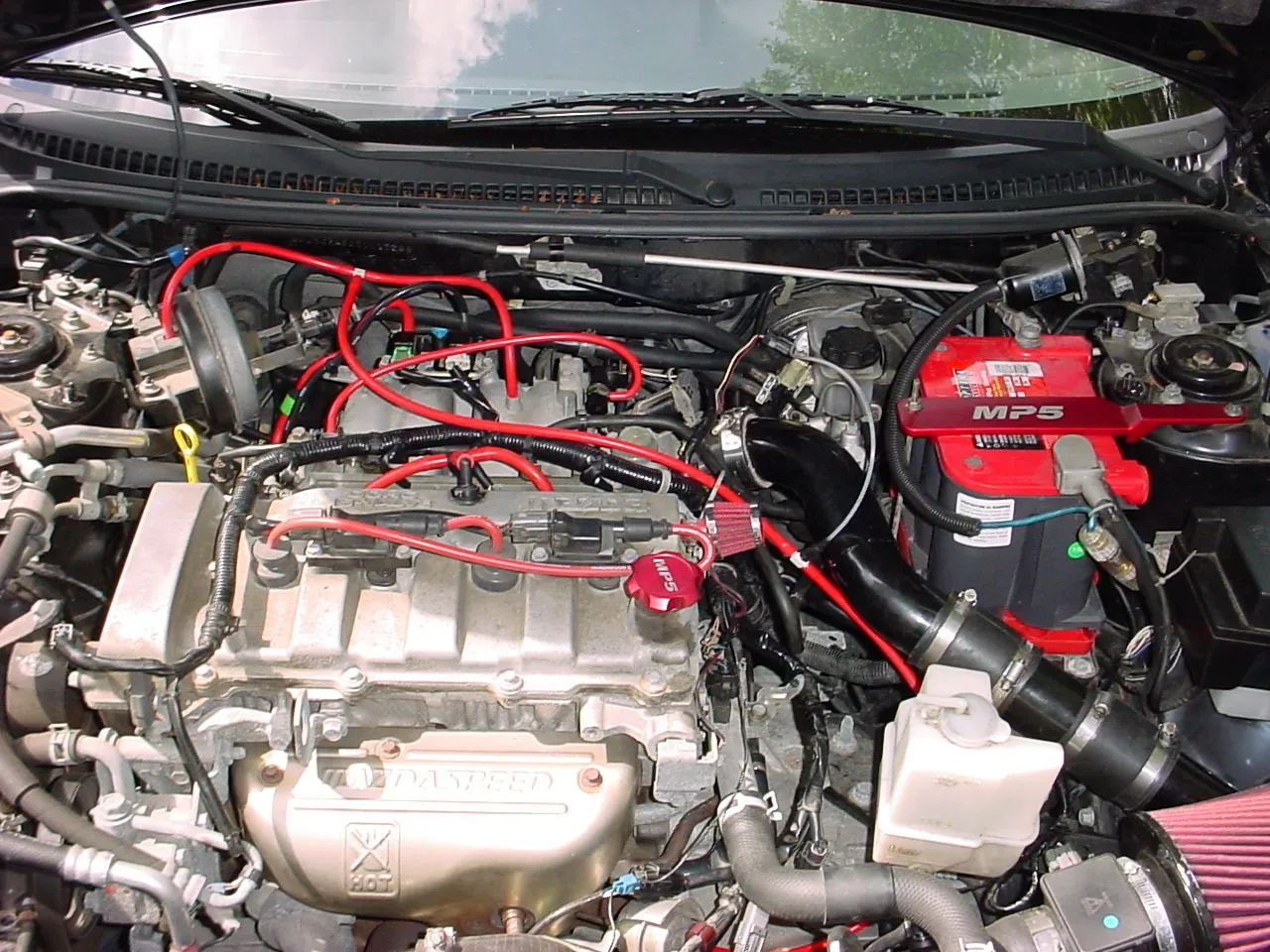

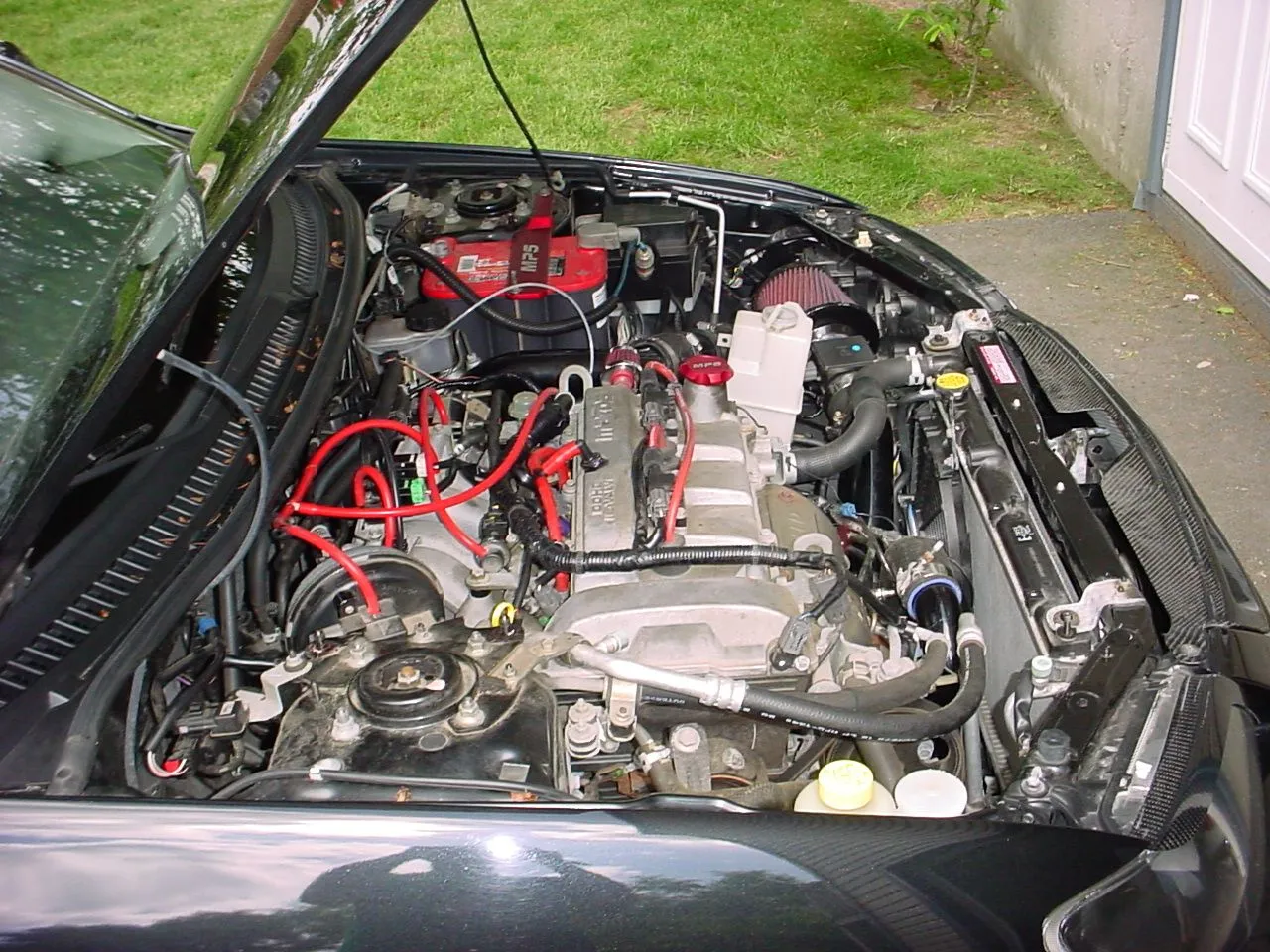

Ahahahahaha, excellent guys! I've been out driving her around, enjoying the benefits. There's a few things that need to be tweaked, but she really is running great. The first thing I have to fix is the oil return line. I cut it short by about an inch and a half so it's leaking a tiny bit of oil. I've been checking the oil level all day and it's been fine, but still needs to be fixed. Gotta finish hooking up the turbo timer, 3 more wires! The check engine light is on, I'm not sure why, everything is hooked up. Well, there's a 6 pin connector below the battery that I have not found one friggin place to hookup to. I checked everywhere it could possibly connect, nothing. Any ideas? Other than that, she runs just like she did day 1, except a little more user friendly. ;) It's holding steady at 5psi with an occassional jump to 6-7 when I get on it. I'm incredibly satisfied and you guys are right, it was def worth all the hard work, blood, sweat and tears! Some new pics, I'll take more, and I forgot to put the strut tower back on before I took these, ha!

you sure that connector that is hangin isn't the other sensor (not the MAF connector) that went on the stock air box? or SRI if you had one of those.
Awesome! You should paint the intercooler black... it'd look sick. Keep us updated on how you like it and stuff, like what kind of MPG you get. Very curious!
very nice...did u replace both of your radiator fans or only one of them?...
Both fans were replaced, I'm gonna get better pics of everything. I had the stock intake previously, so the IAT sensor can just hang? and is that what's causing my cell, cuz she's purring like a kitten!
did you put coolant back in that bottle? it's empty in the pic but could be before you were done.
probably want to just start getting the codes read from auto zone or wherever before you stab at the problem.
