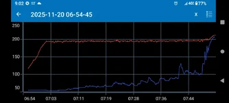

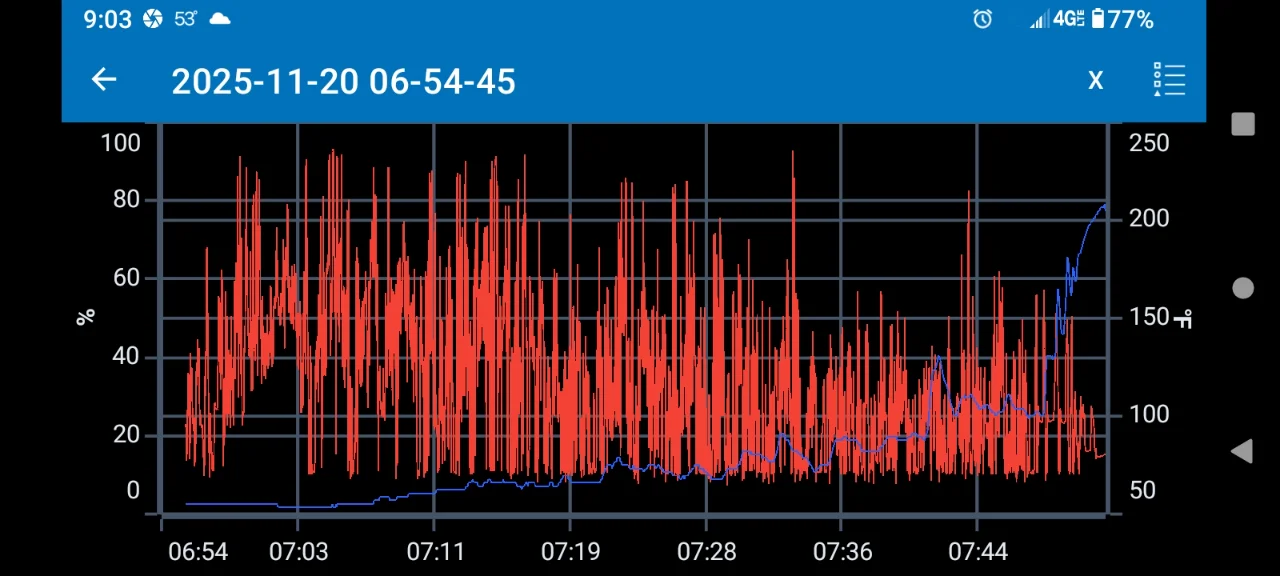

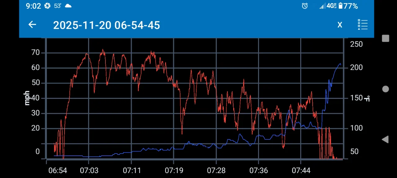

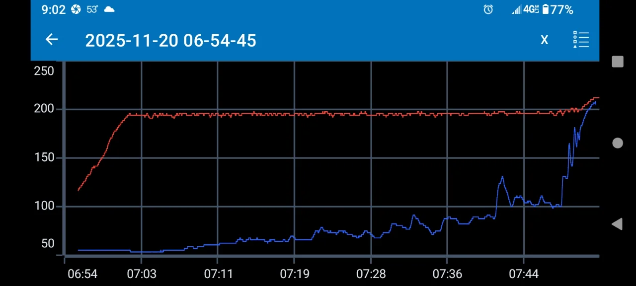

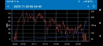

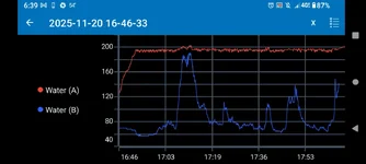

The app gives me two coolant temperatures, A and B. A is the figure that I am familiar with (ideally 194~212). B is higher than ambient, lower than A, and fuctuates similarly. Do we have two temp sensors for the cooling system? When Temp B was around 120, the lower rad hose was cool to the touch. When Temp B was at 185, lower rad hose was as hot as the upper hose. So far I have only been checking when the engine is off.
For the drive to work this morning, traffic was heavy. Temp B didn't increase much until much later into the drive. It climbed to almost as high as temp A in the last ten minutes (880N Oakland area).
Having watched a 3D animation on YT, I believe temp A is the engine side of coolant temp that gets hot quickly and stays hot (as well as the fluid in the heater core). Temp B is the radiator side, it starts out close to ambient and climbs gradually, not from coolant circulation but from heat in the engine bay (?). Coolant in the radiator joins in the circulation at a point that is not 180 or 194. The point where temp B started to rise drastically (meaning hot lava from the engine is getting mixed in, temp A was 200.
There seems to be a correlation between the speed and temp B. When the traffic slows and the speed drops, temp B goes up. Don't see much of a relation between load and temp B. Are both temp sensors analog/mechanical?
Edit to replace with better charts: first one is speed and Temp B. Second is absolute load value and temp B. Third one is temp A and B.

Temp B is from the radiator. I just checked after arriving at work and the reading on the cap is consistent with the OBD figure. The lower rad hose was warm, the top of the rad was cool to the touch, upper rad hose was hot hot hot. For this one-hour drive, coolant in the radiator wasn't utilized. Temp sensor, thermostat, or both? 🤦

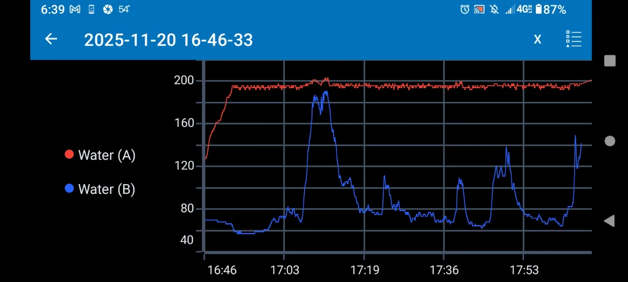

My small OBD scanner has a temp1 and temp2. As far as I can tell, temp1 is the engine coolant temperature and temp2 is the coolant temperature leaving the heater core as measured by the sensor on the heater hose "manifold" on the passenger side firewall that both hoses attach to. Monitoring t1,t2, when engine warmed up, they will agree within a few degrees (I've had them read identical) and then t2 drops as expected when the heater fan is turned on.
So temp A is from the primary sensor near the thermostat. Temp B is from the sensor on the firewall near the heater core. Does A have anything to do with B?

In the typical Friday afternoon traffic on 101 South, I finally figured out how the cooling system works. Temp A shows coolant temp in the engine block. The thermostat is the first gate keeper in the system. It doesn't open until the engine gets up to temp at 180. It is mechanical and straight-forward. At 180 though, the hot coolant doesn't go straight to the radiator yet. There is a second gate keeper, the coolant control valve. As the brain of the operation, the ECU considers certain vital signs and determines when to open the gate to cool fluid. Speed seems to be one of the factors. If I am going at 50+ mph and Temp A is 194, Temp B fluctuates slightly. It was 70 before the slow crawl. However, if I am slowing down to 10 mph and Temp A starts to go up, Temp B would start to go up fast. It seems that a need to provide relief was detected and access was immediately granted. Temp B would go up to about 5 degrees below Temp A. When Temp A gets as high as 212, the fan kicks on and both figures start to go down.
After the episode is over (Temp A back to normal and speed is up), CCV closes the gate and the radiator starts to cool things down. It takes a few minutes before Temp B is down to 70~80. It will be ready to mix with hot lava at the next event.
The sensor for the cool fluid is located on the firewall, but the figure is the same as what is shown on the rad cap. There must be a reason for this, I hope to figure it out soon.
I am learning new things backwards. 😂 Someone is going to tell me that CX-3 doesn't have a CCV.
EDIT: The criteria for the CCV would include air flow. There are several sensors/values for the MAF and intake, they can also reflect the state of the vehicle as to whether temp relief is needed.
