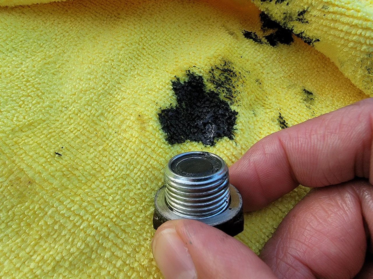

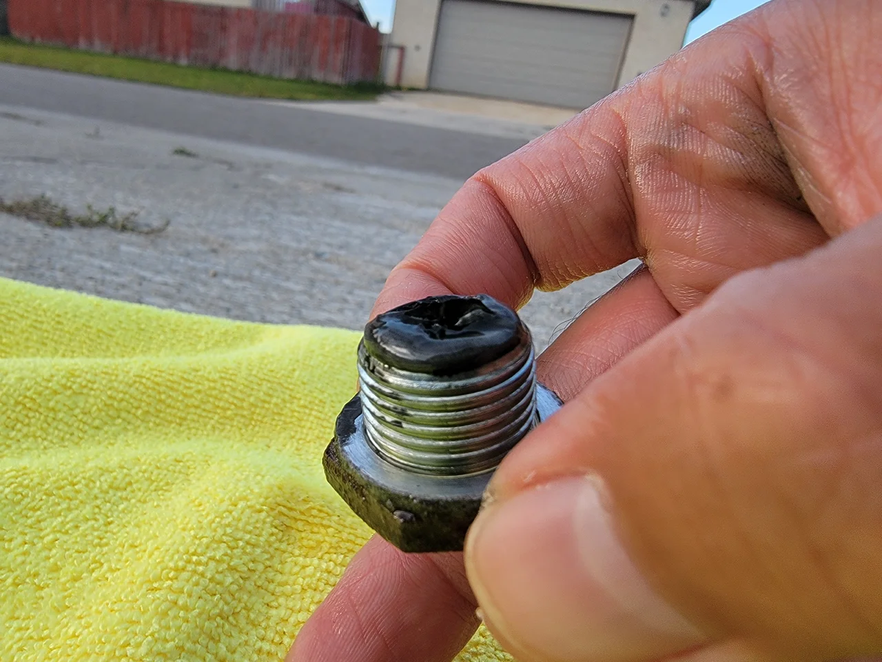

Asan aside, do you know if the diff drain plug has a magnet in it? I put a magnetic drain plug on the oil pan this last oil change. If the diffs don't have magnetic drain plugs, I'll replace them.

The diff plug does have a magnet in it. I did a rear diff oil change on my 2022 CX-9 as soon as I bought it (used with 70k kms). The fluid was a honey-coloured and the plug had a small amount of metal on it (pics below).

We often forget that the shaft seals allow dust into the system, clutch and metal from the gears and bearings. The oil breaks down after time as well.
I'm glad to see a magnet that is picking up clutch dust.
