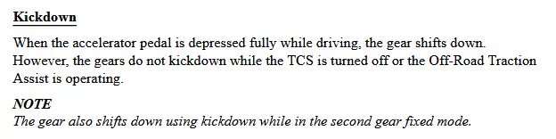

That is KICKDOWN. From the 2022 CX5 Manual. So unless somethings changed...since 2022, Y'all have kickdown.
No one is arguing that we have kickdown or not. We're talking about the switch/detent, which does nothing but provide feedback that the pedal will not go any further.
As far as I know, there is no kickdown "switch". The entire thing is drive by wire with "kickdown" determined by load and pedal position.
As you said, the detent does nothing but let the driver know that the pedal isn't going to go any further.
That sounds to me like you are saying there is no kickdown.
Happy to be wrong...we can move on. lol
