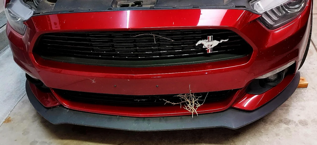

As promised...so we are having a wind event here in the dessert SW and after getting home yesterday, I took this pic. It clearly shows bits of tumbleweed and 2 other intrusions, one of which broke thru the material. Apparently, it was enough to slow down the rock, or whatever, since inspection with a flashlight shows no fin damage. Mission accomplished!
Should be easy enough to pull that hole out to make it even with the rest...
BTW, if the mesh was up against the IC, damage would have occurred for sure. Instead, it must have lost energy and fallen down before hitting the IC.
Well you put the mesh to the test and it passed.

Well my wife was driving the Mazda that day and I the Stang. She thought it was pretty stable but reported a weird noise thru the drivers door seal maybe? I think with the 40+ mph cross wind, a Helmholtz resonance set up and was messing with the door seals.
Here is a pic of the Stang front end...and both cars are coated with dirt and dust.
Yikes that environment is tough on the finish!!

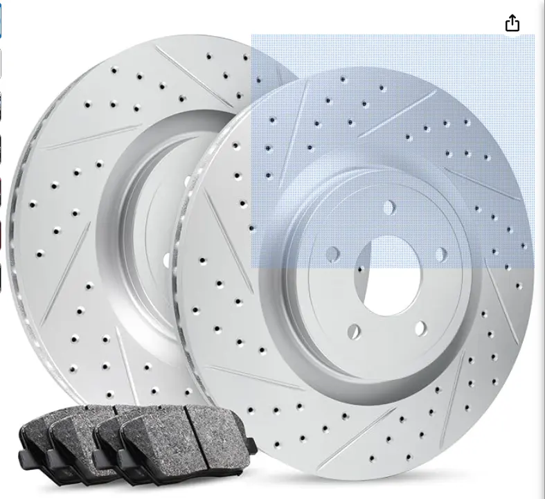

After four months of ownership, I bought R1 Concepts drilled and slotted rotors and brake pads from RockAuto. Installed them one evening. That's been 12,000 miles ago. They still run true and little to no brake dust on the wheels. I have $160.00 in this solution for better braking and reduced chance of warping rotors.
This car is the first time I yanked off working parts and installed upgraded parts. I decided life's too short to suffer with the quality of ride, engine and brake performance, wheels and tires until they wear out. We transformed it to a CX 5 T SPORT.
