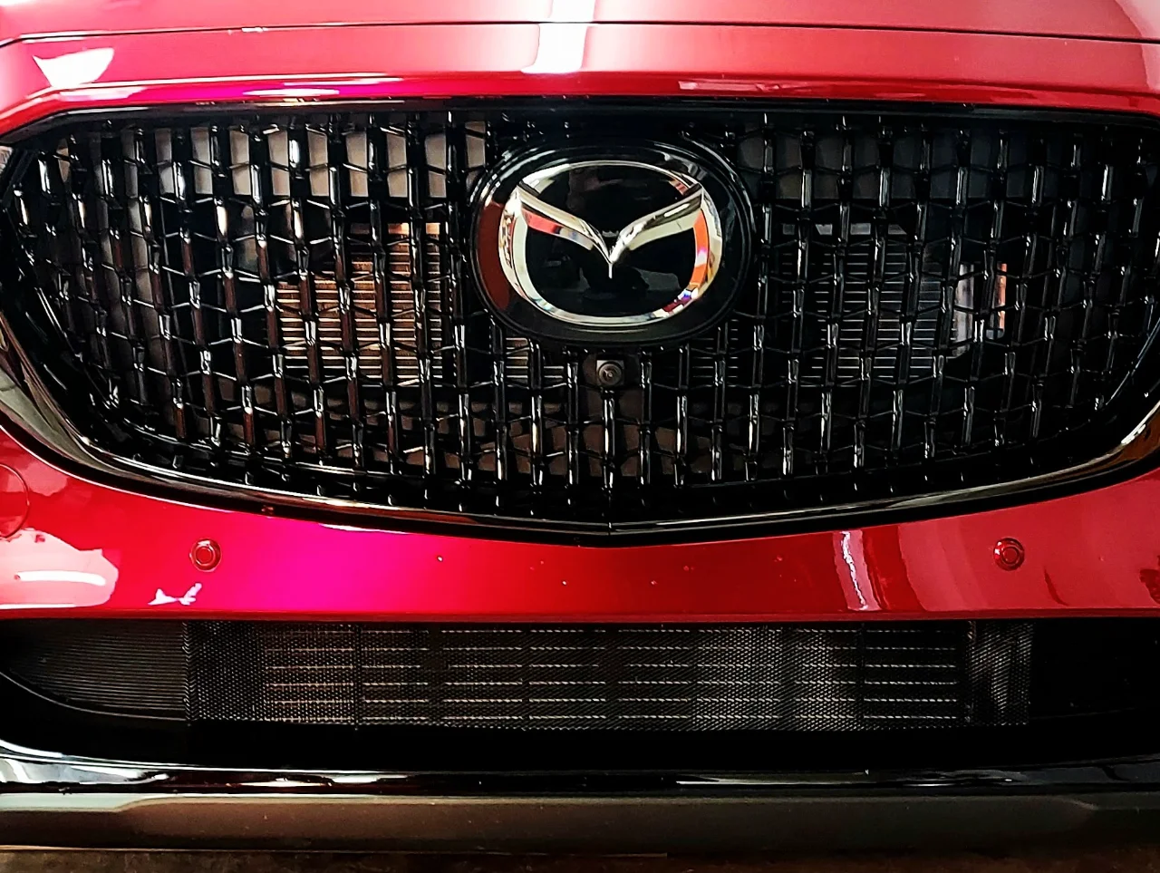

Well after inspecting the sitch, I decided to KISS...if it doesn't last well then back to drawing board.
I measured the space to be 3.5 inches tall, so I cut off a strip that wide. Watch your fingers for sharp edges. Then I measured the width to be 27" but added 1/2", could have been 1" in retrospect, for a total of 28". I folded both sides at 90* and marked 4 hole locations for small black button head screws. After pilot drills, secured the mesh with the 4 screws. Also had to chamfer the top corners due to rubbing. Took about 30 minutes...
Another reason for the KISS method. I will monitor it for bugs, dirt, weeds, etc.

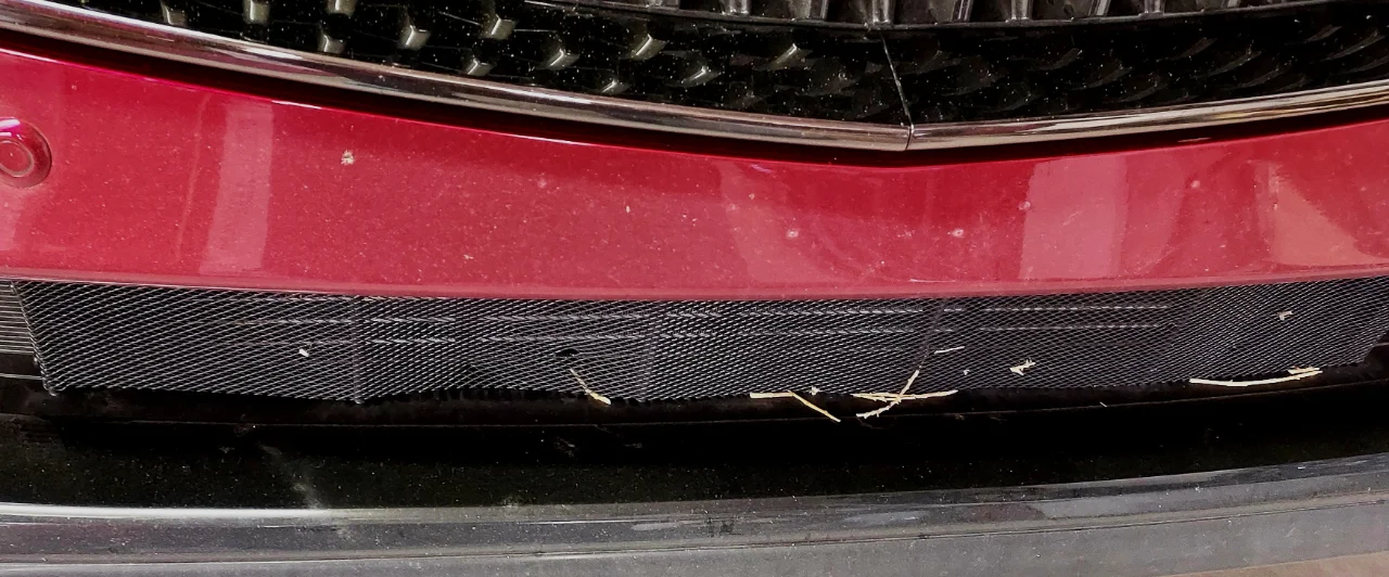

As promised...so we are having a wind event here in the dessert SW and after getting home yesterday, I took this pic. It clearly shows bits of tumbleweed and 2 other intrusions, one of which broke thru the material. Apparently, it was enough to slow down the rock, or whatever, since inspection with a flashlight shows no fin damage. Mission accomplished!
Should be easy enough to pull that hole out to make it even with the rest...
BTW, if the mesh was up against the IC, damage would have occurred for sure. Instead, it must have lost energy and fallen down before hitting the IC.
