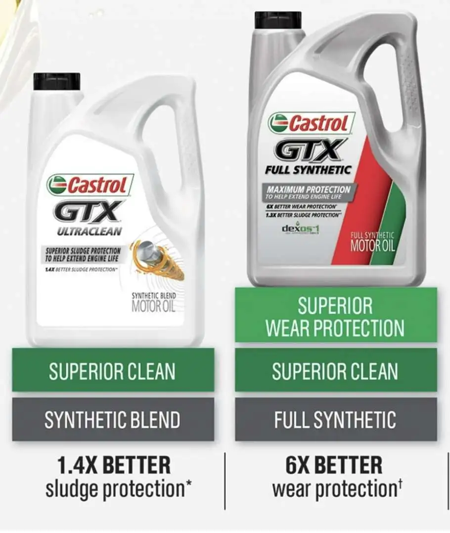

But ....Castrol 5-w30 GTX is full synthetic and GF-6 ? So is Edge and Edge extended life - ? I suppose they all work fine
My bad. We’re talking two different flavors of GTX. I didn’t realize they made a full synthetic (not available on my local Walmart). All I saw were the white bottles, synthetic/conv blend.
I’ve been using Castrol oil since 1980’s. At the time Castrol mainly was selling Castrol GTX of course that was conventional oil. In 1990s Castrol came out with Castrol Syntec full synthetic oil where the “Syntec” name used only in US market. In 2000’s Castrol Edge series full synthetic oil came out but we still can see Castrol Syntec at certain places. In 2010’s I also noticed Castrol GTX has changed to “blend”, and now we also see Castrol GTX full synthetic oil.
I still have a couple of boxes of Castrol GTX 5W-30 conventional oil in white quart bottles. And that’s the oil my 1998 Honda CR-V EX AWD with 189K miles has been using since new.
