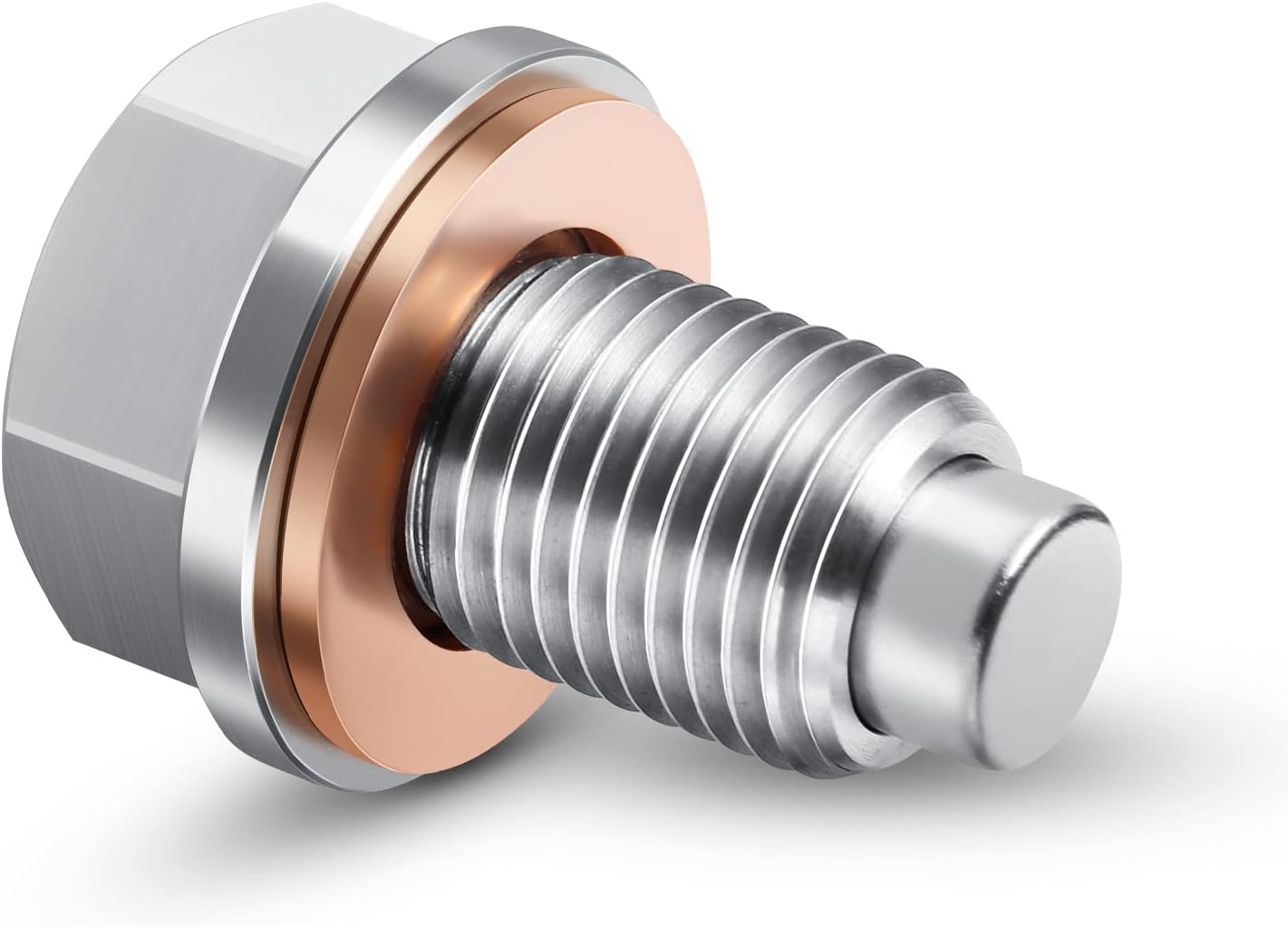

Replaced the standard, non-magnetic drain plug (M14x1.5)
with a magnetic drain plug.

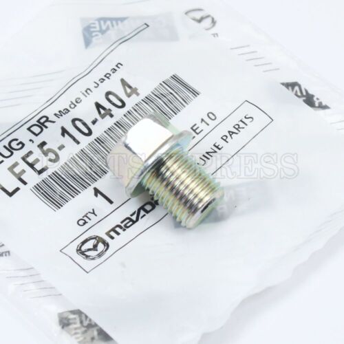

what car takes that OEM drain bolt? Ours is black, with a flat round head, and takes a 8mm hex Allen wrench/socket.
CX5 GT
All 2018- come with it. Mazda switched to it, probably because mechanics were smashing the hex :)
I think it may be compatible and you can replace your existing flat hex. Used to be around 8usd back in 2019

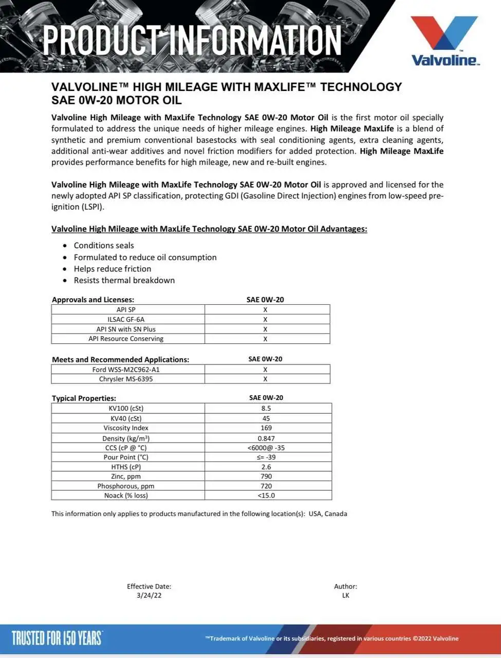

Yes the Valvoline High Mileage with MaxLife Technology is a blend and does offer 0W-20 viscosity.
I would be concerned about the rather high Noack volatility (evaporative loss shown as < 15%) contributing to deposits, especially on valves in a GDI engine which don't get washed from fuel mixture flow. Or deposits causing sticking on the low tension piston rings that are prevalent these days. JMO

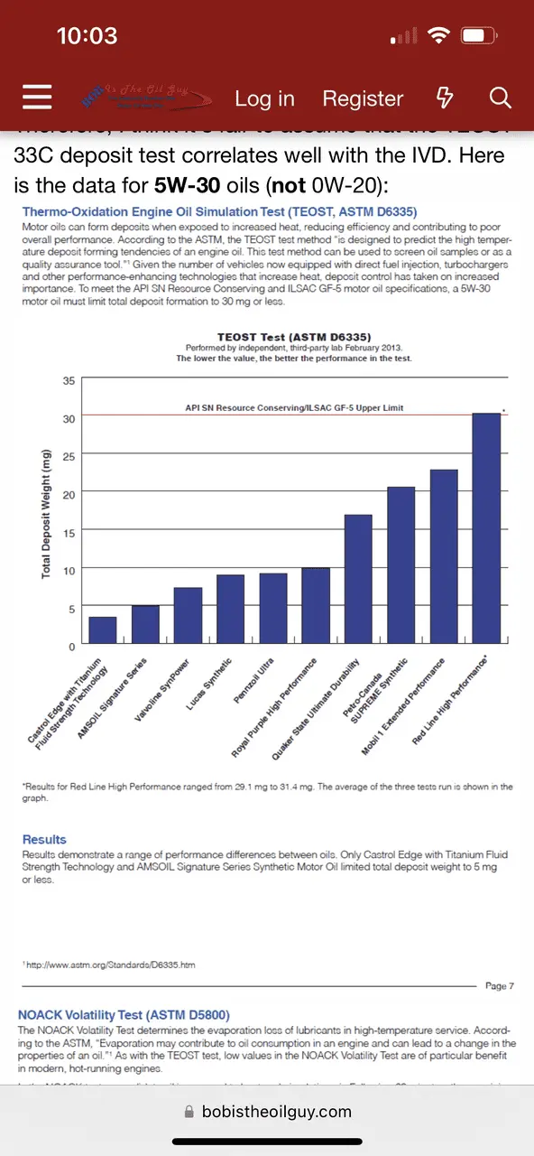

Thanks for sharing the links above. I found the Castro Edge 5w-30 results intriguing for the bar chart shared at BITOG. Very low deposits. Going to give that a shot.
Would love to see this chart. Need to do an oil change here fairly soon.

I took a screenshot of TEOST test results when I fell down a hole from the BITOG link shared above. There’s debate on whether or not the TEOST test correlates with preventing intake valve deposits, but it’s less controversial believing it’s tied to preventing deposits in the turbo.
What I didn’t screenshot was that the Castrol was on the higher end of the NOACK results (higher being “worse”). Take that for what you will.
