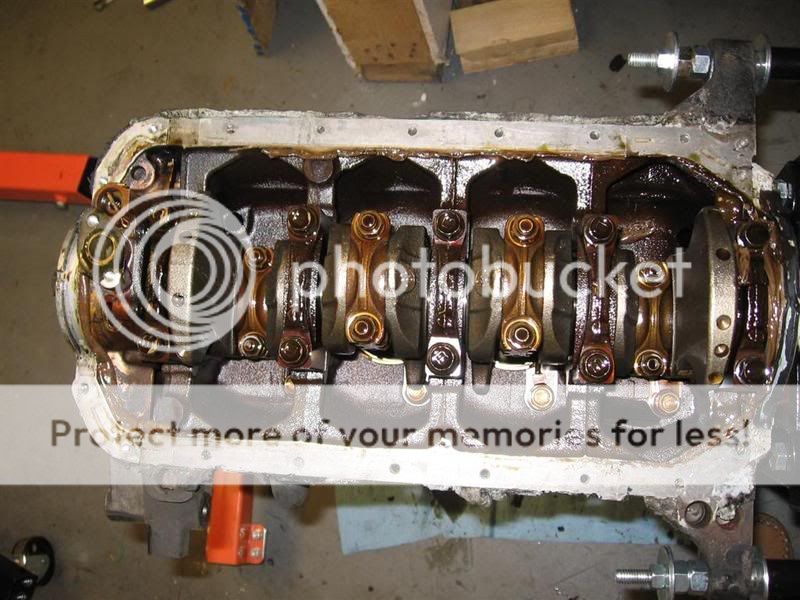

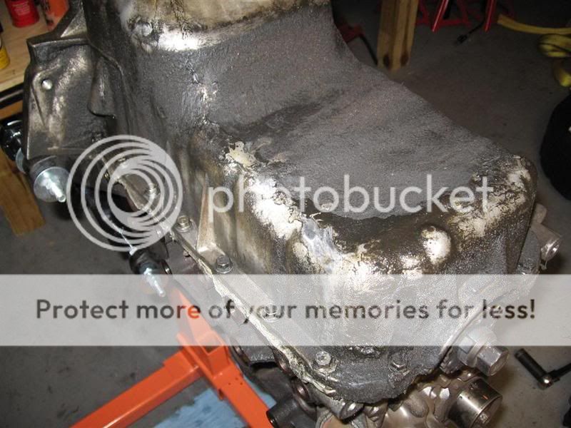

FWIW, it looks like the oil pan has been off of this motor before, which raises an eyebrow, but I can't really find anything terribly out of shape, so if there was a repair done, it seems like it was done well because I can't find it. The only think is that I removed about 5 lbs of RTV from the block from that.
I'm looking for a couple words of wisdom now though: Any thoughts on how to remove the front and rear 'plates' (the ones that hold the main oil seals)? I can't seem to figure out how to work them loose. I don't really want to start bashing stuff w/ a hammer b/c it's aluminum, so really, any advice is appreciated.

There is literally an ~1/8" layer of grime on the bottom of the oil pan. Nasty s***.

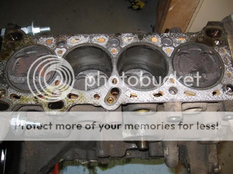

Pics 'inside the head'
Various stages of disassembly:

if you bore the cylinders, how will you get pistons to fit properly w/o piston slap?
what is the brown stuff that look like wood filler in the holes that I assume are coolant passages on the top of the block?
lol the holes are actually there. That's the color that old coolant apparently turns when it dries up. All the coolant passages are that light brown color for some reason. And yes, I'll need m0ar piston for the overbore ;)
