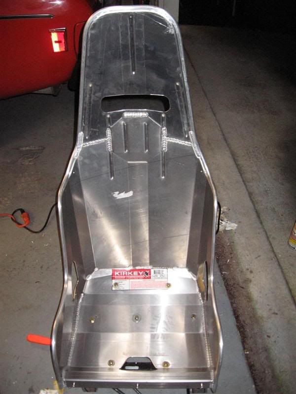

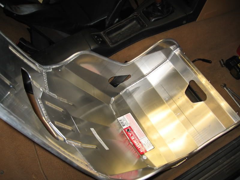

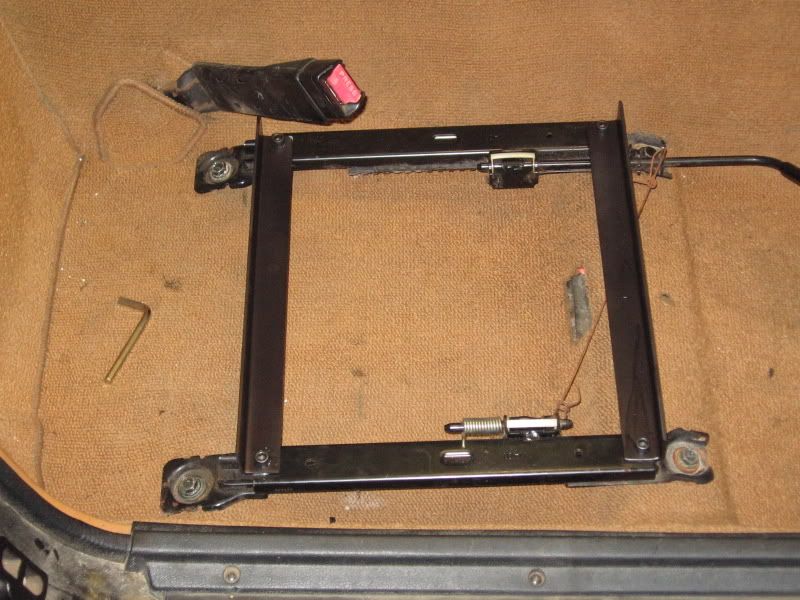

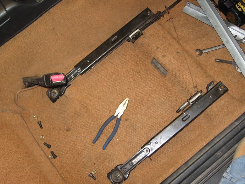

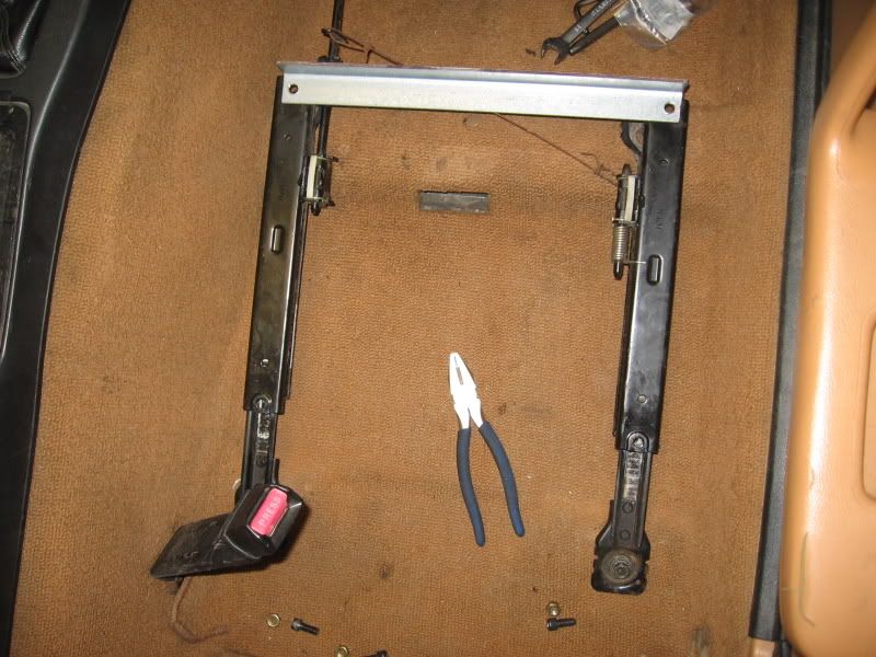

Well, I kinda sorta caught a break tonight and had some time to do a little more work with the seats. The passenger side to be a little more specific. I must have lost my stock passenger side bracket when I moved, because I couldn't find that thing anywhere. I picked one up from a local miata-graveyard type yesterday and went to town tonight. Putting together the seat bracket is pretty simple and just requires drilling 4 holes in the angle iron. Make sure you measure correctly as with the 2nd one I was just a hair off. The dremmel made short work of correcting that error.
Pics:
The bracket as it sits stock. I just used the 4 stock holes at the ends of the top 'rails' for the brackets
Painted:

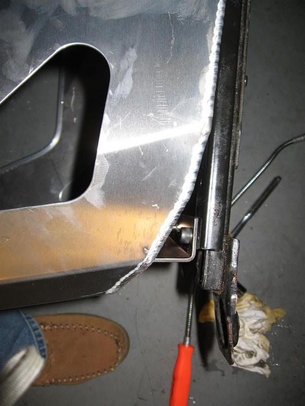

You can see the front angle iron through the anti-sub strap hole. It lines up pretty much perfectly with that front crease. The rear of the seat sits nicely on the rear bracket for support.

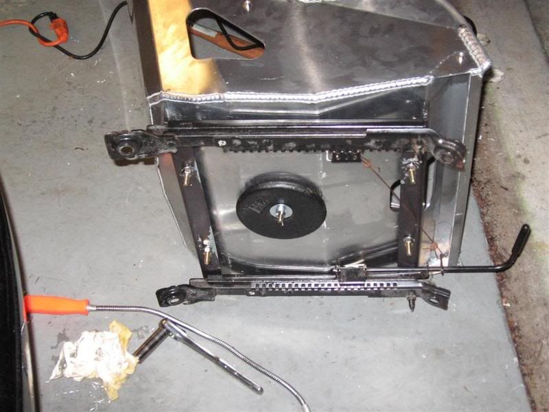

so I finally got that postage scale to weight some stuff, and we got the other seat bolted in tonight. Pics of that to come.
Weights:
- 50 lbs - Roll bar + mounting hardware
- 30 lbs x 2 - Forzas & bracketry
+ 25.4 lbs x 2 - Ballasted Kirkey
-59.2 lbs
So I overshot my estimate based on the weight that Mark from Kirk racing gave me on the roll bar. In either case, that's still a fairly significant weight savings :D. Now for the power steering and battery ;)

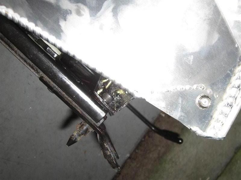

Here's a few pictures of the install:
Rear of the seat. The angle iron is butted right up on the bottom of the seat here:
Front of the seat. Angle iron again providing support:
Securely mounted ballast (2.5 lbs + hardware) (Todd, this answers your earlier question):

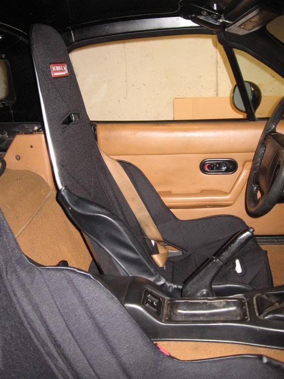

Mounting complete. The outer middle row bolts are threaded directly into the stock slider:
Installed :D:
A few numbers:
The stock bracket w/ angle iron bolted in was 7.85 lbs. The 'Naked' Kirkey is 12.15 lbs. Once the seat is bolted down (6 bolts, assorted washers, nuts, etc) and the cover's on, the whole thing (including the mounting bolts to the chassis) weighs 22.95 lbs. We added that 2.5 lb weight to the bottom to bring the whole shebang to 25.4 lbs.
Any questions? :p

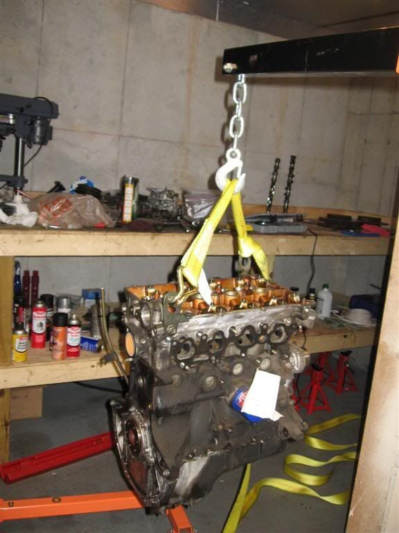

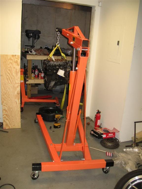

I bought an engine a couple months back, but really haven't had time to do much on it. I have torn the head apart and will start rebuilding the hydraulic lifters here at some point. I borrowed a hoist to get it off the crate on the floor to drain the oil, and to get it onto the engine stand (totally worth the hassle of going to pick up and re-building the hoist in the garage). After this I'll start tearing everything apart and see what kind of situation I'm looking at. I'll probably have everything acid dipped so I can start 100% fresh and not have to worry about a buttload of contaminants.
FWIW, this will be my 1st rebuild, so I'm really stoked, so there will likely be a s*** ton of pictures of that process once we begin. For now, you'll have to settle with this :p

Pictures of the head, or do you mean pics of the block w/ the head off? Right now I hand-tightened 4 head studs so I could use those hooks to hang it from the hoist. I SHOULD have it on the stand tonight.
