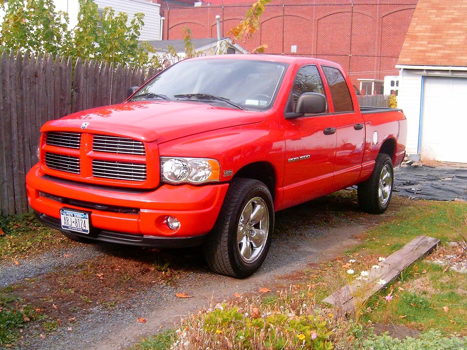

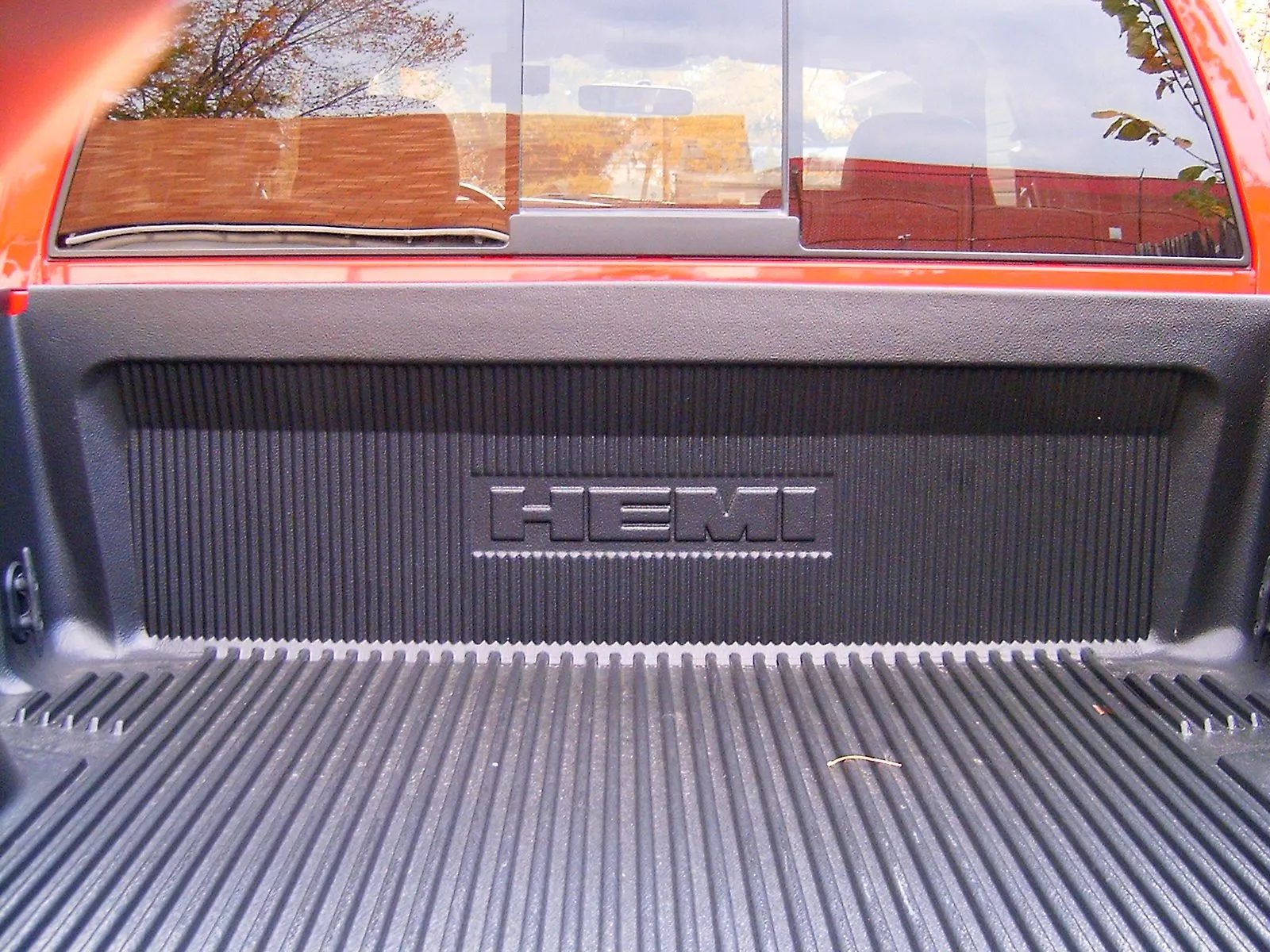

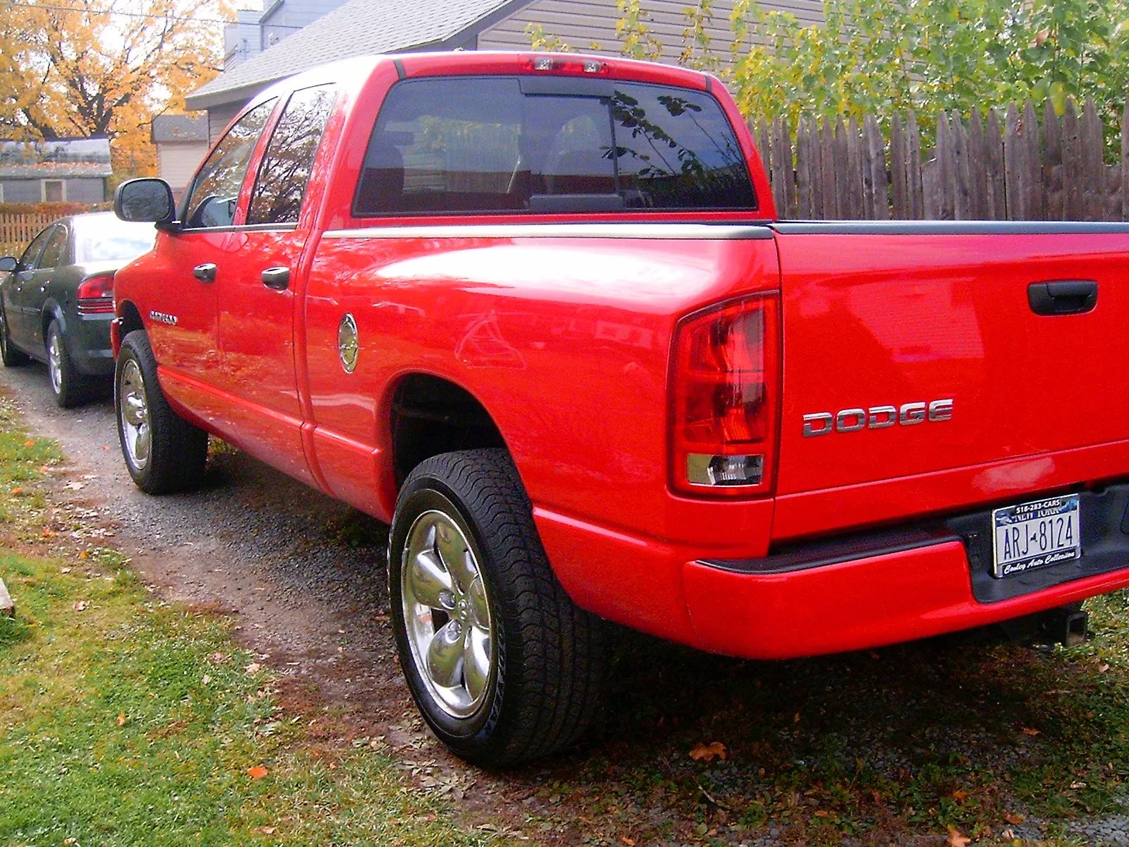

Well first off, this is what I replaced the Protege with...
Hemi, 4wd, leather interior, power seats, heated seats, 20's, billet grille, 6disc in dash changer, towing package, etc. etc.

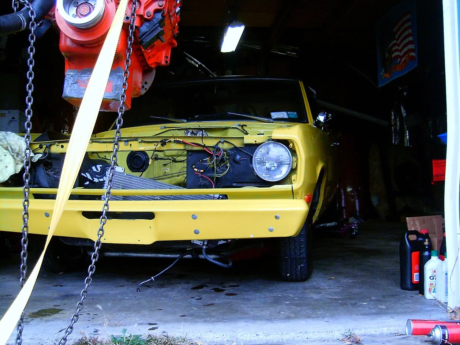

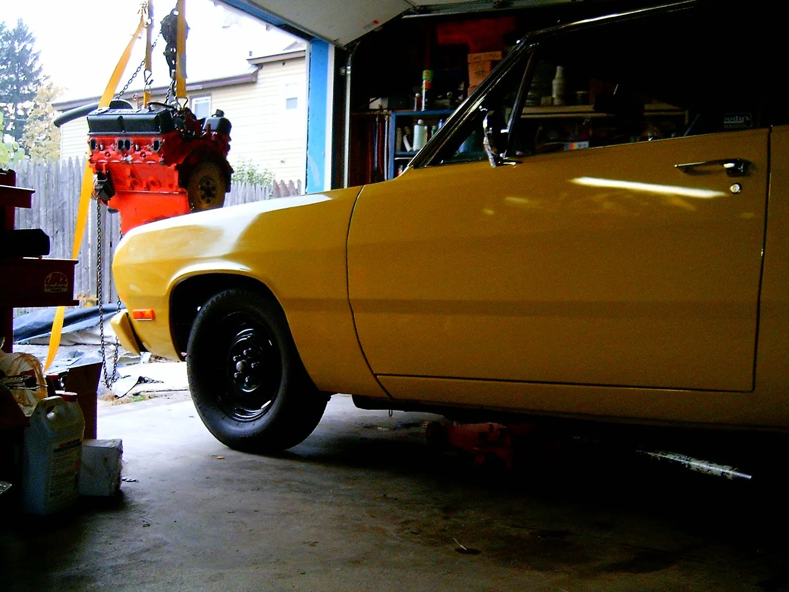

Here are a few shots of the old motor coming out. I am replacing pretty much all of the front suspension with new and upgraded parts. Also adding re-enforced welds and plates to stiffen it up even more. Thats how low I want to get it to sit when complete but with 17's.

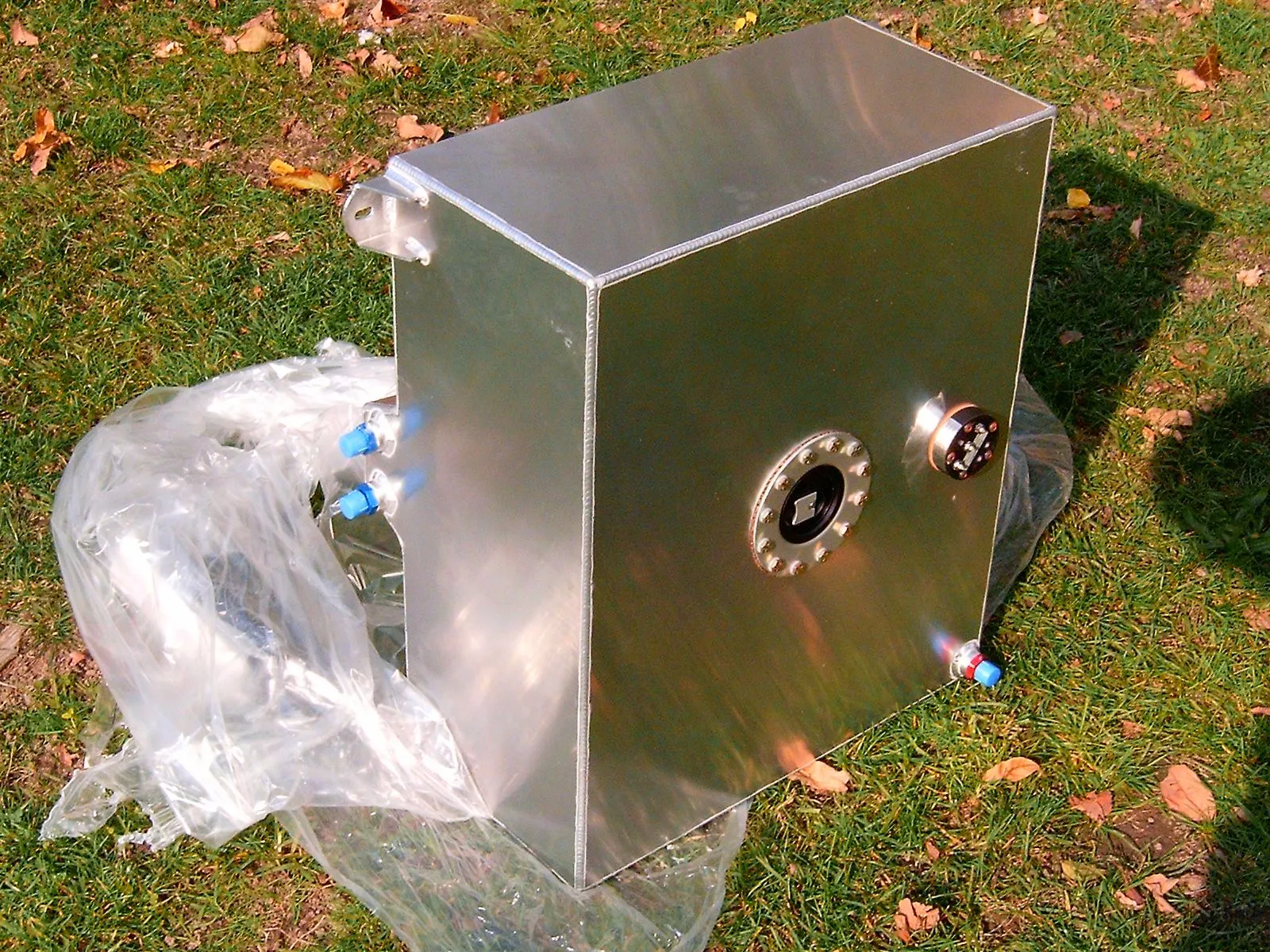

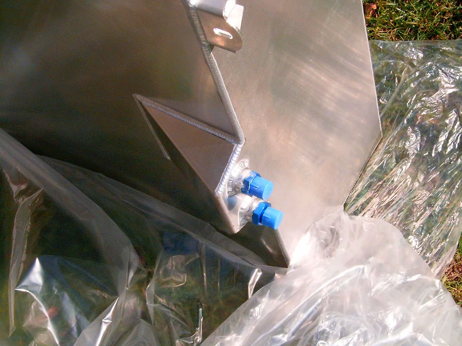

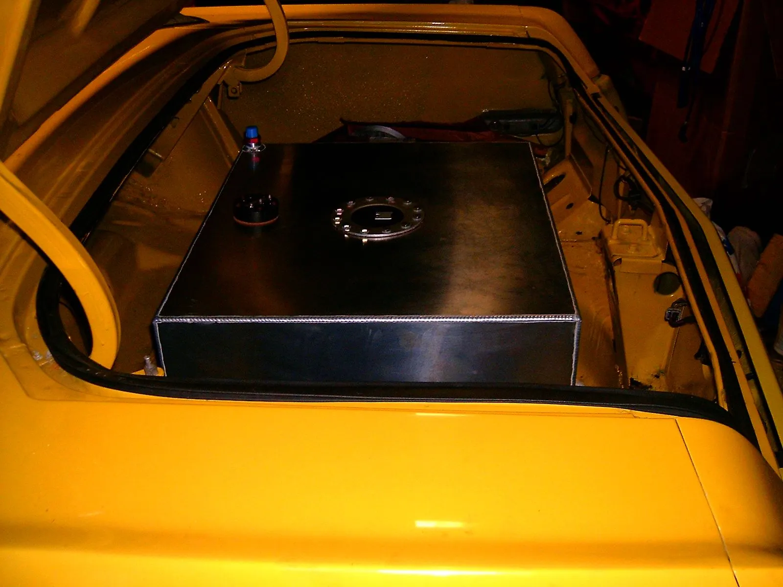

15gallon al. Fuel cell with sending unit so I don't lose the gauge.

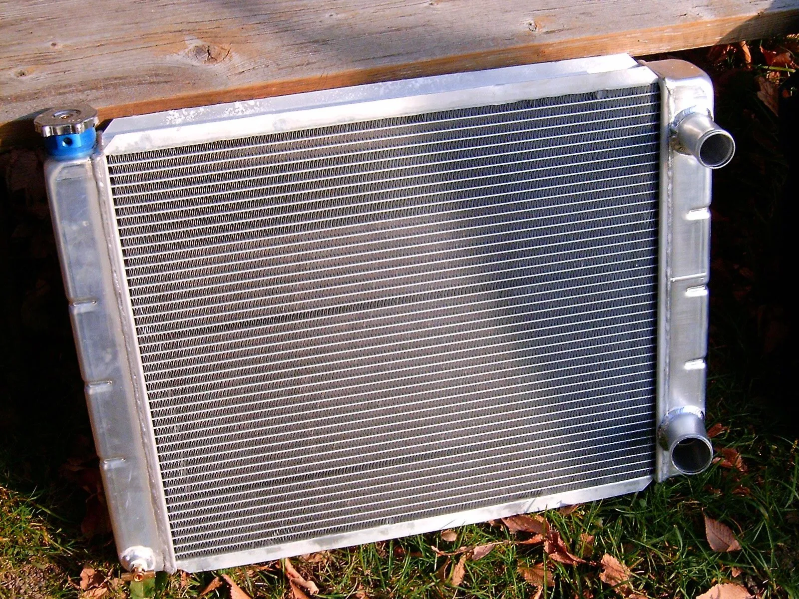

Big al. 2row double pass radiator with enough cooling capacity for 1000hp.

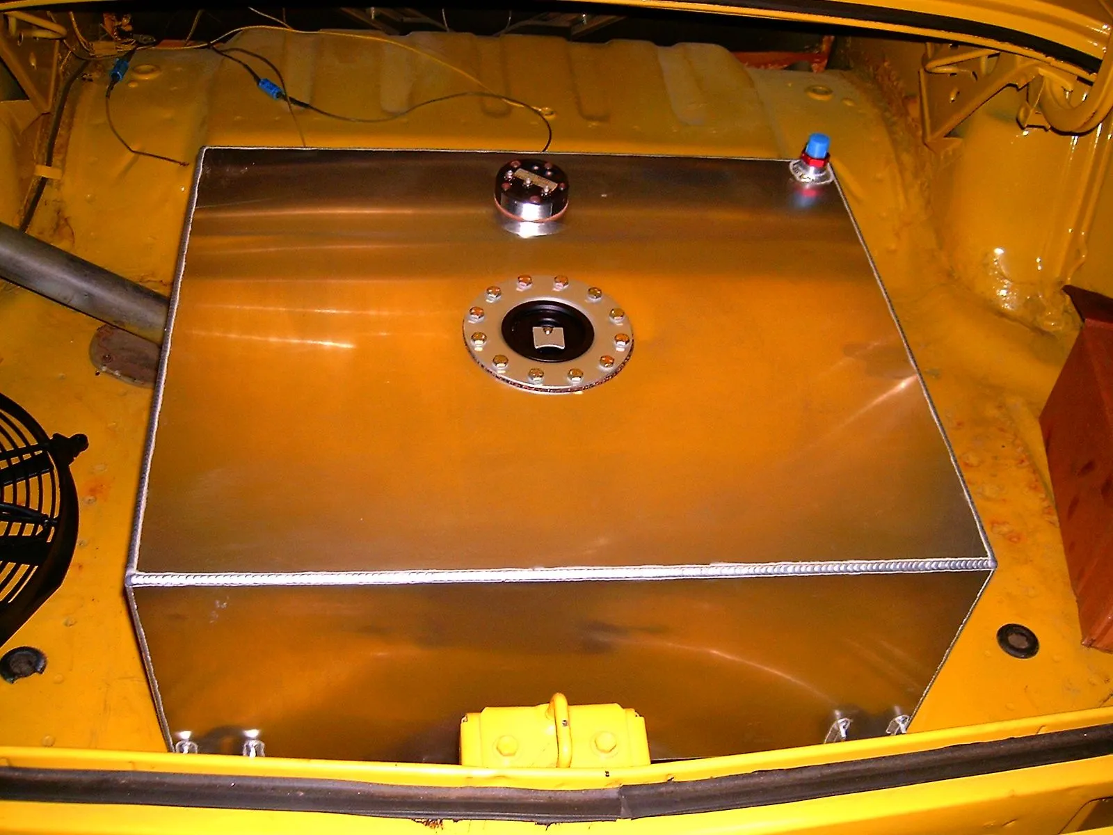

Fuel cell mock up. I have to wait till the roll bar goes in before I final mount it. The trunk used to be big, with the fuel cell, a 5gallon water methanol tank, and the battery there isn't going to be much room.

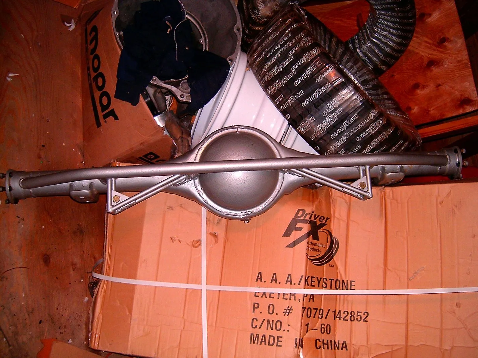

My fully braced 8 3/4 rear end. I was going to go with a dana 60 but this is much lighter and should be okay. Hopefully...

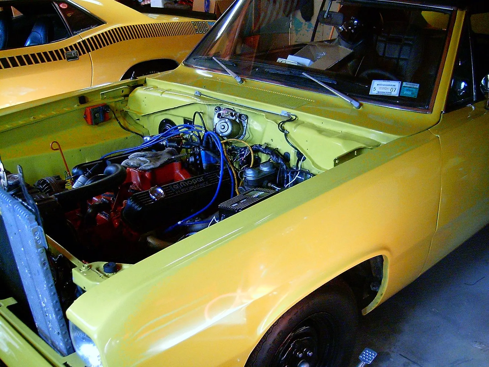

It's an original AAR cuda. 340 Six Pack. If you have ever heard of F.A.S.T. racing, thats what it does for now. Has to look completely stock, sound stock and run the factory Polyglass tires. Currently it runs mid 12's, but it is getting a bigger and badder motor this winter. Hoping for 11.4's or so.

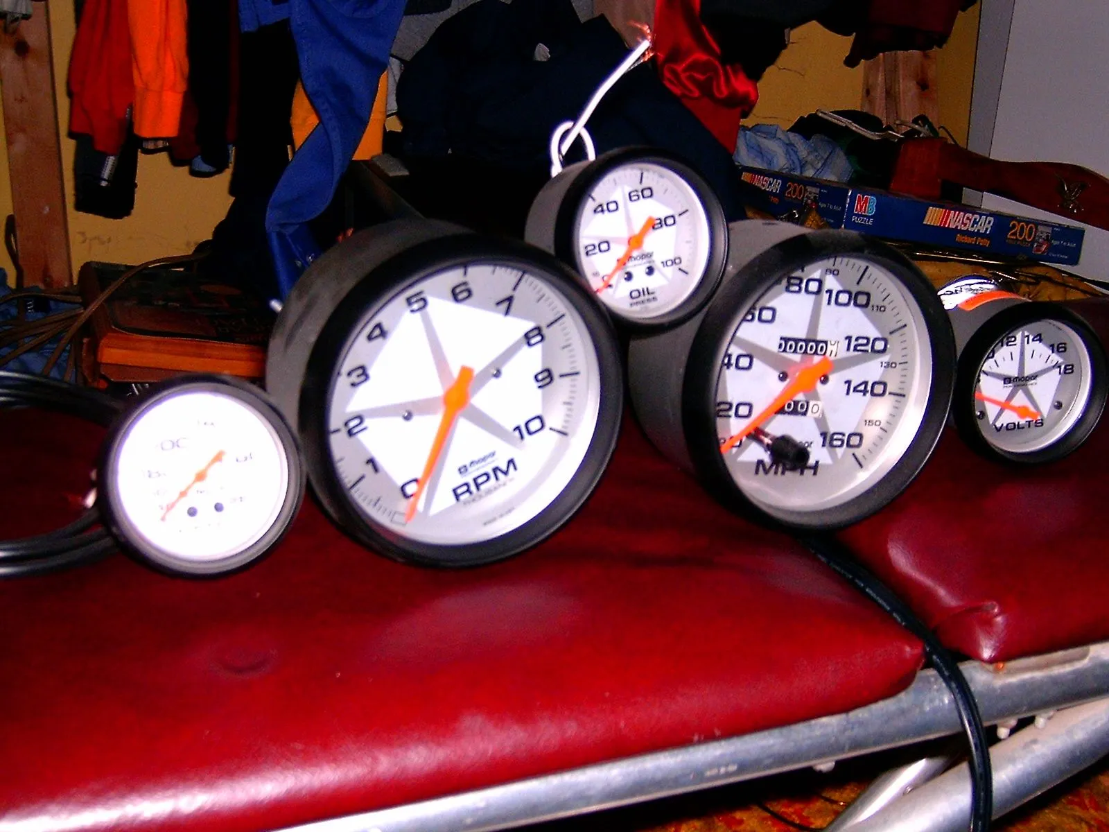

Got the complete gauge set from Mopar. Yes that is the penestar in the gauge faces..

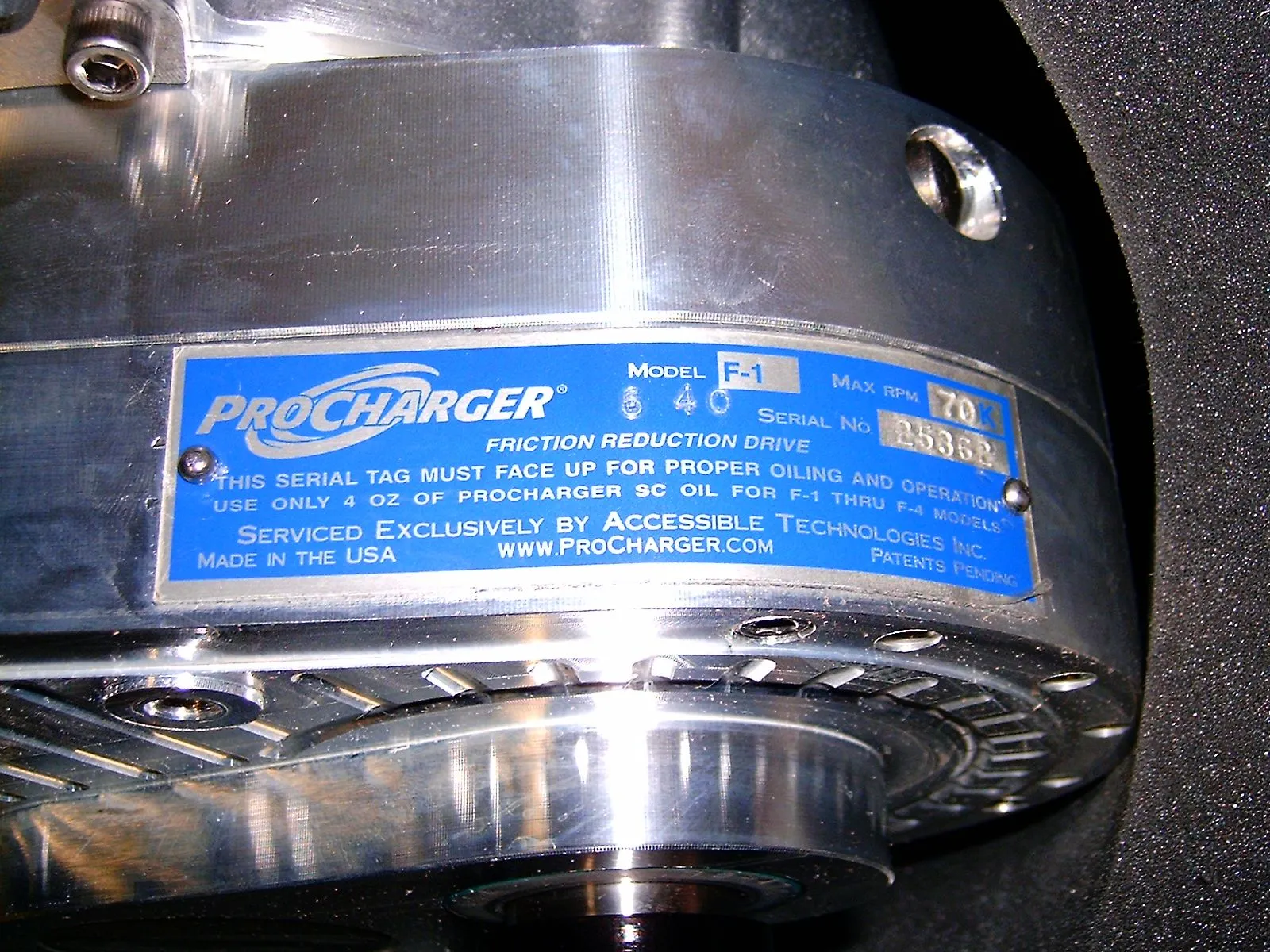

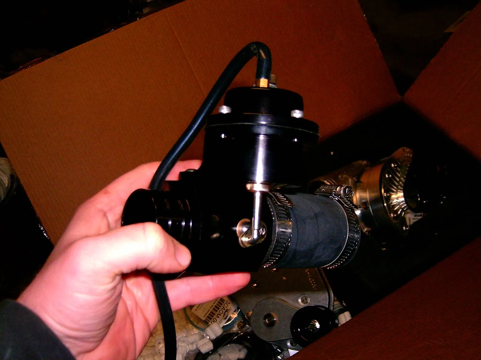

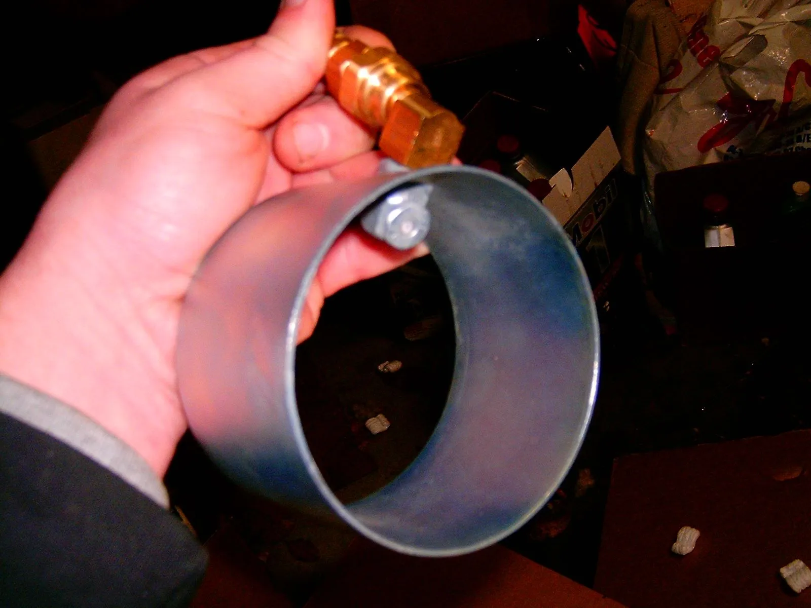

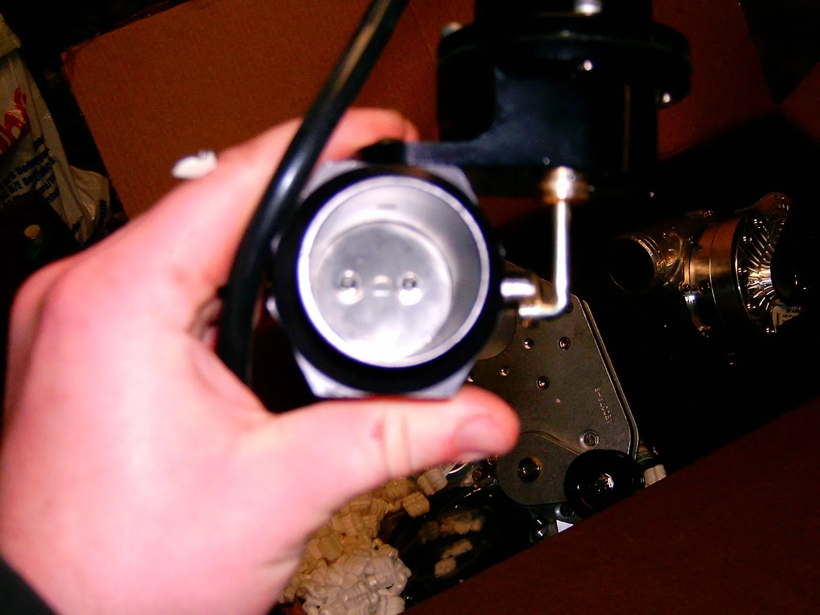

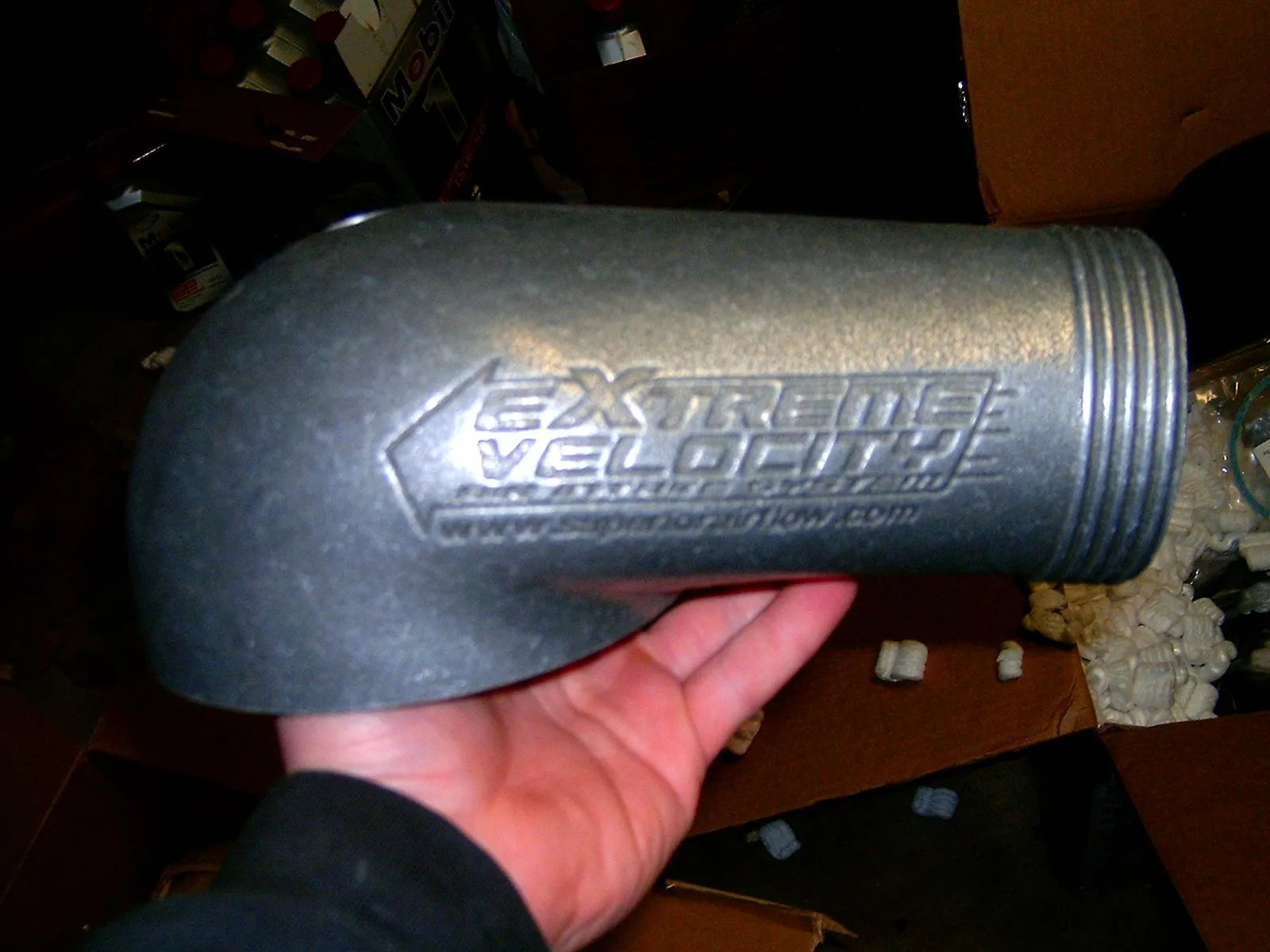

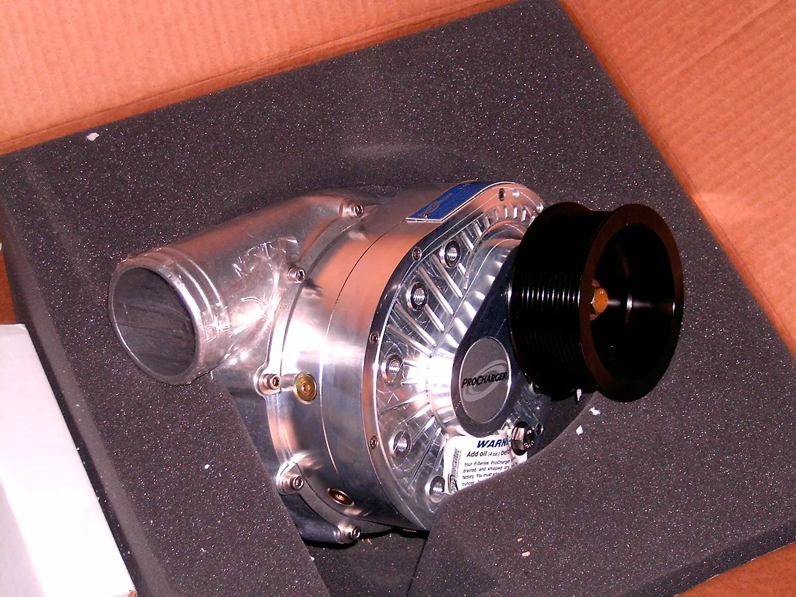

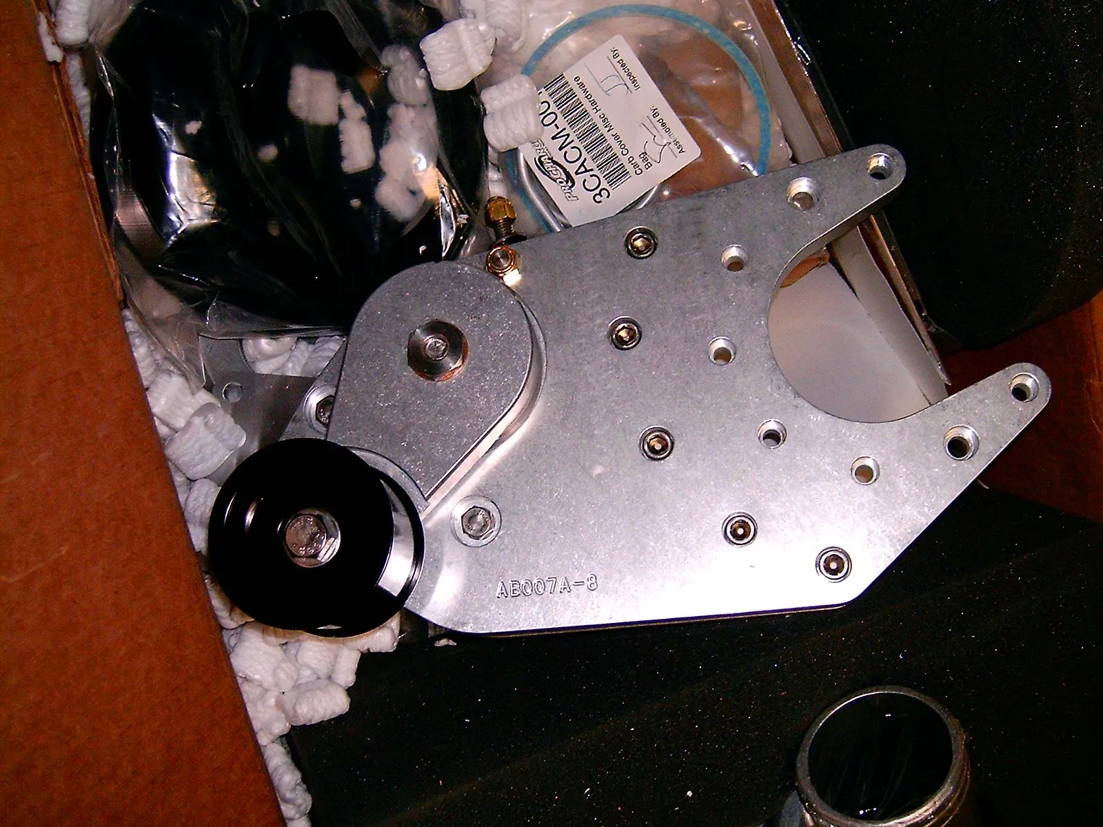

The supercharger came in finally. A F-1 Procharger, some of the brackets, tensioner, big ass blow off valve, water injection nozzle, etc. etc. etc.
5 boxes in all with all the brackets, bolts, pullies, spacers, relays, wiring, switches, etc. etc. etc.
Oh happy days.

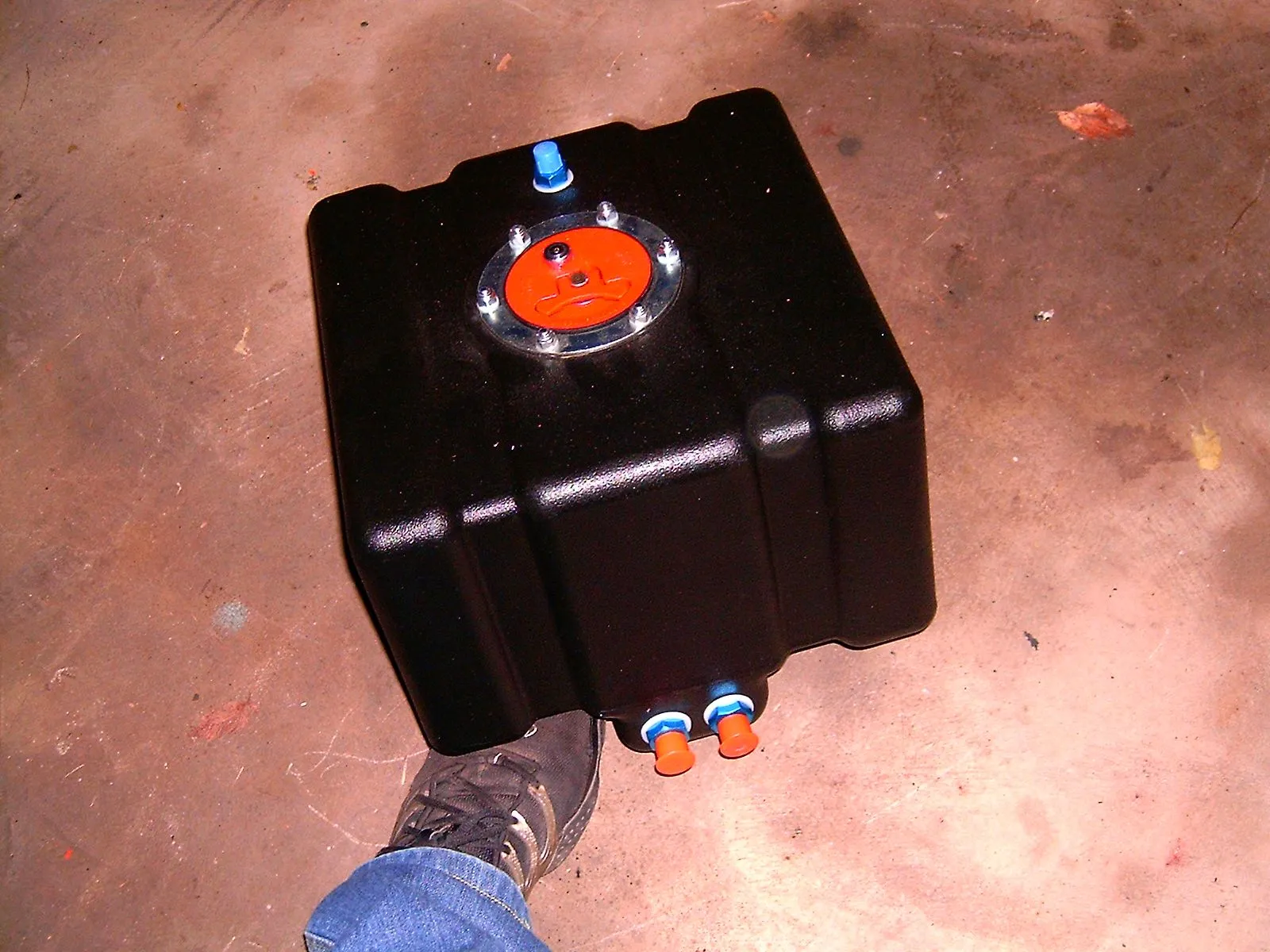

5 gallon cell for the water/methanol injection... etc.
