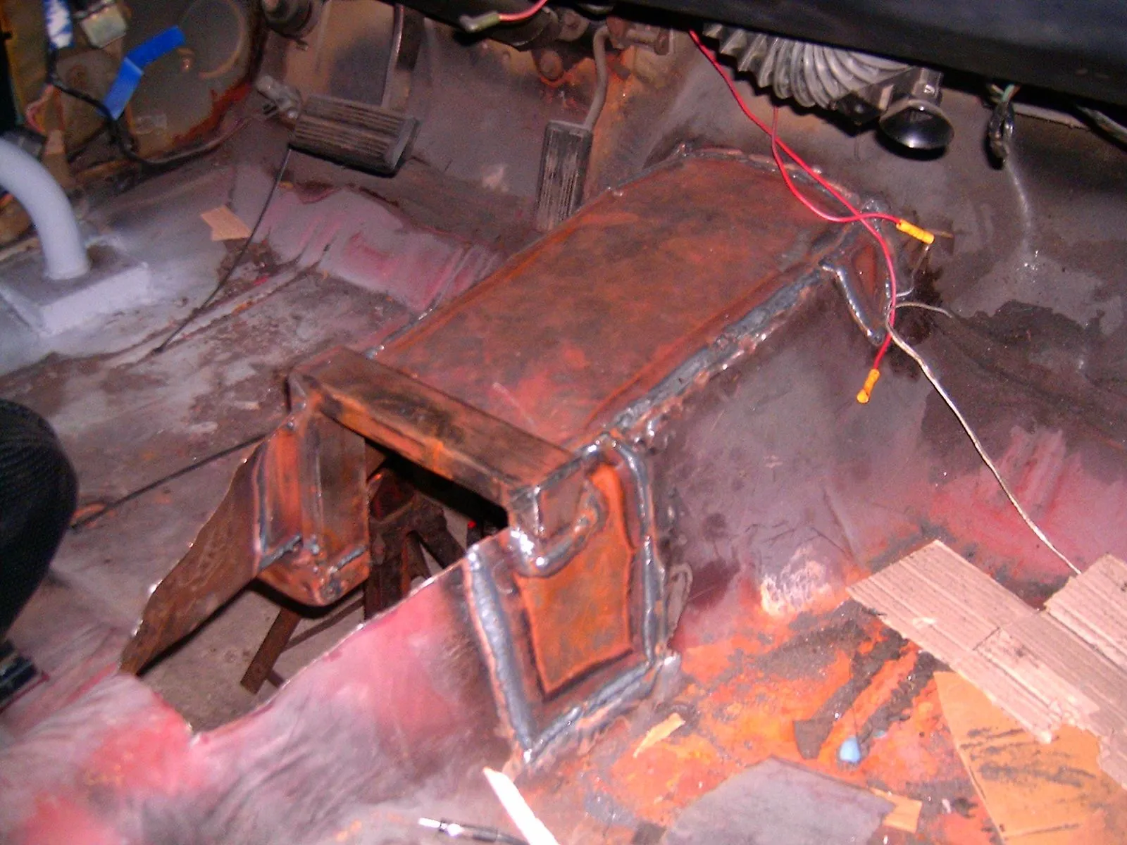

The wheel tubs are moved in to the frame. I have to cut the floor out to put the tremec in, after that the Dana goes in, then the bottom gets fully stripped and painted, then the front suspension goes in, brakes, order the wheels, then wait for the engine.

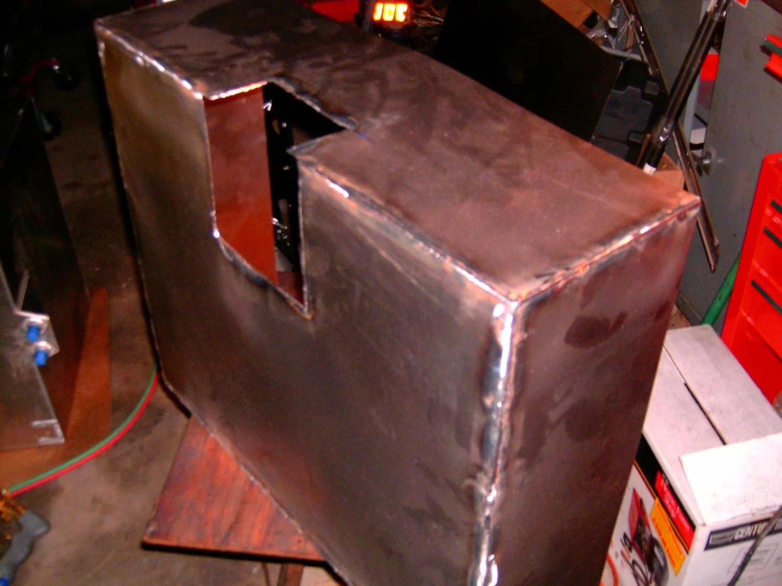

Almost all the fabrication is done!!

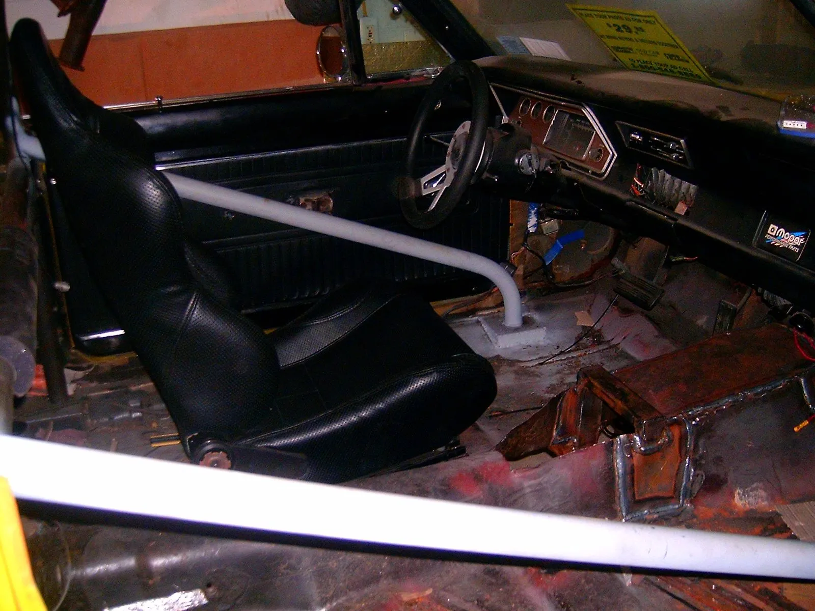

I finally have seats!!

Both seats have mounts. and have been mounted in the car. I am def. regretting the rollbar guy talking me out of the swing-out bars for the doors. There is no way I can gain weight because I won't be able to get in or out of the car. lol

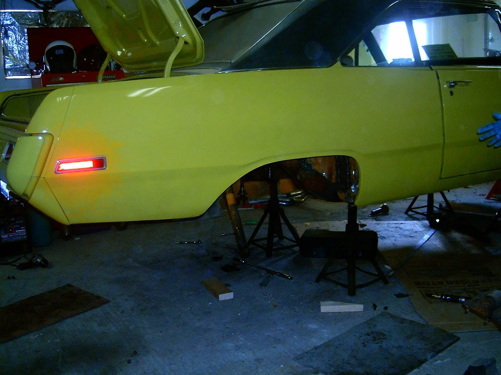

Well I mocked the rear wheels and tires today. They fill the well pretty good. Got the measurements for the rear axle and will order that tommorow.
