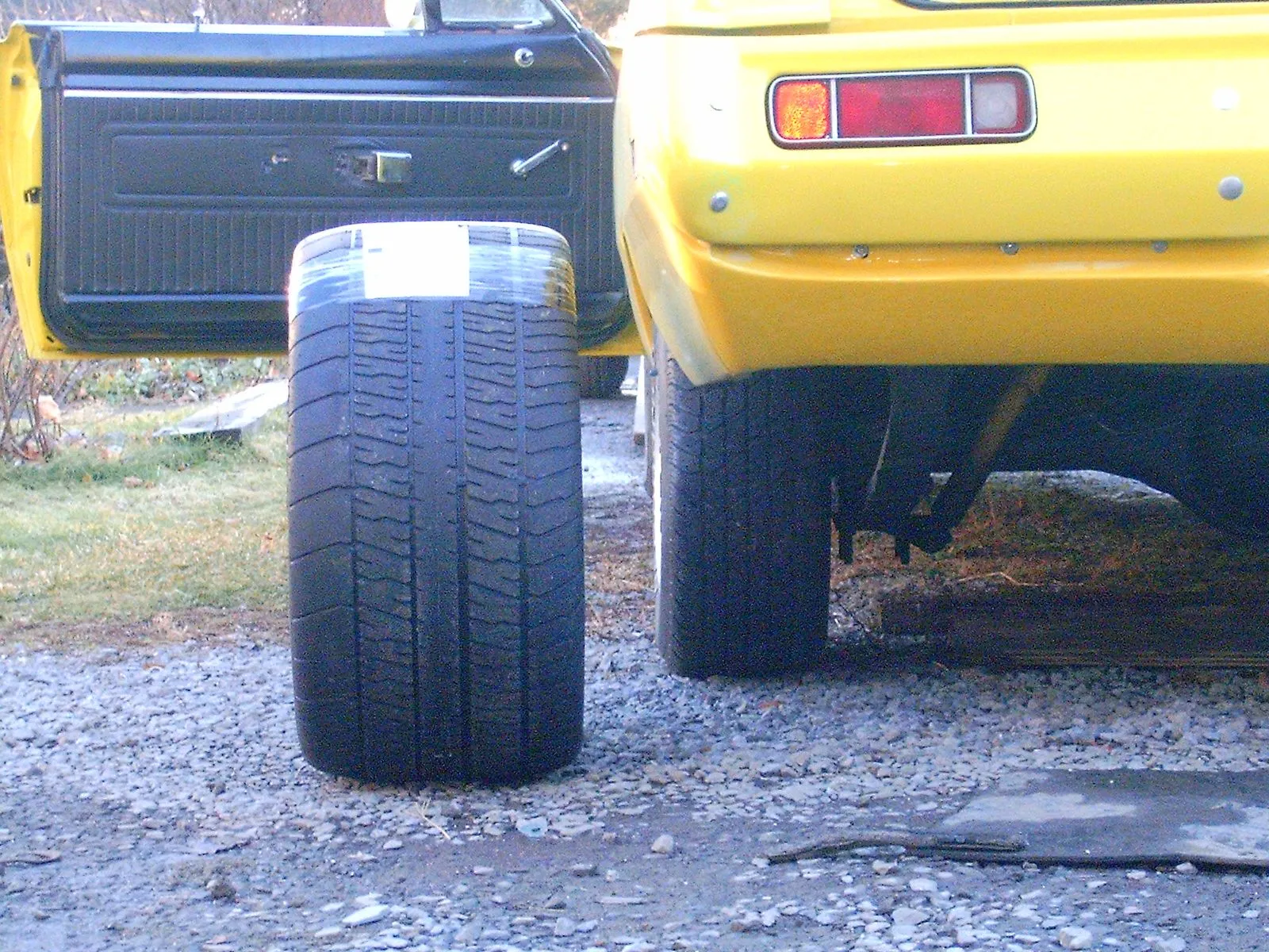

Also got the tires, 255/40/17's Gforces for the front and 315/35/17's Grforce Drag radials for the rear.

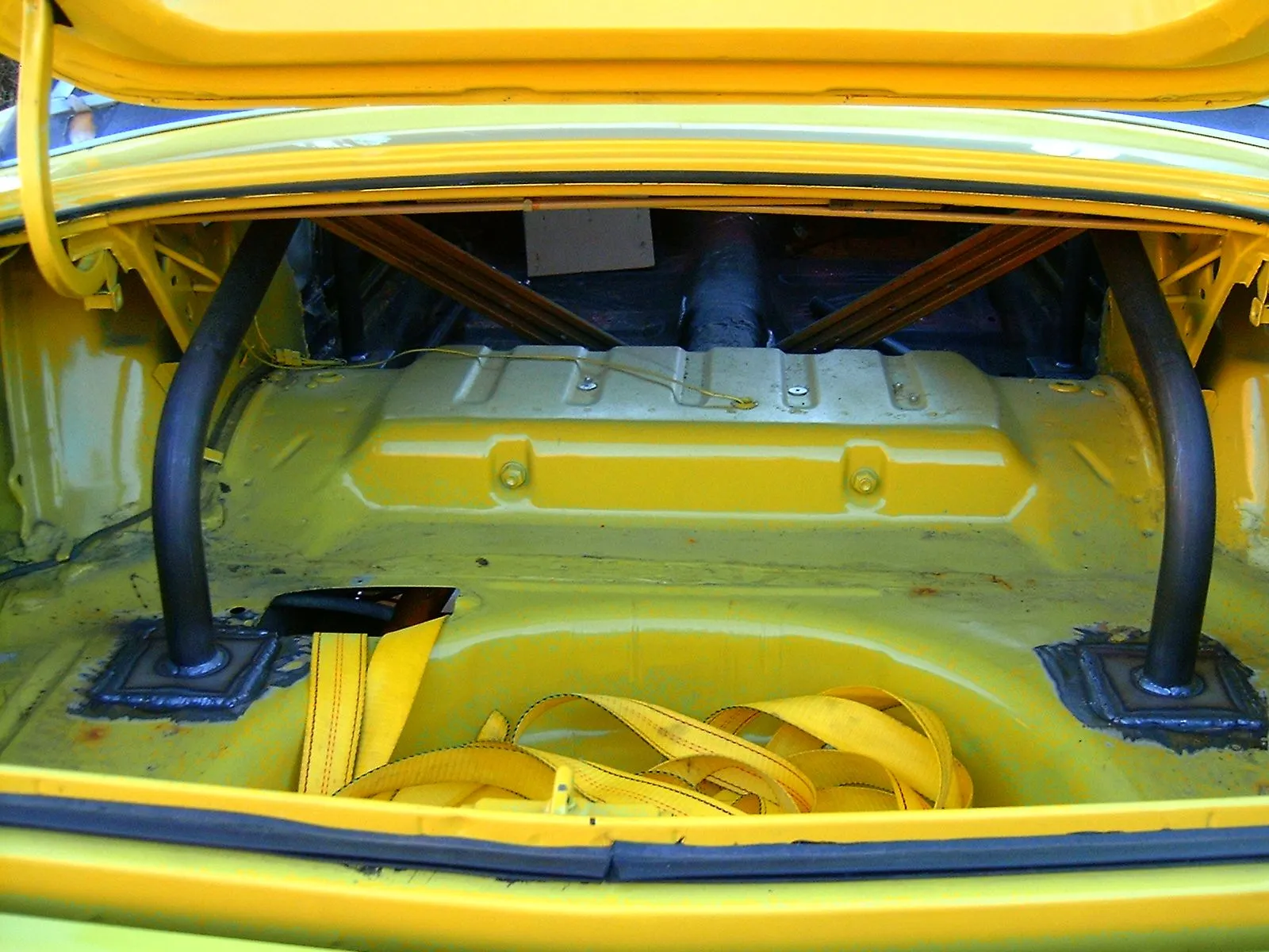

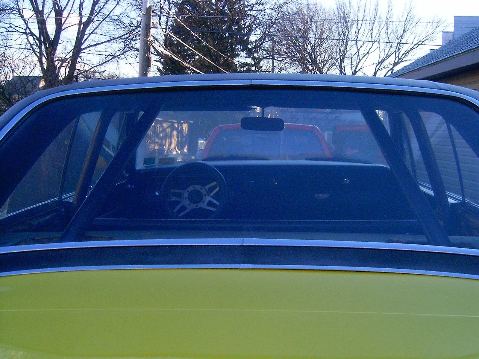

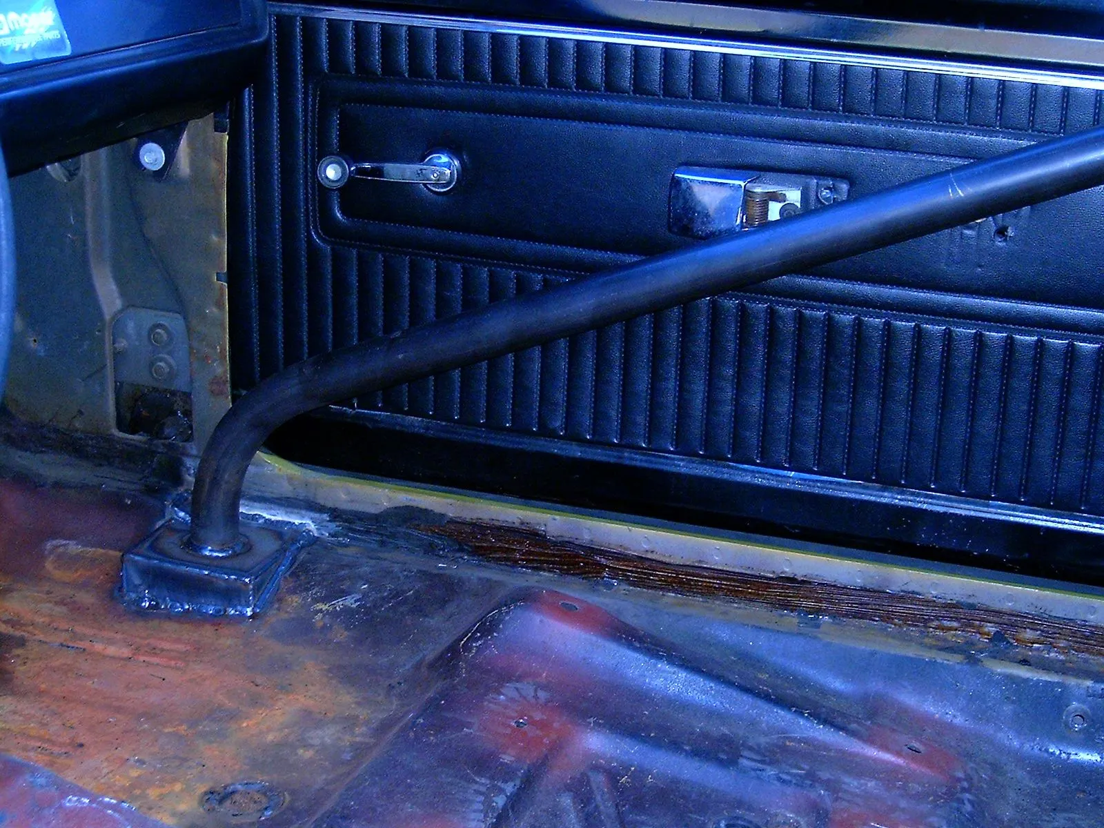

Well I got the car back. ABS chassis is the place you want to go for a roll bar. This guy does awsome work, and quite quickly too.
Here's some shots.

Here's the tires I am going to be running. 315/35/17's. Kinda make the 235's look pretty puny.
(wow) Those tires are monstrous! Progress looks great, I'm a sucker for those old muslecars. Keep the updates, pictures and video coming - I have to live vicariously through people like you. :D

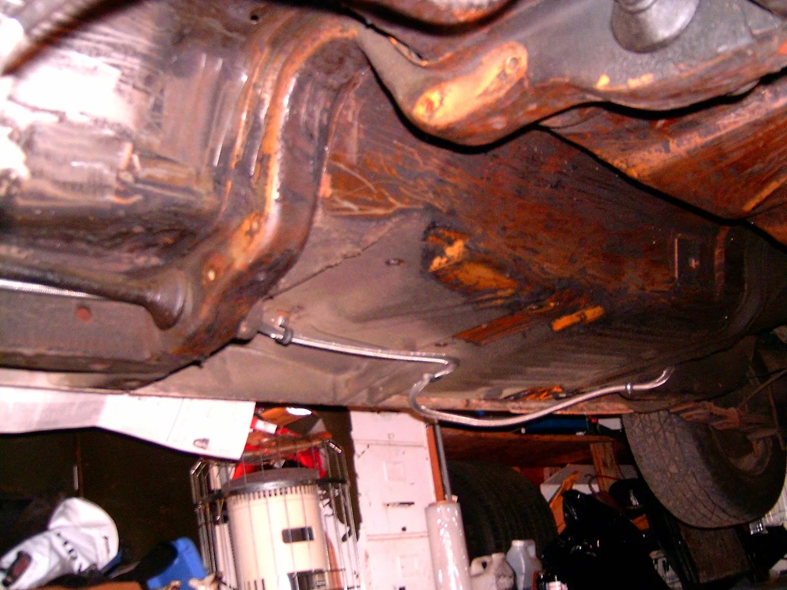

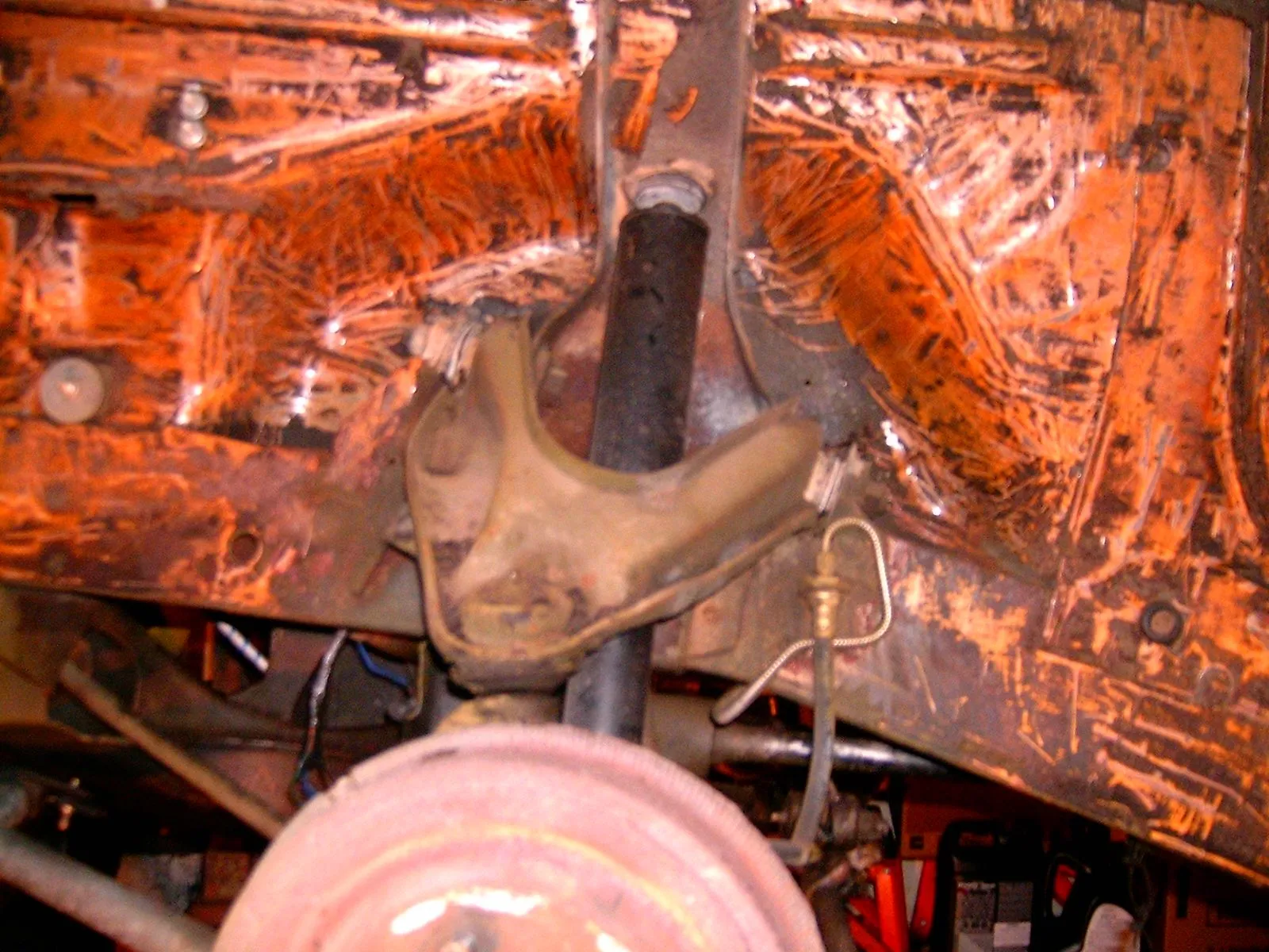

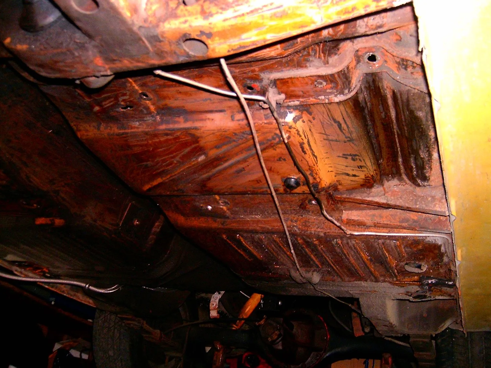

Couple more updates...

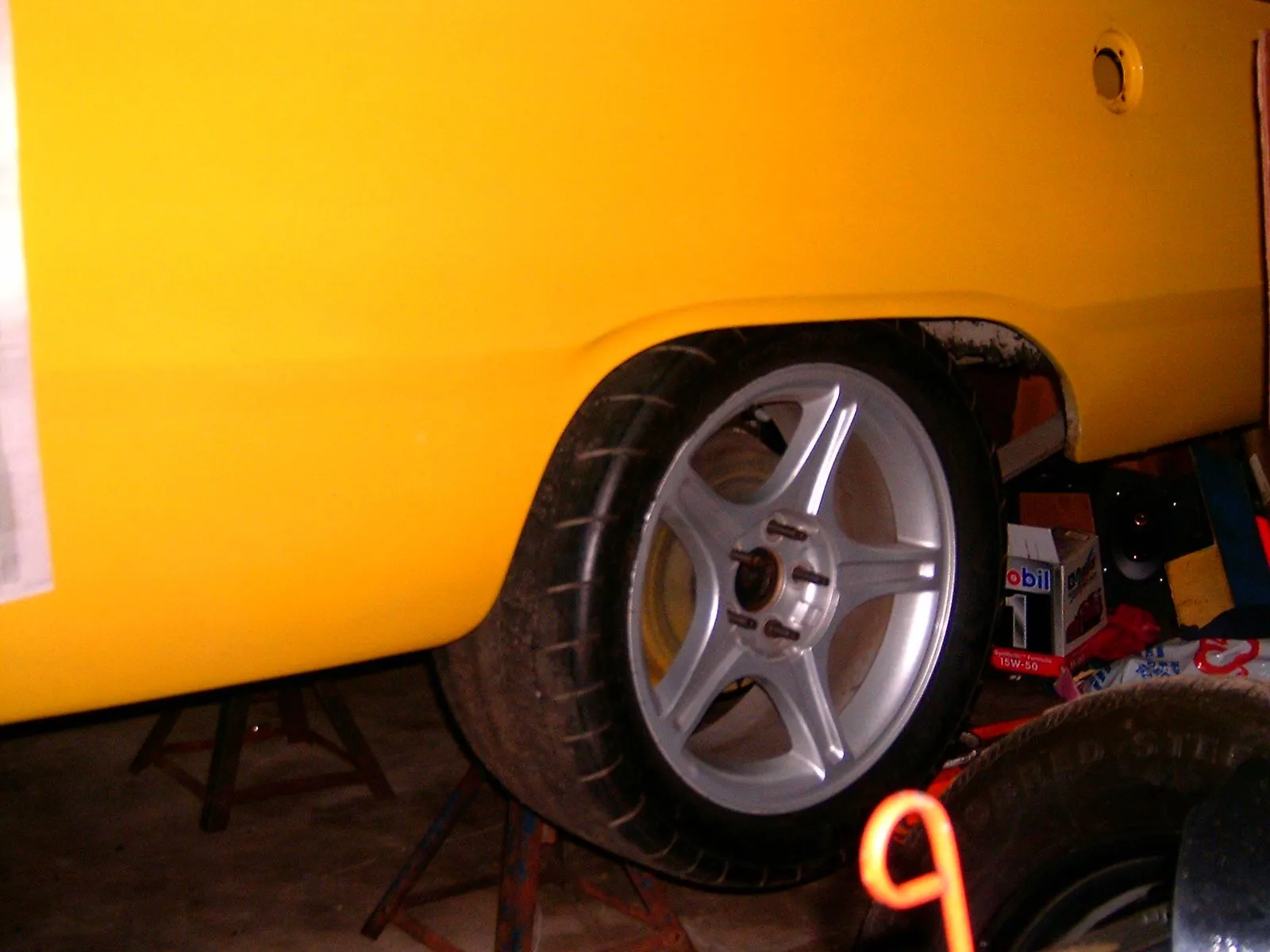

17" wheels I borrowed to see what backspacing I would need to make the monsters fit.

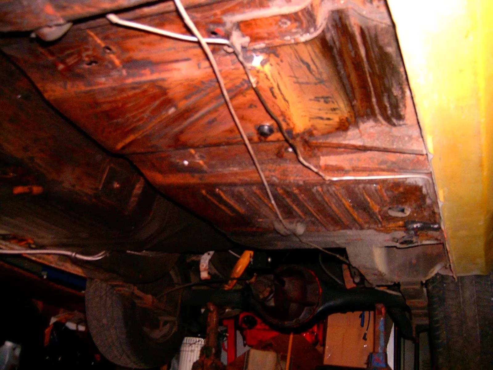

Started the ambitious project of scraping all the undercoating off the bottom. Propane torch and a gasket scraper, oh what fun.

Dunno about those welds on the rollbar though...they look like my welds...(where it's welded to the floor only)
Yeah, the guy tig's only. That front right box got alittle hot and he welded over it. He did install it in a pretty neat way though. He ran the tube to the frame and welded it, then made the box around it and welded that too the floor. It makes it alot stronger being a uni-body car.
yo,as far as the under coating,-----dry ice,and a chisel.
I have done it a dozen times in underbodies,and inside sound deadening.
Ah,(rockon)
