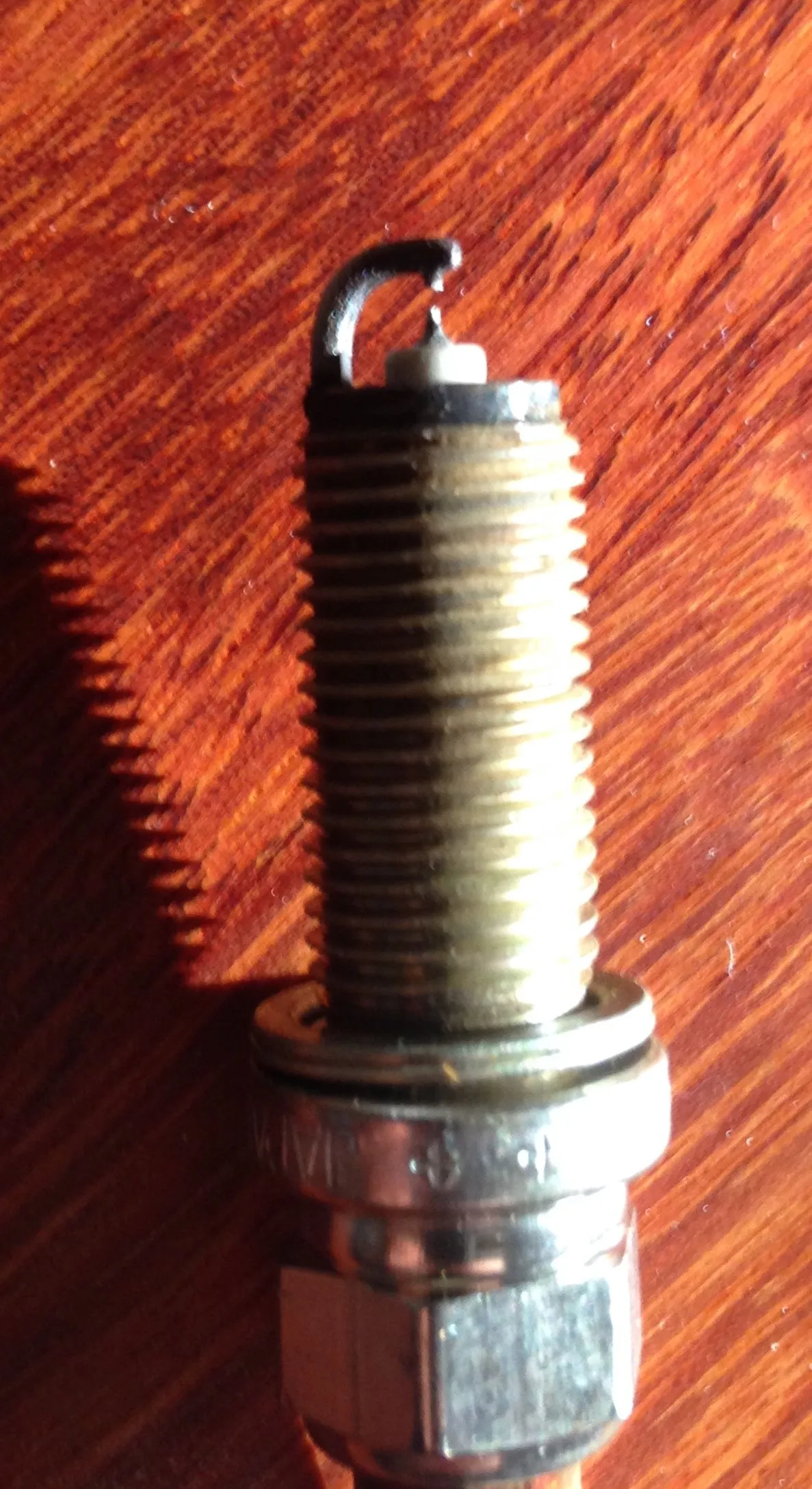

I just replaced my spark plugs on my car. I went to a parts house and purchased the NGK ILKAR7L11. I put them in and it seems to be running fine. But the plugs do look different from the ones I took out. It looks normal and you have an electrode coming out of the spark plug. But you also have a bump on the ground electrode. The new ones don't have that. Has anyone purchased them from Mazda and received an exact match.

Ive been mending cars for the best part of 45 years and dont have any trouble spotting iridium plugs. The shape of the ground electrode isnt important, its the shape of the electrode that indicates whether it is an iridium plug. In the attached file, the bit that seems to cause you concern has been flattened to the ground electrode but its still there and for that reason the plugs in the OP s photo are correct and so are the OEM plugs in 52s photo.
The pic is the spark plug that came out of the car. So looks like the new spark plug does not have the platinum tip. Or least its flat. I don't want to completely waste my $50 on these plugs. So next year I will go to dealer.
You have the correct plugs. It will be fine.

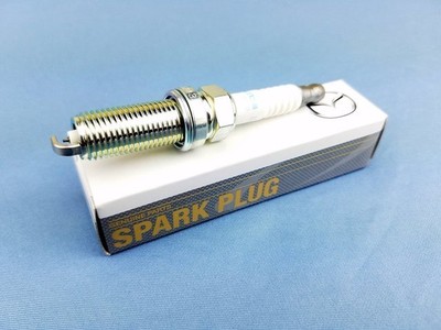

......and this is a photo of an online supplier for the OEM plugs. The NGK number that the OP used is right beside it on the same box. Save your money and buy the exact equivalent if you can be sure of the quality. The same applies to filters and oil and wipers etc.
The part number on the spark plug that came out of the car says PE02 18110
That’s on early versions. I think 2012-2014. After that they changed the spark plugs with increased gap. Anchorman’s part number is for latest models I reckon. I have two different workshop manuals, one is for 2012-, the other is 2012-2014 and on both there is PE01/PE02 as part number. On mcx5 online manual both PE02 and PE5R or PE5S
All the plugs versions for these engines end 18-110. The early versions - PE-01 and PE-02 have been superseded by later interchangeable versions PE-5S and PE-5R.
The only difference then is who made them PE-01 and the later PE-5R are made by NGK. PE-02 and the later PE-5S are made by Denso. Mazda no longer supply PE-01 or PE-02 although you might find old stock on ebay.
To help reassure you, I’ve attached a screenshot from the online LIVE parts list - this is current as of now. If I try to select either PE-01 or PE-02 it comes up with a supersession box. In this screenshot you can see all these part numbers including the associated manufacturers plug and you can see that our OP has indeed got the correct plug. He could have bought Denso FC20HPR8 and he would still be correct. He’s basically taken the early Denso plug out and put the later NGK plug in - thats absolutely OK. So let me show it another way;
Original version PE-01-18-110 (was NGK DILKAR7F8) is now PE-5R-18-110 (NGK ILKAR7L11)
Original version PE-02-18-110 (was Denso FC20HPR8) is now PE-5S-10-110 (Denso ZC20HPR11)
I would always fit the later version. All these modern iridium plugs are going to wider gaps to improve performance and in the later part numbers, both NGK and Denso show the factory set gap in the part number - so the last two digits - 11 equals 1.1mm. Here is that screen shot with the supersession;
