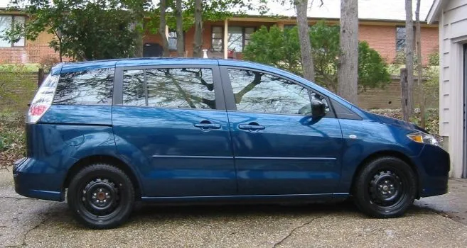

All year snow tire users?
Anyone keep their snow tires on year-round? My REVO1's performed well this season and I cannot stand the curb rash on my stock wheels.
