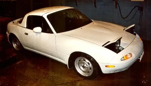

Behold the beauty of the steelies... (Looks like Susan is the same color so should give you a nice preview)
Okay.. so maybe they 'aint pretty, but I've had too many tire scrapes and curb altercations in the snow to put anything pretty on there.

Hey MRBWA1 thank you for the picture! That's exactly what I wanted to do, but when I called the 'Rack they only had 3 (16") wheels left in the system. I guess next year I'll be ready. I've always had steelies for the winter and it looks like they work fine on 5's.
