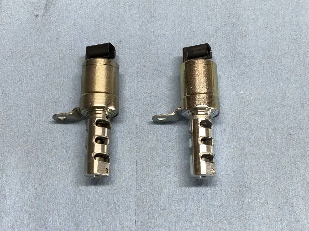

Does the OCV look like genuine Mazda part? A week is pretty fast shipped from UAE.
Other than the fact that it came in a Mazda parts box (and bag inside) with the usual OEM parts label, I don't really know how to check if it's a genuine part or not.
I guess you’ll find out when you replace the leaky OCV and can compare the two side by side.

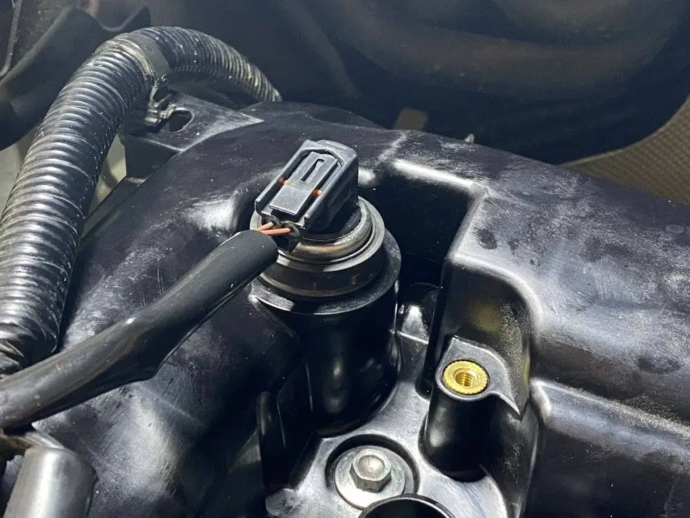

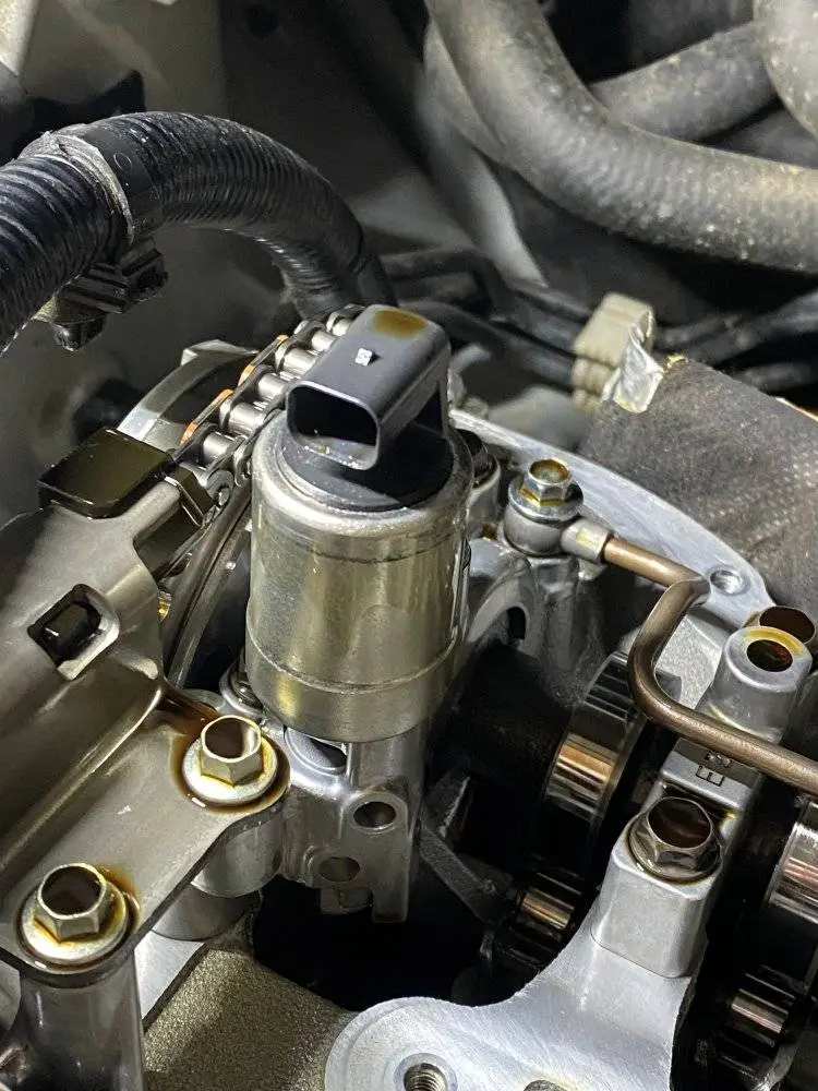

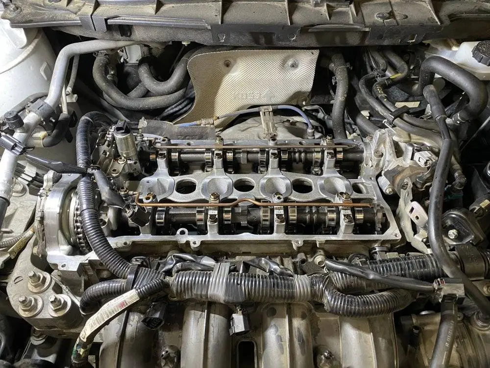

Alright! Finally got around to swapping the OCV in the head.

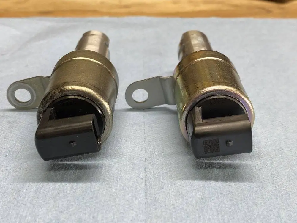

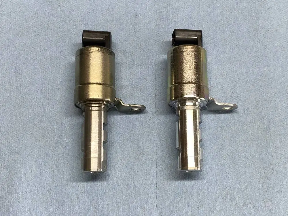

Comparing the two OCV's side by side, they appear identical in all marking, except the new one has a QR code just like other parts around the engine. Not sure why the old one doesn't have one. Checking it with my phone camera went right to the part number for this part. Old on left and new on right in all pics.

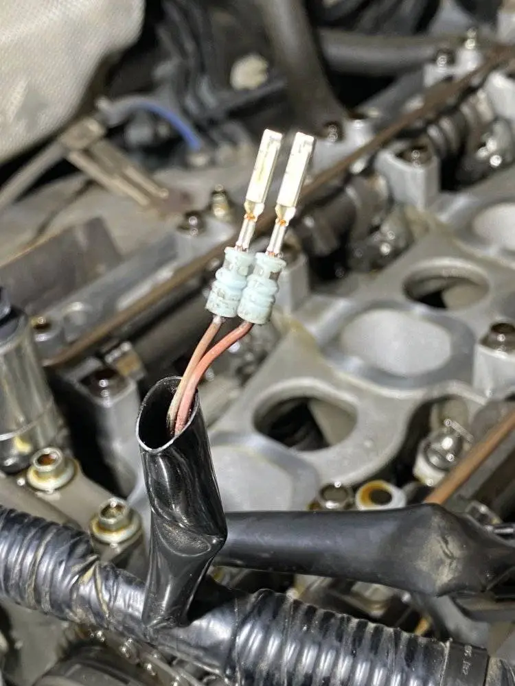

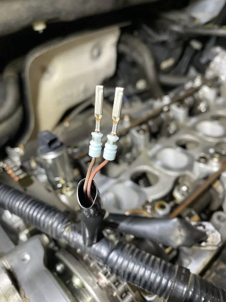

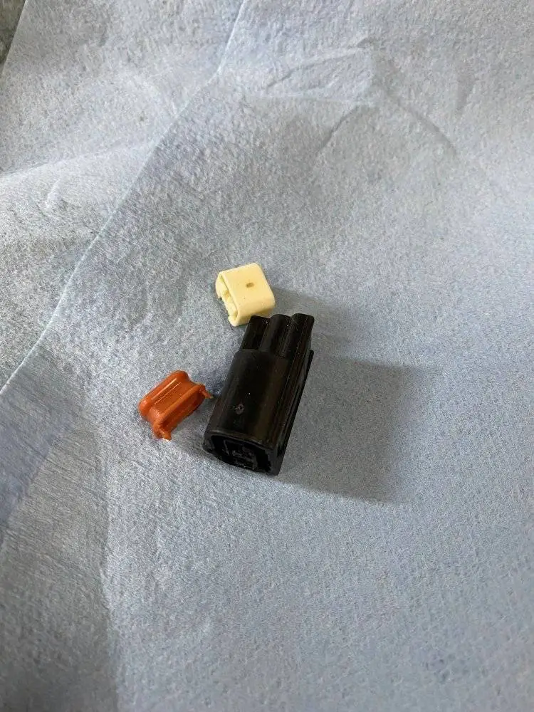

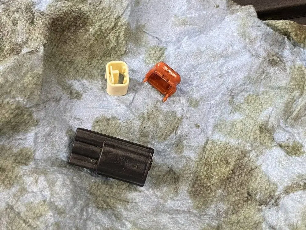

Since the old valve must have been leaking internally through the wire harness pins, the harness clip got oil all up inside it. To avoid contaminating the new OCV, I de-pinned the harness plug and cleaned all parts using brake cleaner, warm water, and also a pipe cleaner (nowadays they're called "fuzzy sticks") :ROFLMAO:
I also got the valve cover all cleaned up from the oil that had leaked out of the old OCV, and reinstalled it with fresh Mazda sealant at the 4 locations specified in the FSM. Now I have the bolts hand-tight and am waiting an hour before torquing the bolts to final spec.
Thanks for the update! So you reused old valve cover gasket and OCV rubber O-ring gasket?
Yes but they’re only 5 months old and still looked in great shape. The valve cover gasket even came off cleanly with no sealant residue on it. I only had to clean the traces of old sealant off the 4 points on the cylinder head, which was very easy with a scraper and a brass brush.
Changed the OCV on Saturday, and the car has been driven several times since then. I just checked and no sign whatsoever of any oil leaks anywhere! 🙌
