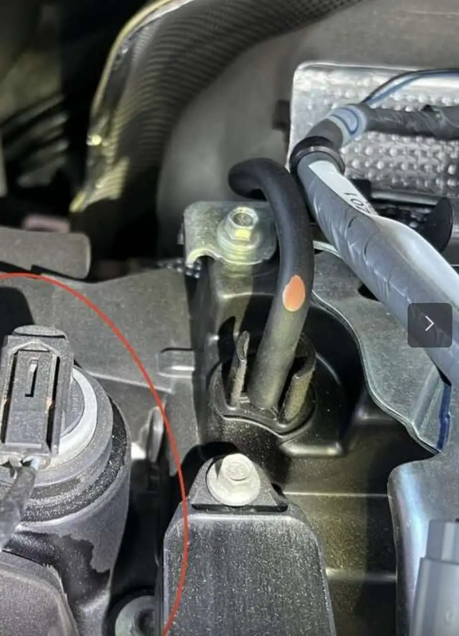

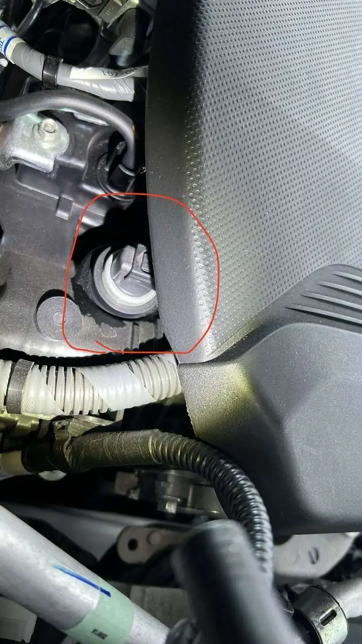

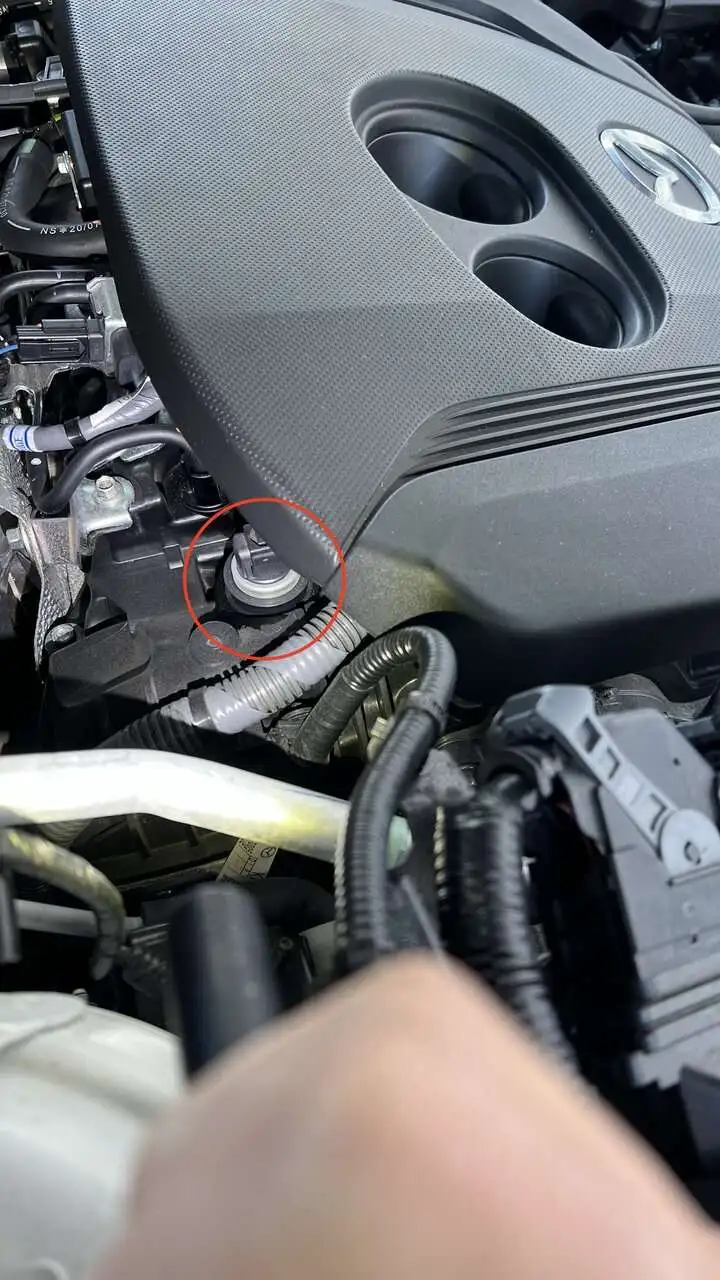

Old thread but I see some oil seepage under my engine cover on my 21 GTR turbo with 6,896mi, I circled it, btw does anyone knows the part?
Upvote 0
That’s oil control valve (OCV) or VVT variable valve timing solenoid. This OCV is very prone to leak. But yours should be covered under warranty.

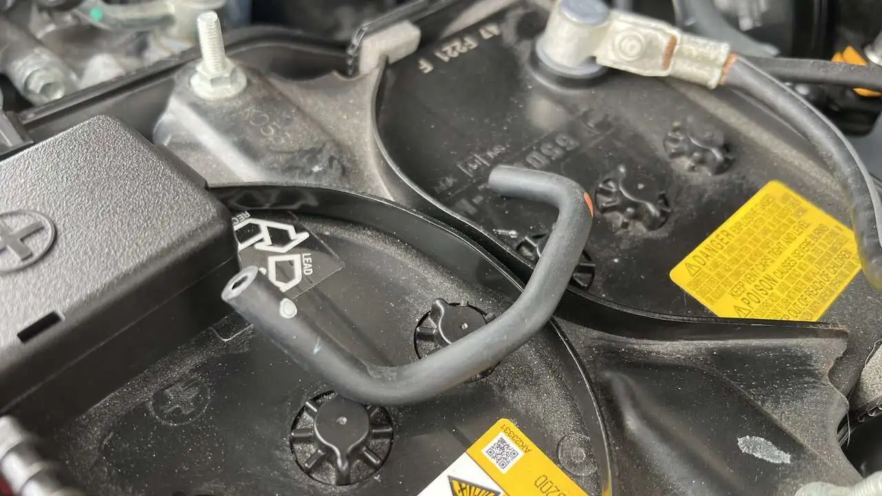

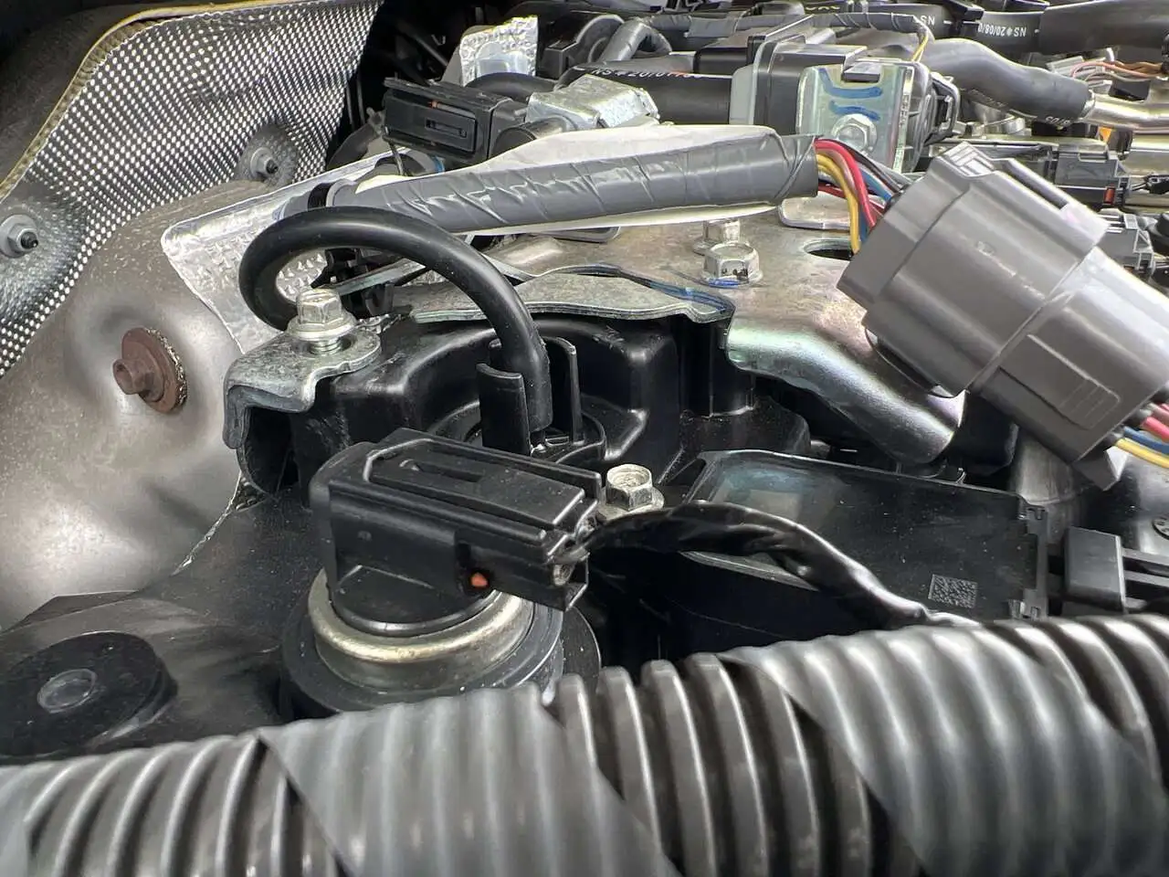

Do you know what this small hose is for? I had the OCV solenoid (valve cover) replaced and see that uninstalled hose.View attachment 321012
Sorry, I really can’t tell. That hose looks like loose at both ends? It also seems never been attached to something before with no clamp marks at both ends?
BTW just saw your related post of the warranty repair in another thread:
2017~2023 Clunk on sharp turns with brand new CX-5

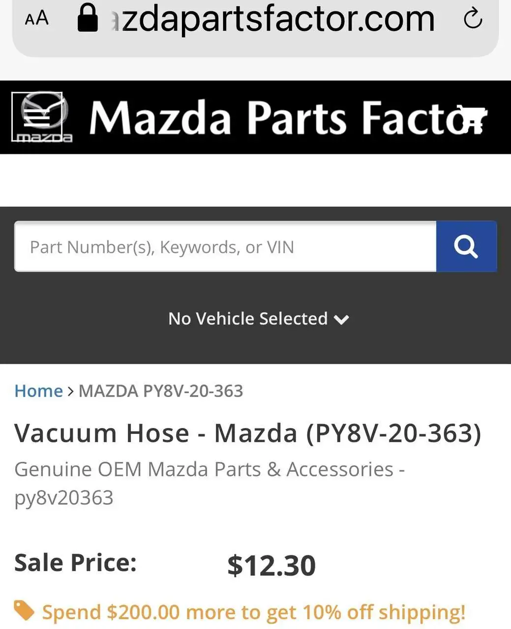

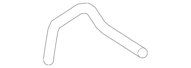

Your VVT solenoid oil control valve (OCV) never did get replaced. My guess is this hose is the vacuum hose PY8V-20-363 listed on the invoice you posted. Somehow the tech requested this hose, but found it’s no use, and forgot to take it away.
It’s unfortunate the Bay Area Mazda dealer is doing a sloppy job to fix your problem. My daughter living in Berkeley is having the same issue dealing with Toyota dealers in the Bay Area, although her problems were on free Toyota maintenance and broken rear quarter window by a break-in.
Upvote 0
isnt it the hose that is visible on one of the previously posted pictures?
top of the valve cover.
Oh s*** good catch. They replaced it since new hose has no markings. As far as the ocv they replaced the whole valve cover so should be new. Also found out the exhaust shield was not tightened to valve cover.
I don’t believe your dealer replaced the hose in picture as the loose hose doesn’t have any marking and loos brand new. See post #29 above.

For the vacuum hose the old one had orange mark but new one has no markings as evident on very first photos it has orange.

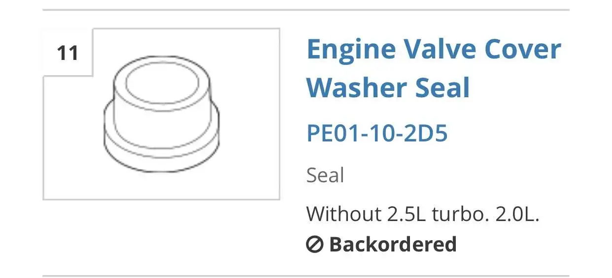

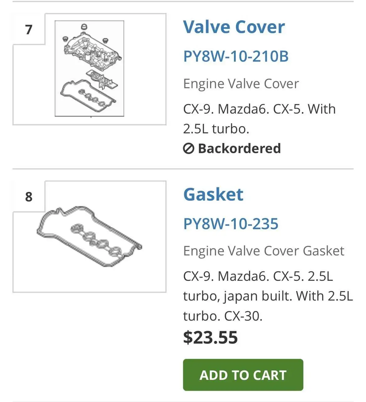

I believe you have a 2.5T. Based on your invoice, the Mazda dealer replaced only the valve cover gasket PY8W-10-235 which doesn’t include the round rubber washer seal PE01-10-2D5 for the VVT solenoid OCV PE01-14-420A.
You didn’t get the full valve cover set PY8W-10-210B which will include the new valve cover and round rubber washer seal PE01-10-2D5. And no you didn’t get a new valve cover either.
Not sure where is your PYY3-10-2B0 part no. coming from, although it seems to be similar to the full valve cover set PY8W-10-210B mentioned above for the 2.5T.
Finally, when you have the oil leak in VVT solenoid oil control valve area, it usually is from the OCV itself, not the washer seal.
