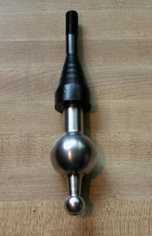

Also was tired of the sloppy shifter. Turns out even after replacing all the bushings I was still missing the bushing that sits in the turret, unfortunatly you have to order the entire block in the turret to get that bushing (or that's how mazdatrix sells it). So I just took a large rubber vacuum plug, trimmed it, and stuck it down in there. Problem solved I can now find the gears a lot better. This is going to stay until I either put in a miata short shifter or make my own bushing front metal or hard plastic.
How so was the shifter sloppy? Was it loose/not returning to neutral? I think that's a problem with a spring. Any reason for going with a Miata short shifter, or is it just because you have a Miata transmission?
no, there basically the shifter, which has that smaller ball at the bottom, ex:
that ball sits in a cup that essentially translates movement from the shifter into the transmission. The cup is bigger than the ball, and there's a bushing in there that ensures a snug fit. If there's no bushing, there's a ton of slop in the shift linkage.
Problem #1 was the normal bushings which I replaced a while ago helped but not great
Problem #2 the ball at the bottom of the shifter has a lot of free space which is where the slop is
The miata short shift is a couple reasons. But first I am using a miata gearset I still have to use my rx7 housing so it bolts into the car. Any way the miata shift first off is cheaper than any offering for the rx7, second it fits with very very little modification, and thirdy I can use miata bottom bushings including any upgraded ones (I assume they make them because they are a big weak point).
My spring is ok, yeah its not the best as it has a little problem returning to neutral from the 1-2 side of the shift pattern but otherwise not the problem.
I don't think that my shifter had a bushing when I removed it. The miata's short shifter works with some slop since its bushing did not fit in my RX-7s cup. I don't remember what year Miata short shifter I got, it's been awhile but it was an ebay special.
Well figured out the bushing thing. Did a shifter replacment on a xrunner the other day and saw it had a larger version of the miata shifter bushing. I tried it yesterday and it fit abolutly perfect in there. Clipped right on the shifter ball and fit right in the turret with no slop. Shifter feels awesome now. Dunno if this is something new or what but anybody looking for that bushing its the lower bushing for a toyota tacoma 05+ with the 6speed transmission. I can get the part number for anyone interested.
