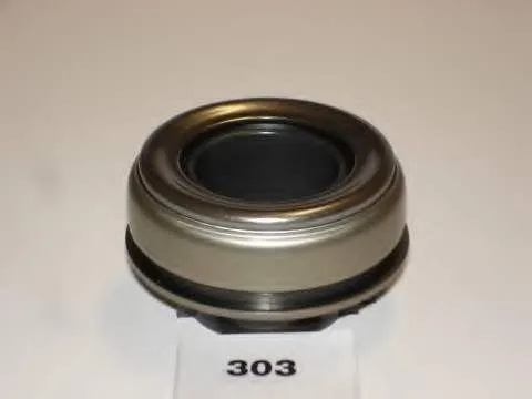

I sent them another e-mail, with my local dealer in CC (RacingNick) and sent them the picture of the replacement pressure bearing (CF-303 from JAPANPARTS) along with a compatibility part numbers list from allmazda.net (attached)

The clutch kits include the pressure bearing BRG871.
