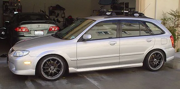

Rishie,
Unfortuantely, I read your fitment recipe too late. I have an 02 MP5 lowered on Progressive springs and I just got some 17" Enkei RSVs on 205/40/17s. The clearance is okay and it fits into your "barely making it" category with the +42 offset and I get a little bit of rub only on big bumps or a bump during turns, nothing major but still annoying. I used to have Tenzo AV7s with +42 and they weren't quite as sensitive. I've had to roll my fenders as a result of the AV7s. Now that the damage is done (meaning my money spent) what can you suggest I can do to buy a little more room in the wheel well so I don't have to be as cautious/paranoid and possibly fit 2 passengers in back instead of 1 or none? Would any tricks with shocks with adj. perch or other springs work? Any help would do. Thanks.

if u rolled your fenders, there is really nothing you can do unless u get custom fender flares or something. my tein stech springs had no problems with my rims b4 (+42). i have swapped rims with a +48 offset since i changed my suspension to clear the fender.
good luck to you.

From my personal experience I've had Tenzo AV7s with +42 with 205/45/17 and I had major rubbing problems even with rolling the fenders, but my car was also lowered. I would say non lowered you'd be fine. I ended up getting 205/40/17 instead and I was okay. That is also closer to the original wheel size so you won't have speedo differences. I'd say 40/17s would clear an unlowered MP5 easy and 45/17s would probably fill the gap a little more. Not sure about 215 vs. 205. I've always had 205s because my rims were 7" wide. Now I have Enkei RSVs with +42 and 205/40/17 and I still get a little rubbing on huge bumps or a bump in a turn but it's nothing major. It sounds worse than it is and there is nothing actually digging into the tire. I would suggest the 40/17s if you plan on lowering your car later. According to Rishie's recipe the +42 wheel will fit but it's in the "barely" category. That's why my car has an occasional rub but for the most part it's fine. To be safe get something greater than +42 like he said. But I can tell you it works. Now, I'm talking lowered, if you're not going to lower your car then I think you'll be fine either way. Good luck.
