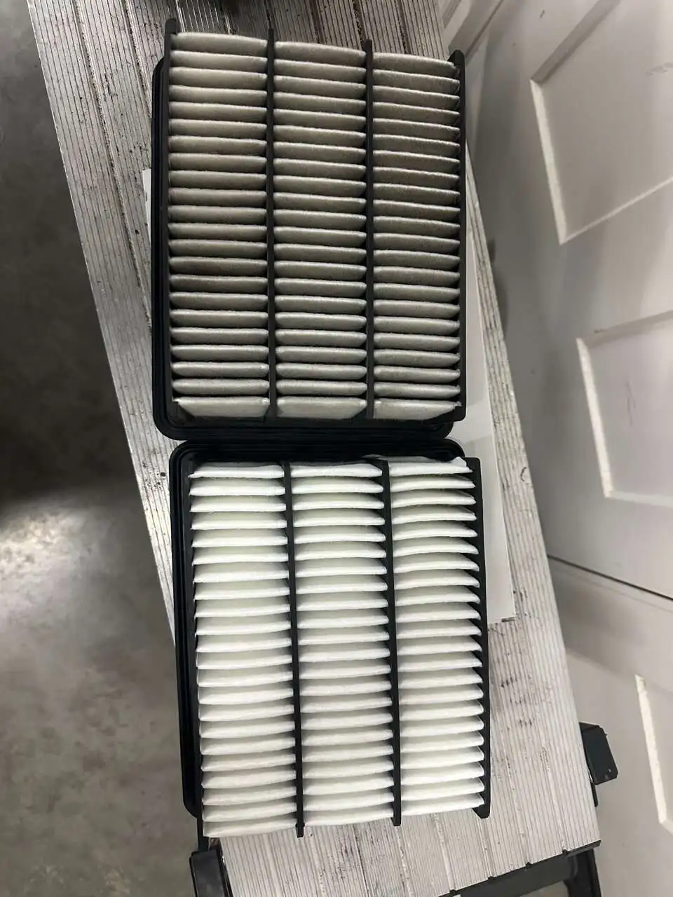

that filter isn't anywhere close to having a restriction or bypass.
I agree 100% I was surprised at how clean it is after 15000 miles and a fair amount of dirt roads. People say turbos need to be changed really often but my turbo must suck less than most :)
