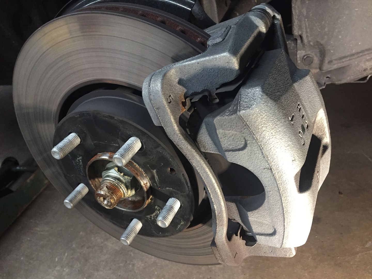

I'm not looking forward to this at all, and I've complain to Mazda about it once already. I bought my 16.5 CX5 sport in Feb. 2016, and my driver side front rotor warped at 600 miles and 5 weeks later. The dealer tried to just re machine mine, and I had to call Mazda North America to have a new rotor ordered. Vehicle has 5204 miles on it now, and it was serviced in August and pad readings were ok. I 'll be shock if mine doesn't have to be replaced around 30k miles at the latest.
