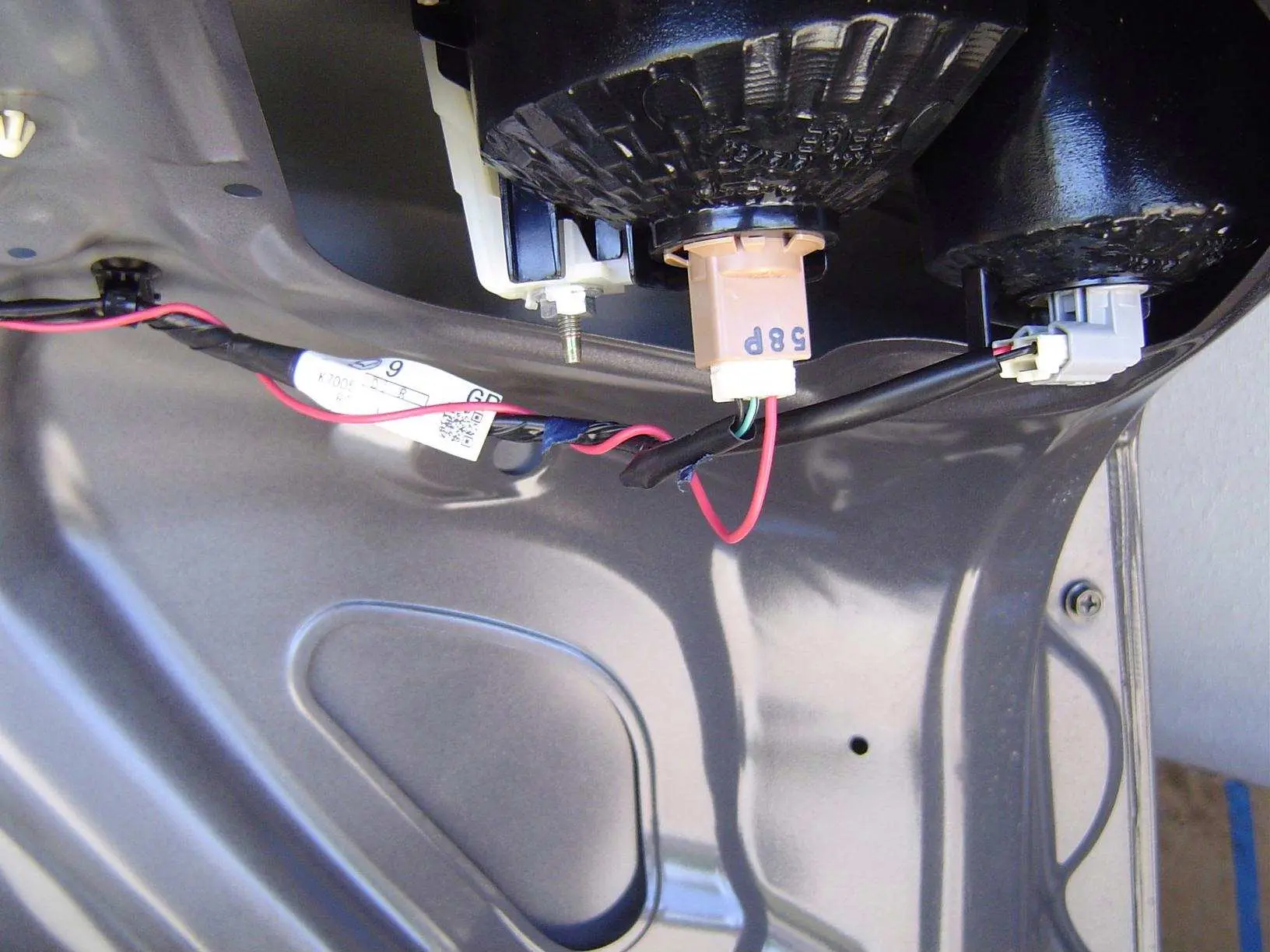

I got this from AzMz6. I saw him do it yesterday on a regular 6 so I did it today and it's cake. It makes it so the 2 red lights on the trunk light up when you hit the brakes, instead of just the 2 on the fenders. It is super easy and takes like 15 minutes.
Remove the liner on the trunk lid.

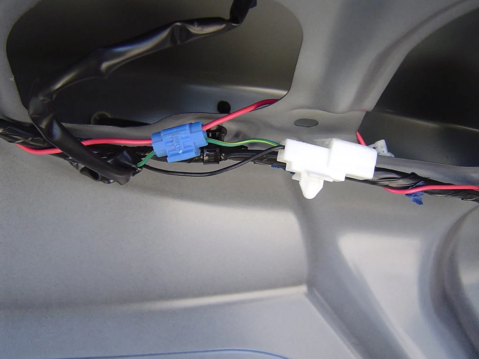

Find the connector for the 3rd barke light connector and tap into the green w/yellow stripped wire. (the 3rd brake light connector is in the middle of the lid just to the right of the latch, it has a black and a green w/yellow wire in it) Run a wire from that wire to each of the lights on the trunk lid.
Then strip a small piece of the wire you ran and insert it into the open hole in the connector that plugs into the red light. Add a little glue of some type (I used clear RTV) to hold the wire in and that's it.
Here are pics of the wire to tap into and how it's put into the connector. Once again, this how AzMz6 did it and is much easier then what other people have posted how to do it. Thanks Tony!

You should be able to use the pics in the first post and my list of materials and put it together. The wires are hard to miss. Just take your time and post if you have any questions, I'm sure someone will be here to walk you through it.

question. so, on the plug where you insert the red wire is just an empty "wire hole" (for lack of a better term)?
or is there already a wire in there your tapping into?
its kinda hard to tell in pic.

You put the wire into the open hole on the connector and secure it.
