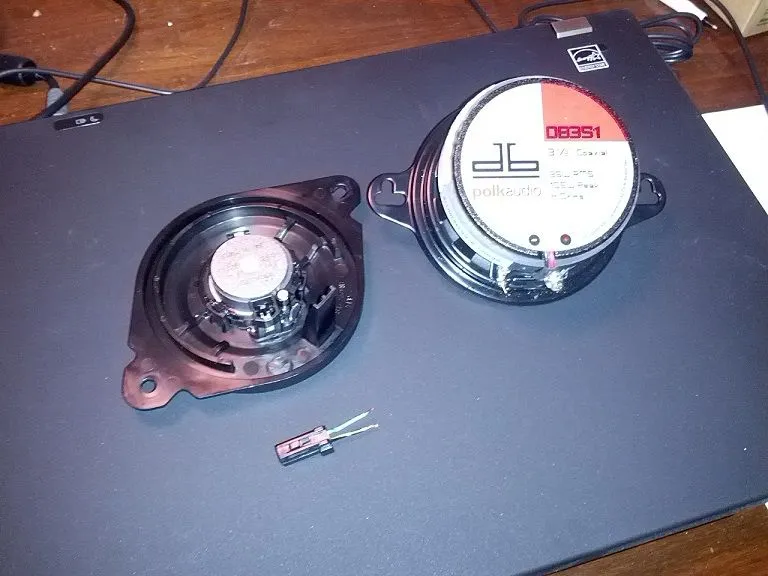

I just replaced the tweeters on my 14 M-6 with Polk 3.5's (DB351) and the connector on the mazda tweeter is just molded as part of the tweeter frame and not chop-off-able. I posted a thread w/ pics over in the 14 M-6 area.

.........I may just chop the plugs off these and solder together my own adapters if the OEM speakers sound bad.

Used the cpu fan connectors as suggested earlier in the thread to connect to the OEM connector without having to splice the wiring, I then just cut the other end off and soldered to the speaker connections. They fit very snug and i didn't use anything else to hold them in place.
