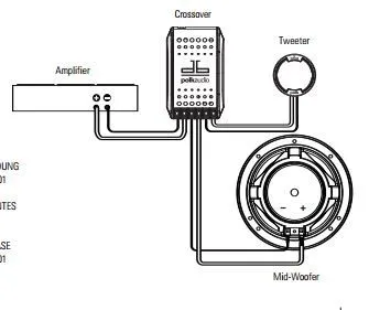

Are the dash speakers wired as tweeters? I know they're split off of the front door. I'm wondering because if I decide to amp the door speakers later down the road, would I need just a 4 channel or would I need a 4 channel plus a 2 channel for the 2 dash speakers.

The tweeters, are connected to the front door speakers. I'm wondering myself about the total resistance of this setup.

It would be less ohms at front then the rear, since at the rear there are no tweeters?

But okay cool, yeah i have read that the sport doesn't have the dash speakers but the wires/connector for them are there.

If you do it by using a pair of component speakers (Woofer and tweeter in the same set) you would only need a 4 channel amp because: they generally provide a crossover with the package for each side.
The speaker lead from the amp would run into the crossover which then splits to a set of wires for the tweeter (dash) and a set of wires for mid woofer (door) see attachment...
