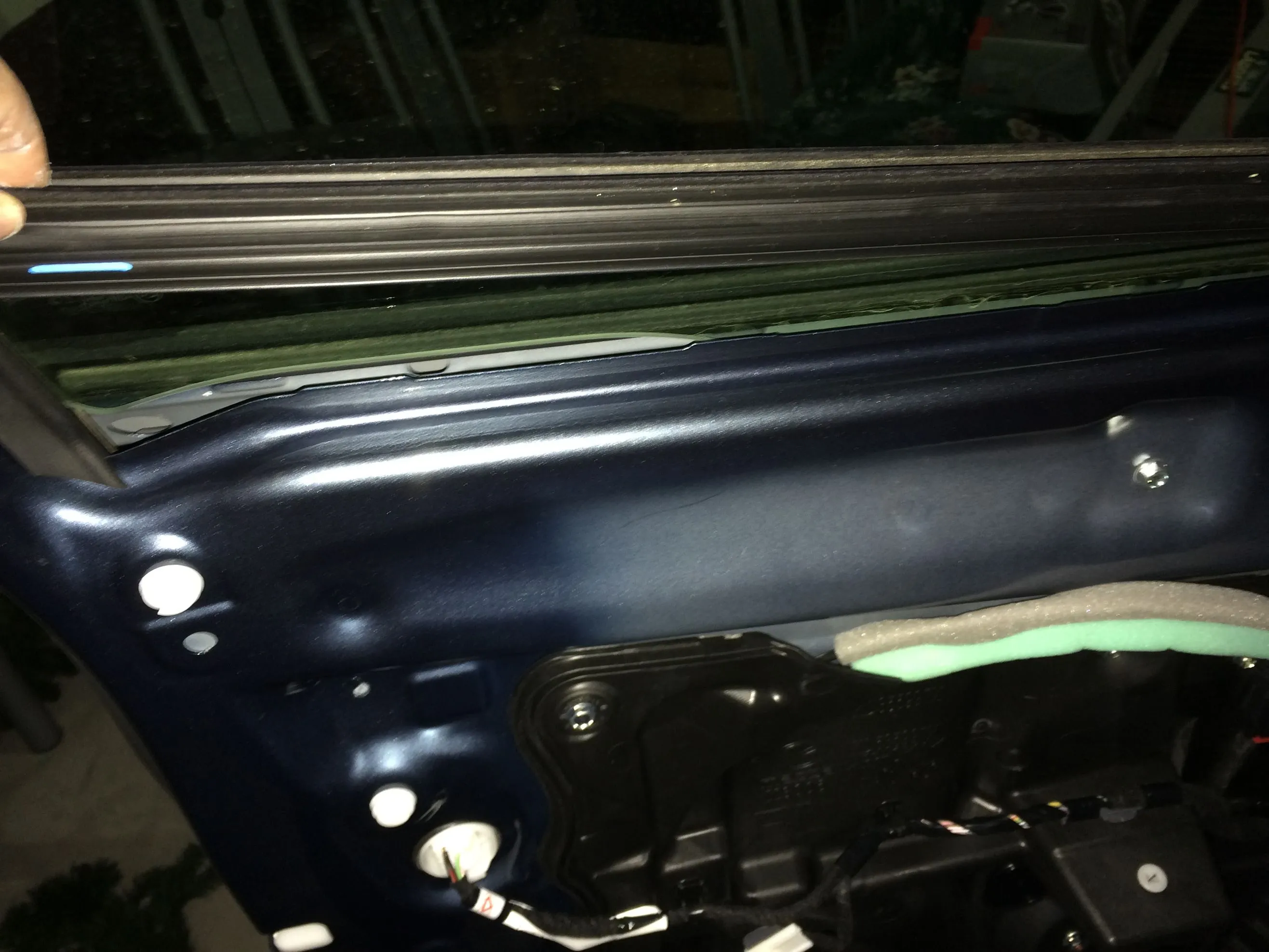

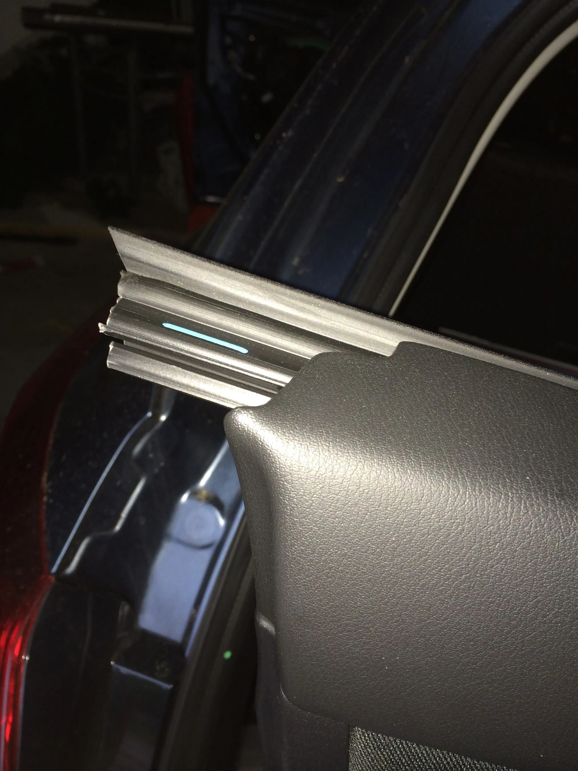

I had a hell of a time putting the door panels back on. Remove the weather trim from the door panel and attach it to the door first before putting the panel back on. It makes putting the panels on easier. They slide out (See pics below). I was a bit concerned if this would introduce any water leaks into the doors but it didn't. It rained over the weekend and I removed the panels again to check for leaks and moisture.
Placing weather trim on door & in the slot between windows and door.
Yes this is a real pain in the bum. It's very hard getting it on properly (which takes brute force). You can tell if it isn't on properly by wind noise coming in when cruising on the highway... another tell tale sign is that the top trim isn't hard up against the glass.
