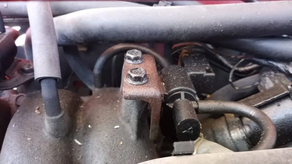

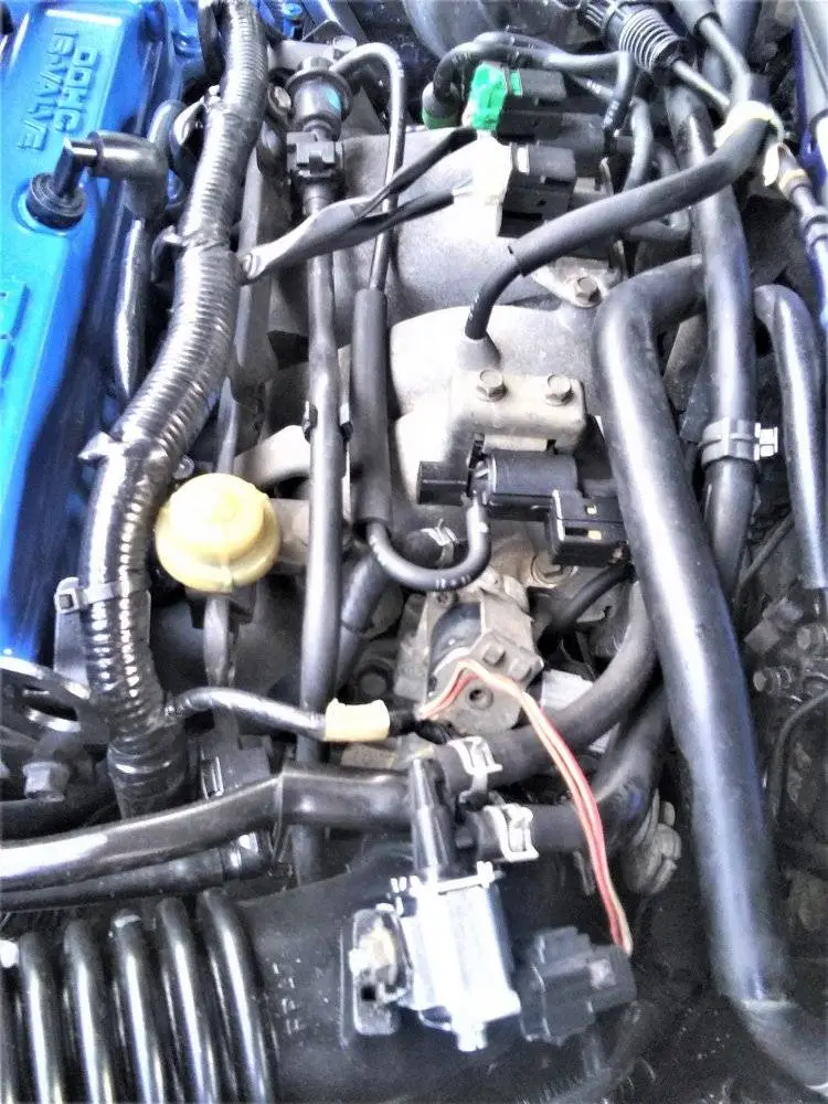

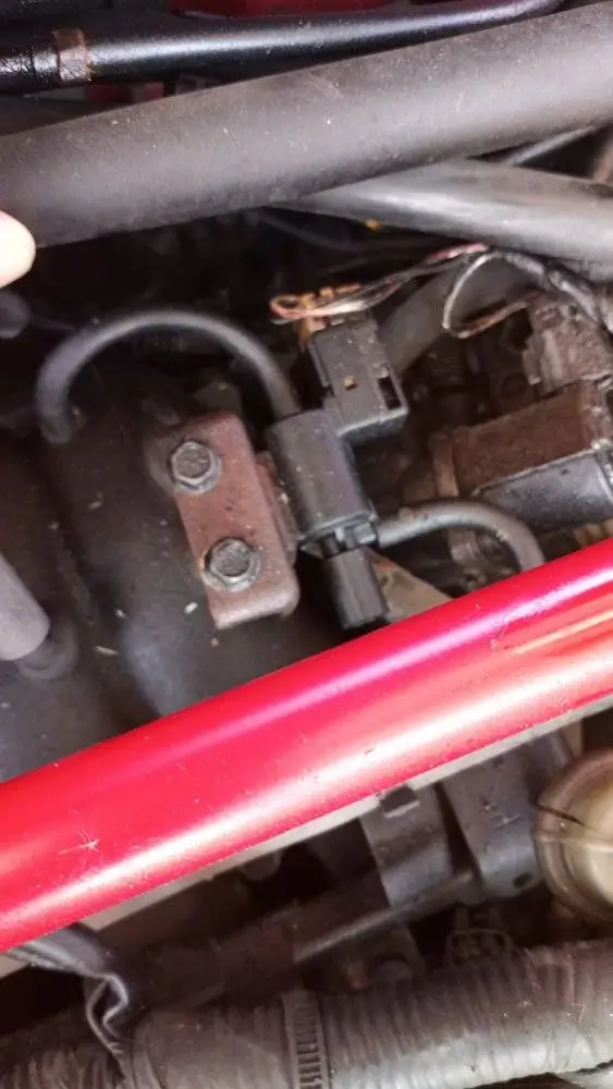

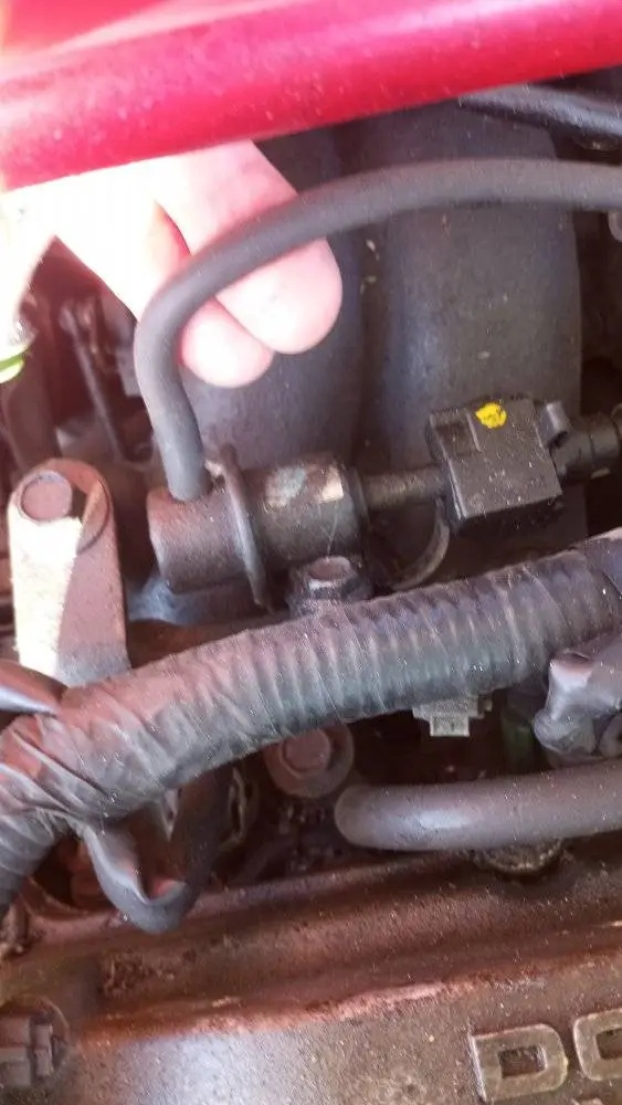

this is how the tube looks right now.
Yeaah...that's not how it looks on my car. The zip-tie idea is not bad at all, but it may not be a real solution if that tube has been replaced and it's the wrong inner diameter. Definitely worth a try though, at least temporarily. I honestly don't know where you'd buy a replacement OEM or similar tube for that.
whoever changed it probably couldn't find one that fit. this car had 4 owners before me soooo i wouldnt be surprised if someone messed with it.
With the rubber band around the tube the fluctuating idle seems to be gone now :) I dont have a code reader to clear the codes yet, but ill order one.

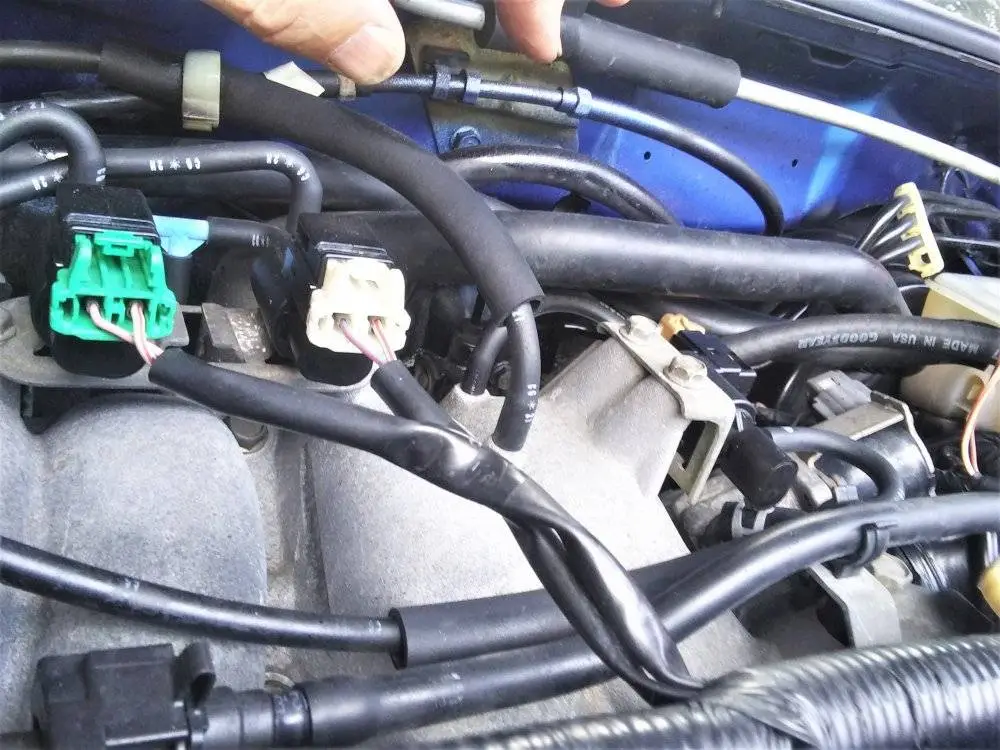

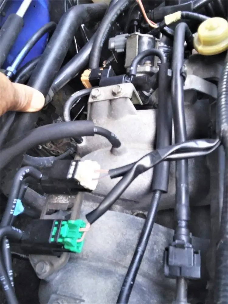

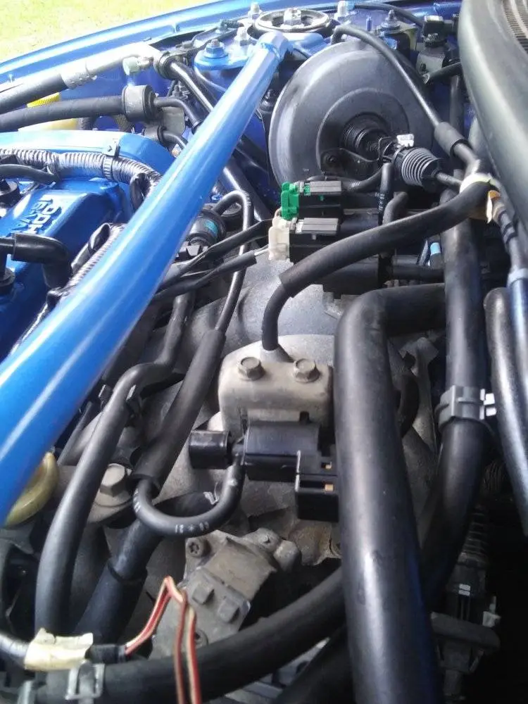

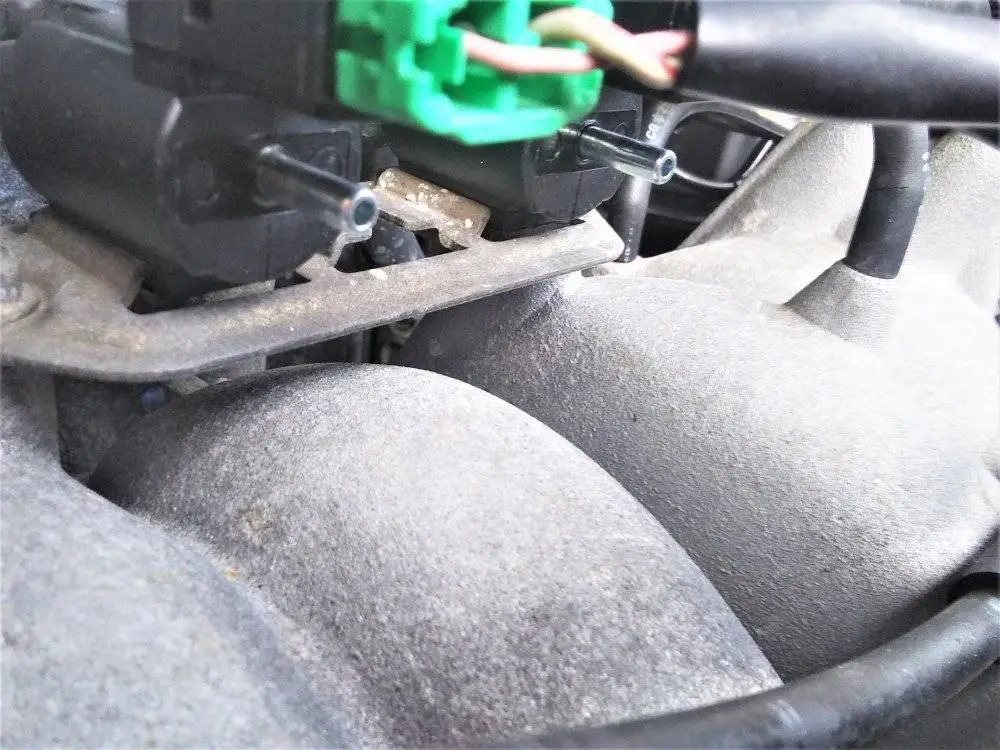

Ok - I took my upper support bracket off to get some good sensor photos for future reference.
(Oops - Hit the wrong button and will post photos on my next attempt).
I got some pictures...

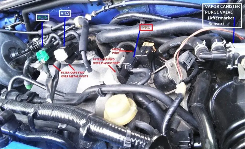

I just got to this conversation.

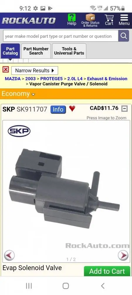

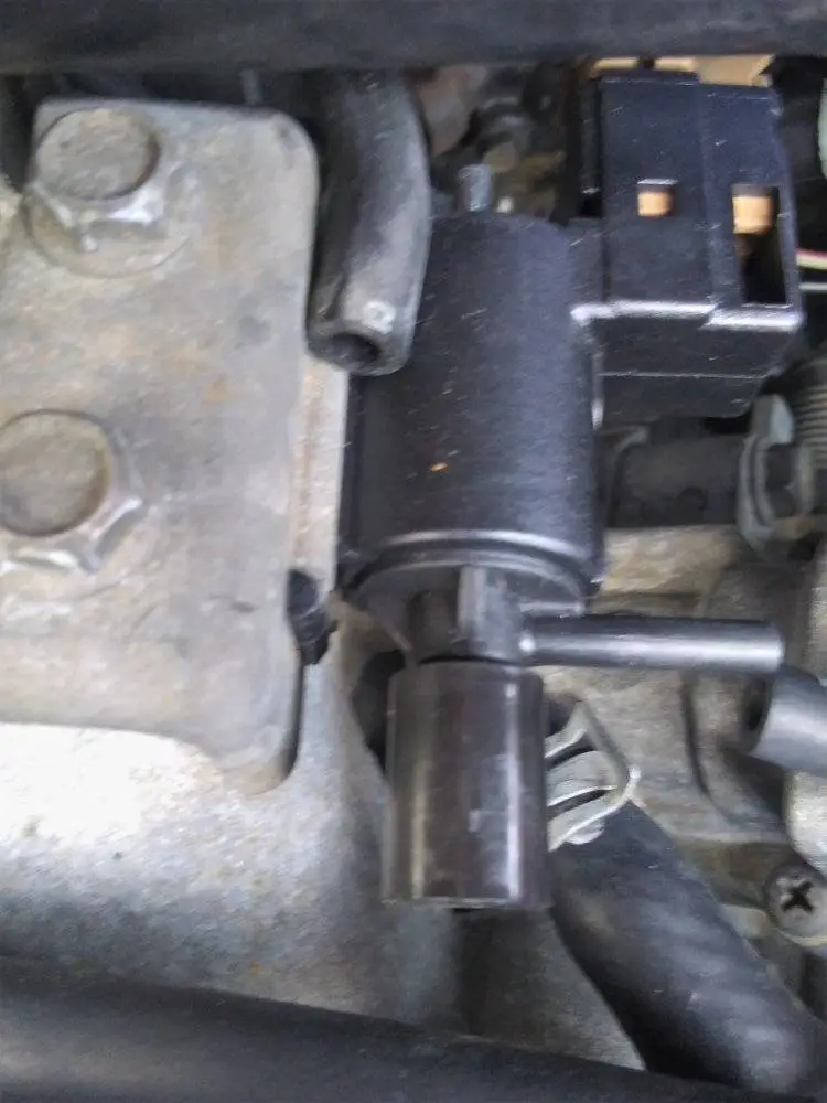

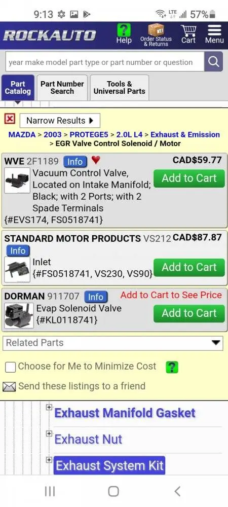

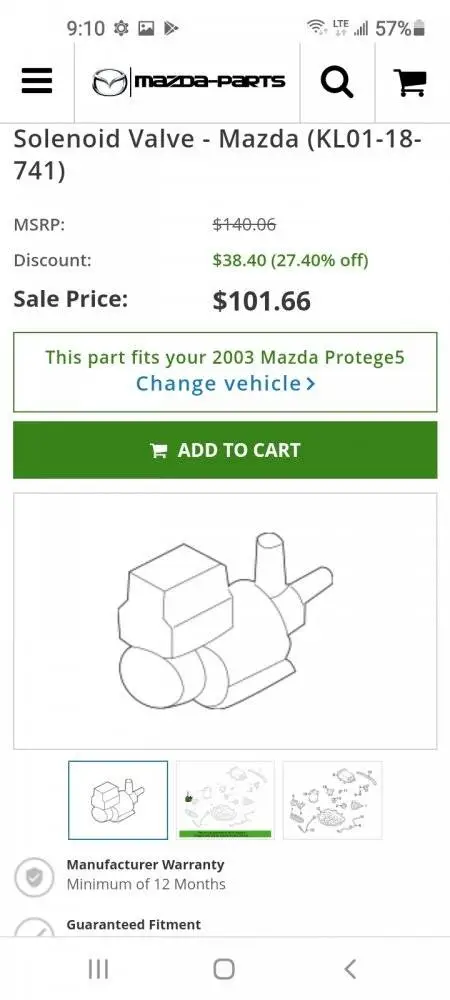

The above solenoid is the fuel pressure regulator control solenoid.
I believe it has a brass nipple because it is working with the fuel system and is better built but it can cost upwards of $100.
The solenoids with all plastic nipples perform the same function and plug in the same way (except for moving the air filter to the other port) but may not be as reliable.
It's not a big deal, you will throw a code if it fails, and won't be able to restart your car when it's hot.
You'll have to let it cool down.
That vacuum tube has probably been replaced and is not the right inside diameter as mentioned.
You could even clean up the nipple and inside of the tube and glue it on with crazy glue.
(or a zip tie, or small clamp, or replace the tube)
It may be metric sizing, and that replacement tube may be SAE and slightly bigger.
The codes will clear themselves after a couple of drive cycles, then you don't have to go through all the "system readiness" crap after rubbing your codes.
Just drive it and be happy that you did it !! 👍🏻👍🏻👍🏻
Make sure your vacuum tube doesn't fall off in the mean time.

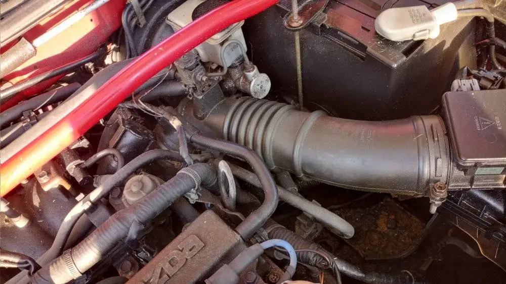

I'm confused now.
Where's your intake tube ??
Did you remove it ??

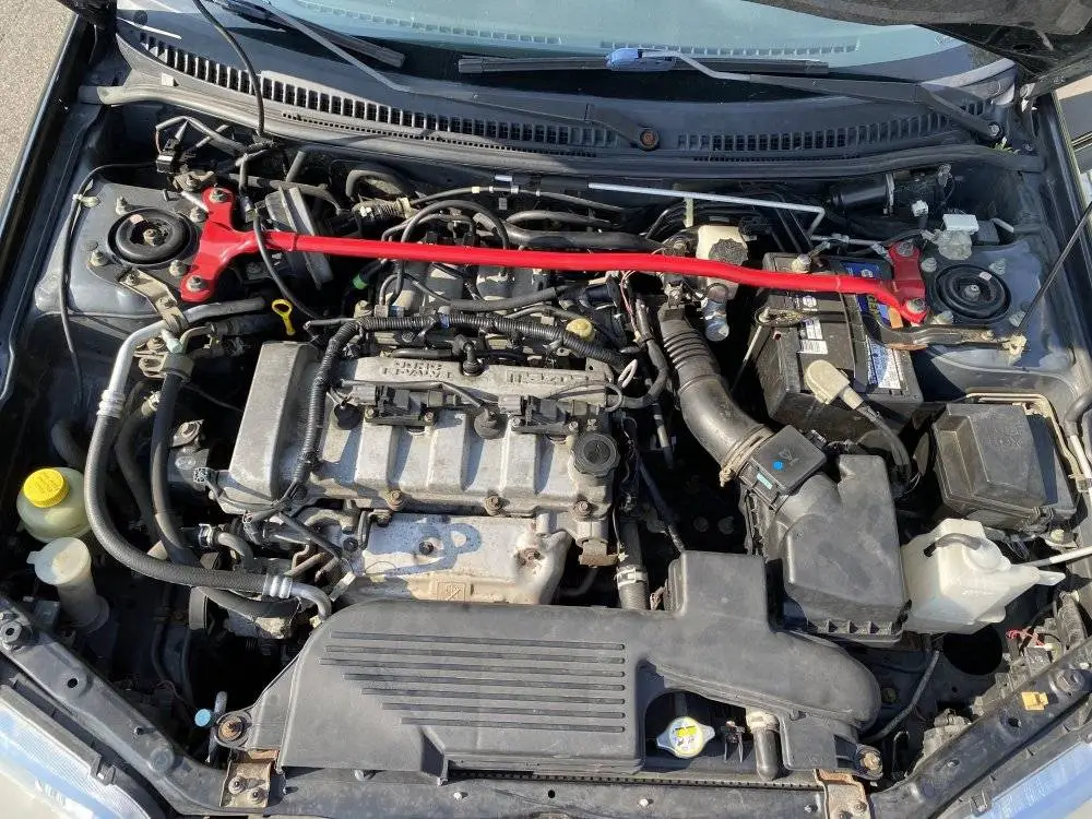

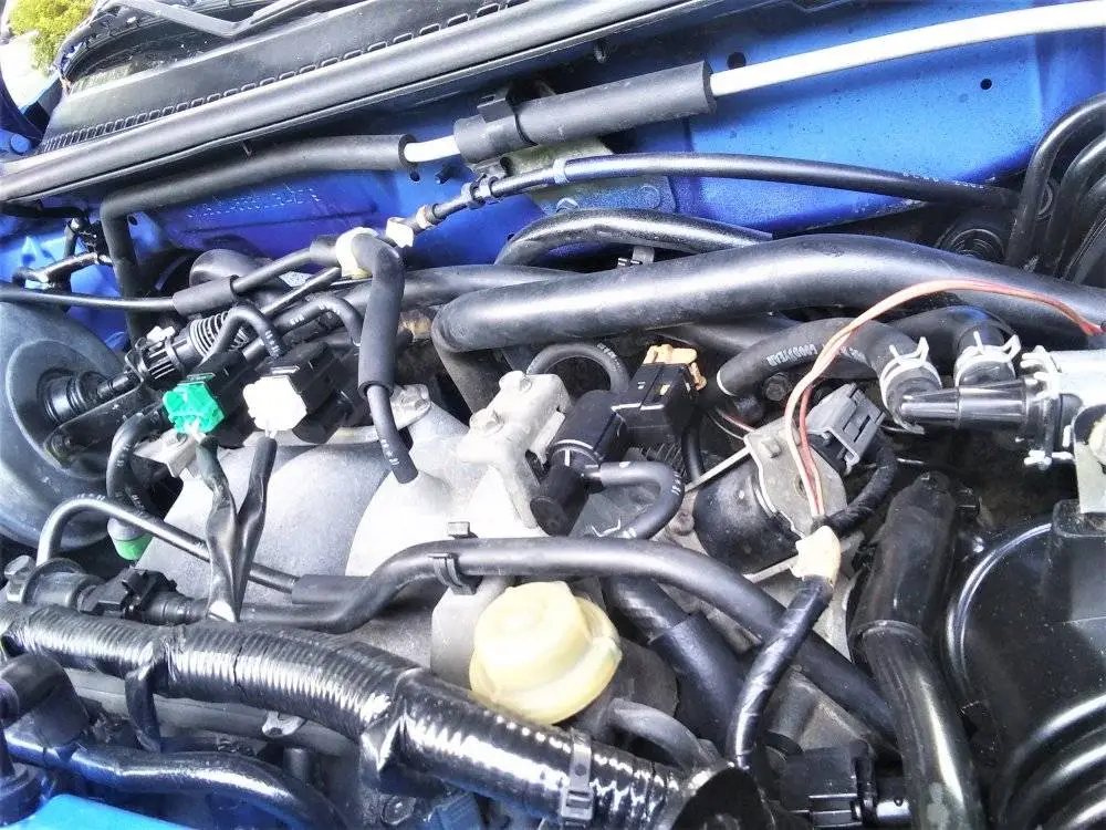

This is what my DD looks like...
These are your pictures...
I don't what's going on.
You don't appear to have an intake or air cleaner.
You might be sucking air from your engine bay directly into your intake manifold.
The MAF sensor is in the intake tube.
I don't know what's going on, unless you removed your intake tube but you don't need to do that to replace any of those three solenoids.

I was mistaken.
I thought flunky was posting a picture of his engine bay the way he bought it.
(I thought it had no intake.??)
I threw the PRC solenoid valve code about two years ago.
I replaced the solenoid with the one from my parts car in about 10 minutes.
I didn't remove the intake tube.
I popped the code and fixed it so fast that I forgot the details.
(That is the valve that had the brass nipple.)
If you've already replaced all three solenoids and everything is working, then just leave everything be.
But Don't Throw Out Your Old Brass Solenoid.
You can use it to replace any of those three new solenoids if you throw another code and they crap out.
It's the heavy duty brute and it wasn't throwing a code, so it was working.
Keep an eye out for this code or if your car won't restart if it is warmed up/hot.
All that solenoid does is tell the fuel pressure regulator to increase fuel pressure for 100 seconds to restart a hot engine.
You might be stranded in a parking lot while your engine cools down but its not a safety concern.
