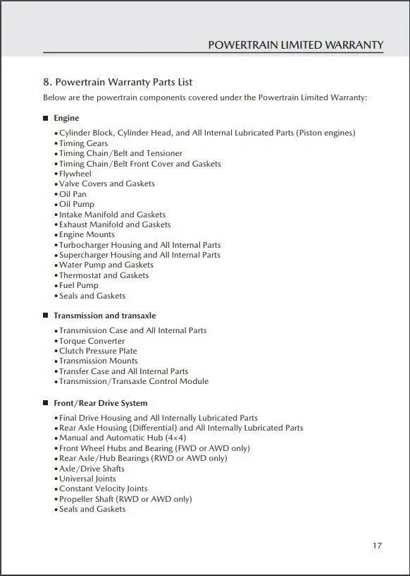

I don't have any experience with this problem, but I wanted to mention that your dealer is full of it. The warranty covers a lot more than just engine internals. From the current Warranty Booklet:
If they try to deny warranty, you'd be able to make your case with Mazda Corporate, who should intervene on your behalf to get the car repaired.
Wow! I specifically asked about the tensioner (as I had read it was a potential source) and he said that nor any belts were covered. I called him out and asked if my Powertrain would function without the tensioner and he said "no". Definitely full of it. Hopefully it doesn't end up a fight.

My guess is engine mounts which is covered under 5-year / 60,000-mile powertrain wartanty. The dealer isn’t supposed to charge any diagnostic fee for any problem under warranty.
No, the problematic (serpentine) belt tensioner isn’t covered under powertrain warranty.
