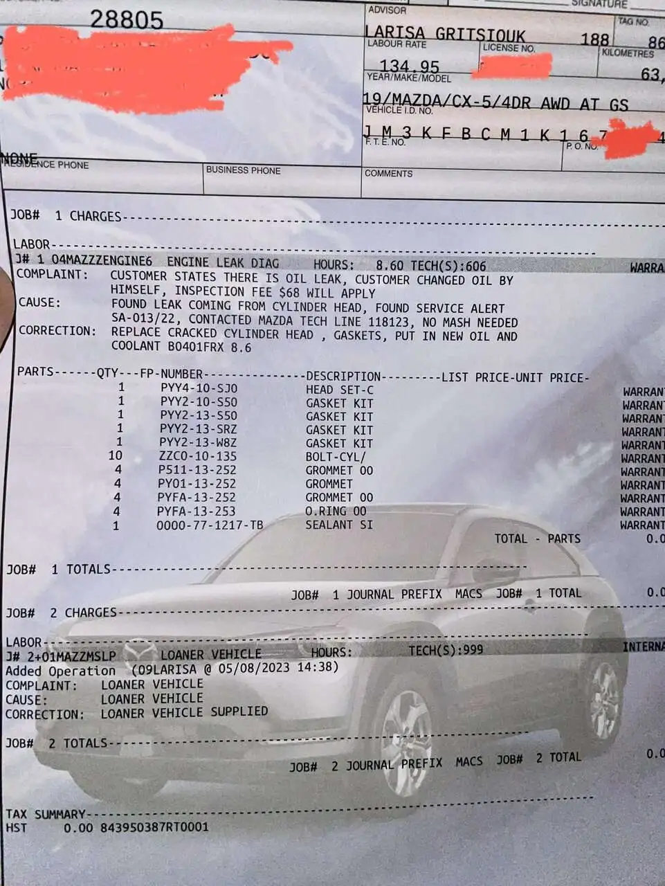

Thanks for the update. If you can review the invoice and find the part number of the replacement cylinder head, someone here might be able to verify if the head is the revised one.

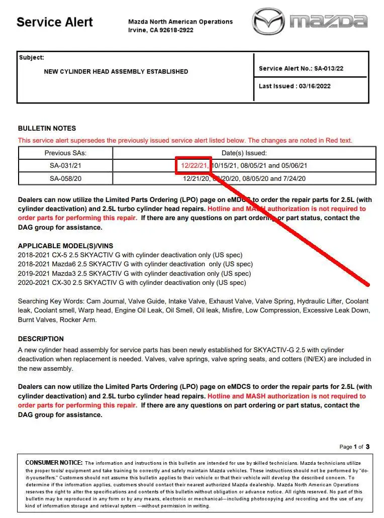

The latest TSB clearly indicates that it is applicable for even the 2022 model (I am attaching the screenshot).
My 2022 model CX5 was built 12/21 (the sticker on the engine shows 12/21 as well), but technically it is a 2022 model.
In my understanding, based on the latest TSB even the 2022 CX-5 model has the old defective cylinder head.
Correct me if I am wrong.
the date in red shows the updated text in red. It doesnt mean thst cars made on that date are affected. The applicable models years are listed.
2022 models are not affected based on the bulletin.
... If you can review the invoice and find the part number of the replacement cylinder head, someone here might be able to verify if the head is the revised one.
The part number that @JRMMTB just posted is the same one that's been sent out ever since Mazda packaged all of the individual valve components into a single head unit, as described in their TSBs.
And once again, I've never seen anything from Mazda confirming that this NA head has had any changes made to it over time, as they have done with the turbo head. And that's probably why his dealer waffled with the answer - he just doesn't know.
...find the part number of the replacement cylinder head, someone here might be able to verify if the head is the revised one.
An earlier report in a related thread also lists PYY4-10-SJ0 as the replacement cylinder head for a 2018.
Per realmazdaparts.com and mazda-parts.com, PYFA-10-100E is the part number of the cylinder head for the 2018 CX-5. When you look up PYY4-10-SJ0 and run the checker to see whether that p/n fits the 2018 CX-5, it says "This part does not fit your 2018 Mazda CX-5."
That suggests PYY4-10-SJ0 is different from the original head. I say "suggests" because part number changes aren't always associated with physical changes in a part. Sometimes it's just a bookkeeping thing or indicative of a change in the supply chain.
If you look at the older service alert (SA-058/20) then it lists the new part number for the kit and then the components of the kit, including PYY4-10-SJO. But then below it lists what PYY4-10-SJO contains, where the first item on the list is "Head, Cylinder (Older Assembly)". That's not too reassuring if it's not a new design. The second SA (031/21) does not list any part numbers but suggests that there is a new cylinder head. There is a new assembly, but this could only be the fact that it is a kit, maybe? I hope it is a new design because I have a 2.5 NA built in 6/22 (a very late 2022).
Here are the receipts. I was planning to keep this one after the lease expires but now I have doubts about the repair done on the engine. 2019 CX5 NA DC.
Thanks for reporting in with a service novice for the cracked cylinder head on your 2.5L NA with cylinder deactivation. Personally I wouldn’t keep any vehicles with cylinder deactivation for long term based on the history of such system.
I looked further into this, PYY4-10-SJ0 is listed as replacing 3 older part numbers, listing 2018-21 Mazda 3 and 6. It says Mexico built. I think it is just a mistake that they omitted the CX-5. PYY5-10-SJ0 is another part that is Japan built and without cylinder deactivation. There is also PYY6-10-SJ0, which I found listed for CX-50, but then it says that the PYY4 replaces it if you look up PYY6. Also, in looking for parts for 2022 and later, I can't find anything on these "discount" dealer websites.........
