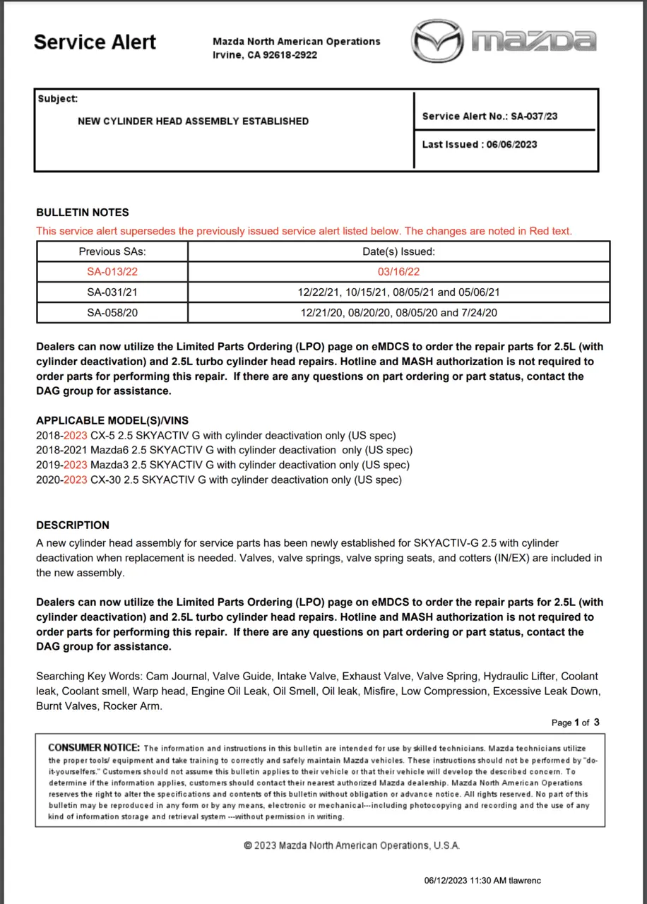

SA-037/23

All this means is that the new cylinder head ordering procedure includes 2022 and 23 models. If you look up the previous SA from March 22, it only applies through 2021 models. It does not mean that they have changed anything in the design of the cylinder head.
So. All of these models listed above thru 2023 and are ticking time bombs and no modification has been made to the thin casting
Could this thin casting be by design? Meant to last 6 years and no more? If no effort has been made to assure it's been addressed in production one may wonder why not. Maybe a stretch but one would think those in the know would try to dispel any long term problems that may occur.

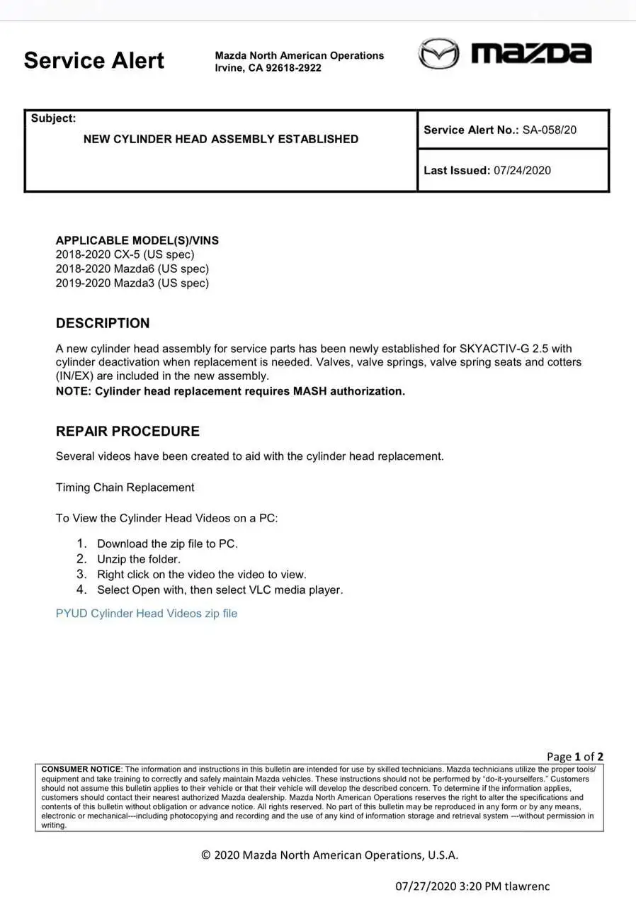

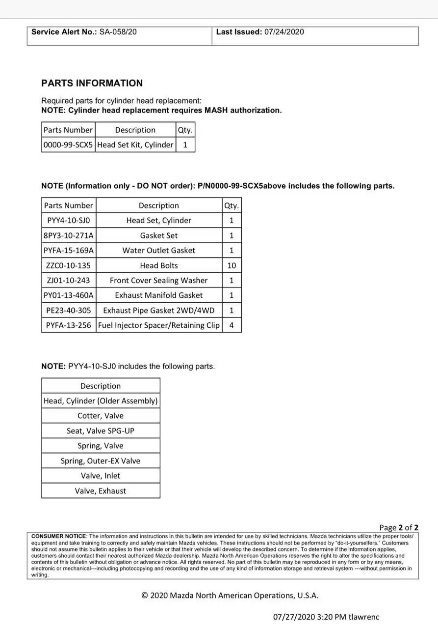

The PYY4-10-SJ0 was listed in the original SA from July 2020 where it was part of the 0000-99-SCX5 Head Set Kit, which has now been superseded byt the PYY4 part. So the question is if this caused by casting defects in specific heads or an inherently flawed design. I would say that someone driving nearly 14k in one year is on the highway a lot where cylinder deactivation is operating. Our car sees mostly city driving. Keep it in Sport mode to avoid cylinder deactivation?
Any idea when the PYY4 replaced the "F" or "E" part? It must have been before or latest early-mid 2020. As you point out, there was probably not any change in the actual head but just a move from offering the head to a "head set".
If you read the original Service Alert, SA-058/20, it explained it very clearly that PYY4-10-SJ0 is the new cylinder head set which includes cylinder head, (older assembly, should be PYFA-10-100F)、valve cotter、valve SPG-UP seat、valve spring、outer-EX valve spring、inlet valve、exhaust valve. P/N 0000-99-SCX5 then includes PYY4-10-SJ0 cylinder head set and many other parts including gaskets and head bolts. In the latest SA SA-037/23 the head bolts are no longer in the parts list for head replacement, hence P/N 0000-99-SCX5 which includes head bolts may no longer been used.
