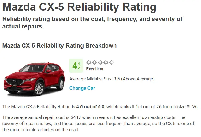

I said it before, reliability ratings sometimes are misleading. The failure rate may be low right now where they’re reflecting good ratings, but once it happens without warranty, it’ll be expensive to fix. You can’t deny these 2 major issues are happening to the 2.5L NA with CD, otherwise the engine reliability rating would be a perfect 5.
