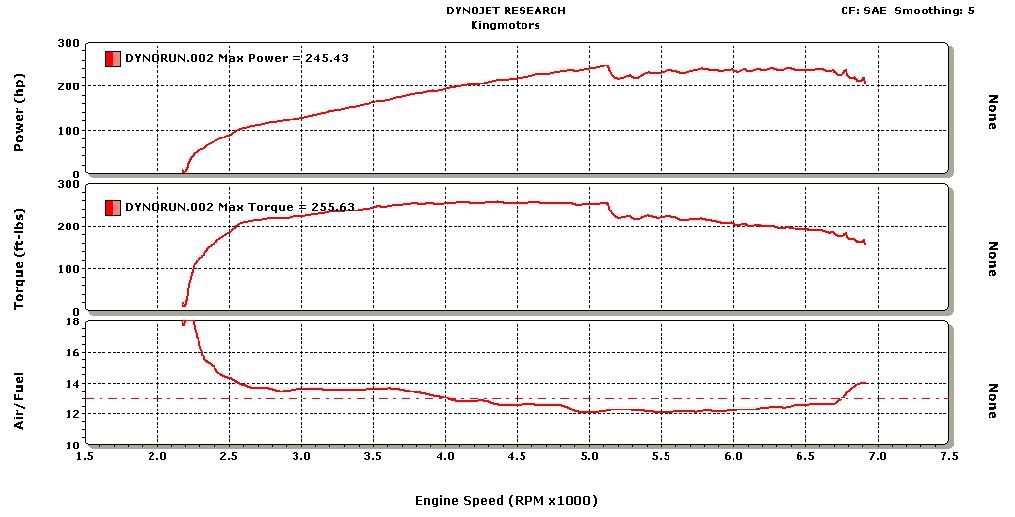

My Turbo 3 Dyno 245whp and 258tq 8psi
Captain KRM P5 said:
~300 lbs more than a protege
it is very important to know what the air/fuel ratios were for this dyno and if any adjustments were made to the map. tom, do you have that information?
No major adjustments, only tweeked it around 5k to try to squeeze some more power out of it. Juan set a very good base map.

really? even with all the problems you had detailed to me over the phone? what do you think caused those issues? how does the car drive now?
It was a very simple fuel cut off problem. The boost would surge when it got a good run, and get a tad into the fuel cut off range. Car runs like a dream now.
fuel cut off eh? thats not good, glad you fixed that. could have meant some serious harm.
FYI, Tom told me that at the dyno, the A/F was pretty good. 12.0 to 12.3 thru all the boost range. They had to do a little adjustment to the 5000 rpm range (just minor) to get a little more HP. The issue with his motor at 5500 rpm was inteded. We set up a boost limiter at 9 psi. If the engines boosts 9 psi the Haltech will cut the fuel 100%. That does not harm the engine at all. It works just like the RPM limiter. Maybe his motor is making a boost peak to 9 psi and that it what caused his issue. That was solved when they raised the limiter to 10 psi. This is a very good safety option.

Nice numbers..i wanna see a dyno sheet!
Also..how stable do you think the mazda3 is with that kind of hp?
