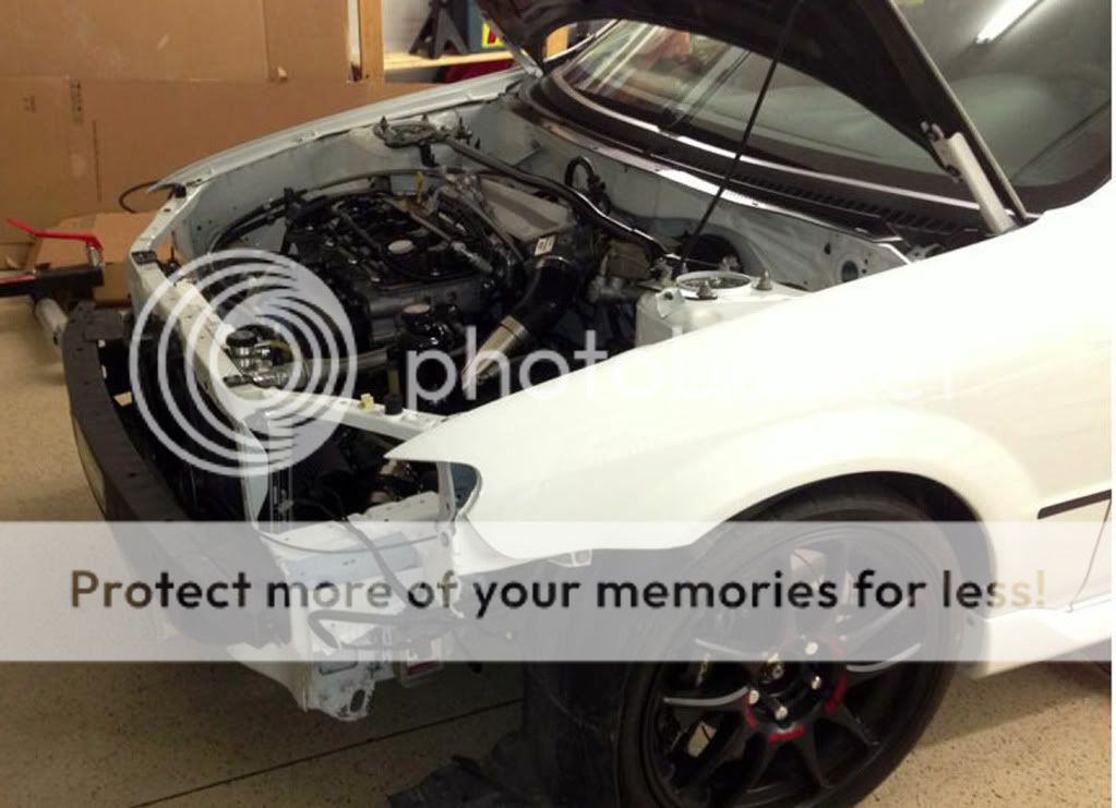

The plan is to not take the head off.
It's been really solid and I'm not interested in ******* around with shims and trying to find a shop.
with the GT 30 I have no fear in the turbo running out of efficiency.
No, This is current.
DOC B Oil System going in soon, So I Media Blasted the Windage in prep for a second AN10 Fitting (Oil Return)
