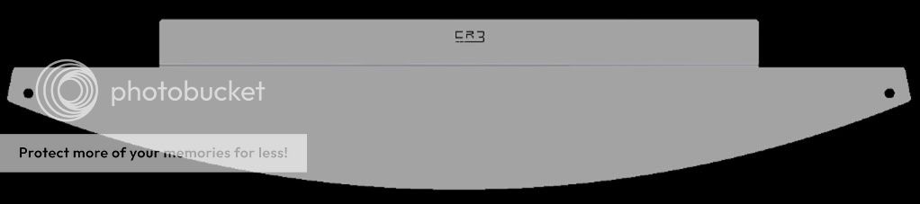

Are you eliminating the stock hood release cable, or are these to augment that?
Do the pins just mount to the rad support?
I was too scared to try and squeeze them in on the radius of the hood to not have enough clearance underneath without having to hack something else up. So I did what I've seen before with Citizenpro and a few others with the extension rod to bolt down behind each headlight.
