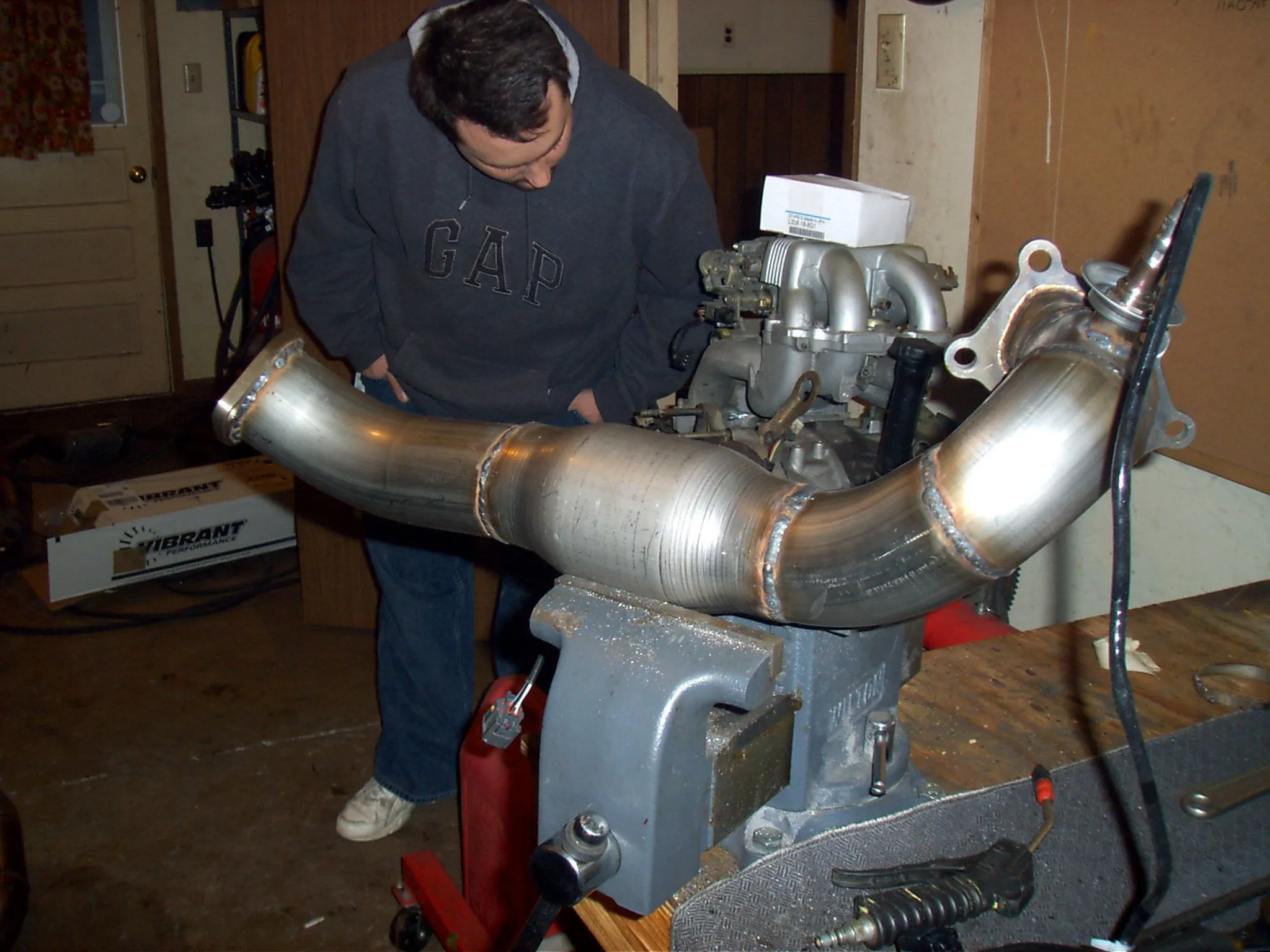

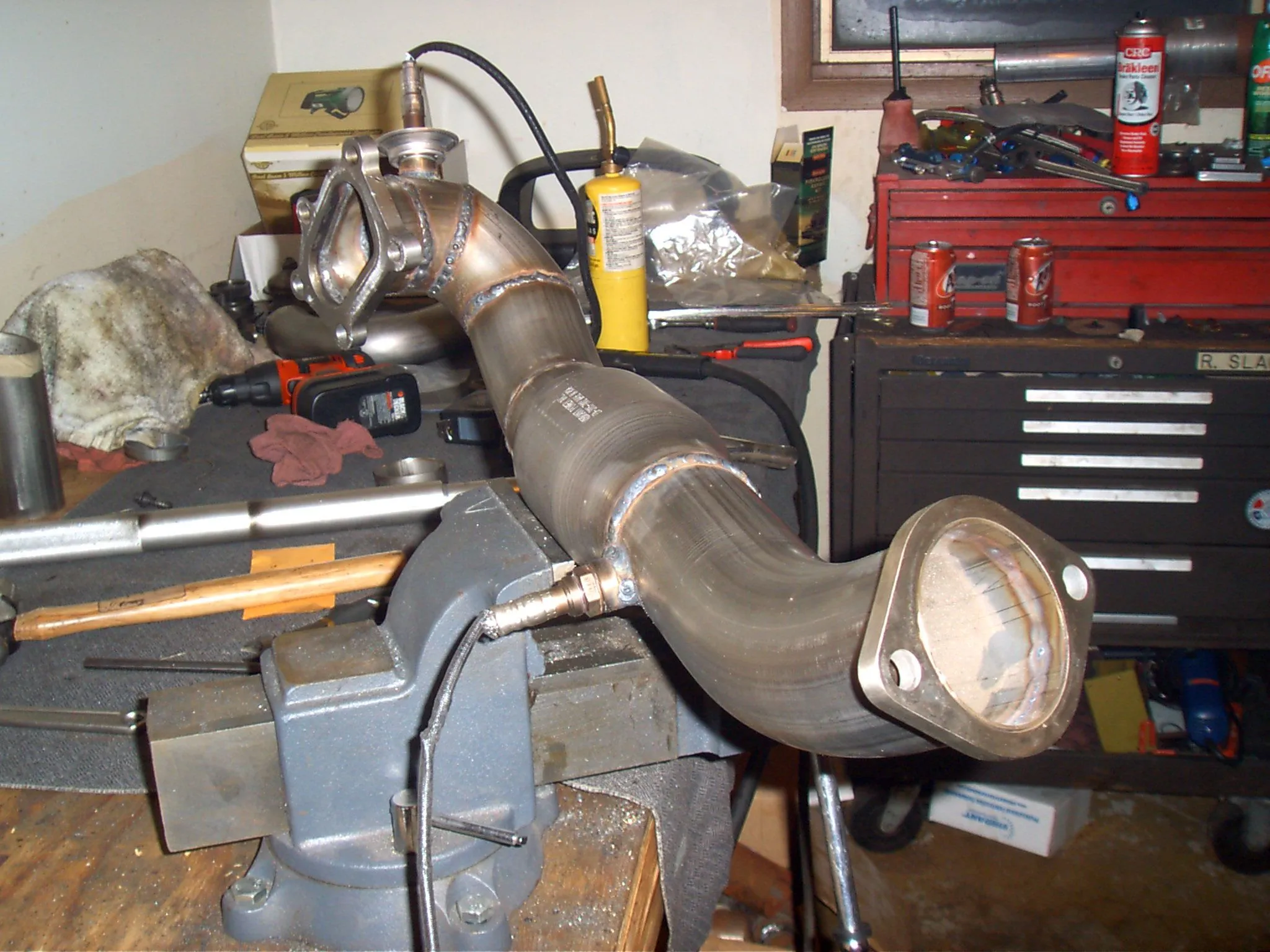

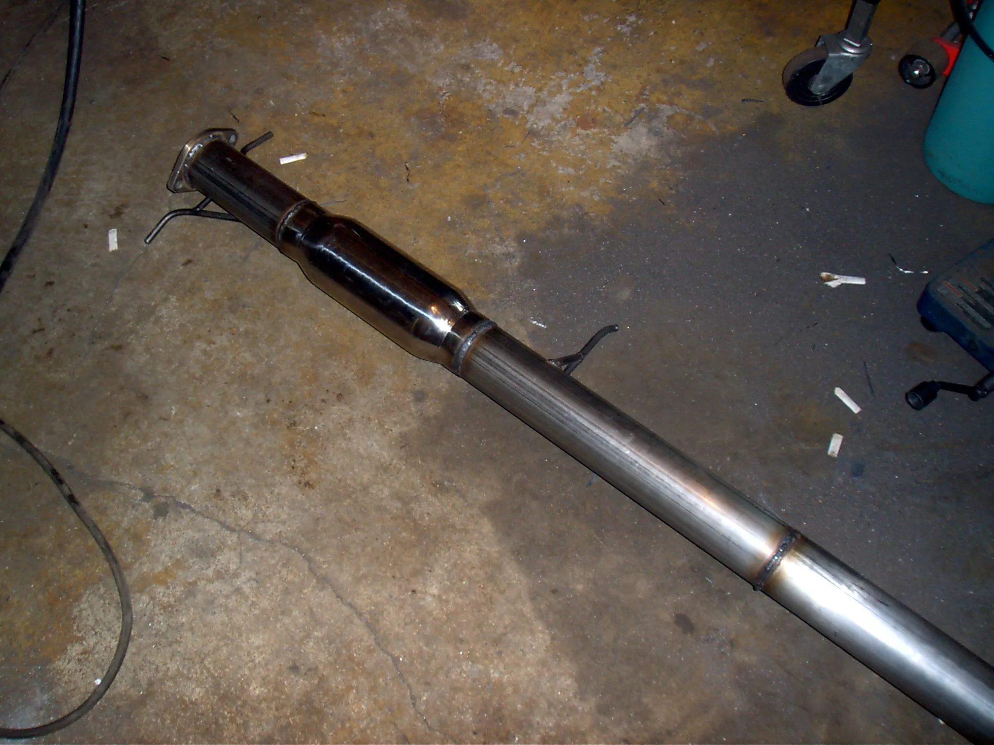

We've completed and installed our prototype turbo back exhaust system on tru-boost's mazdaspeed3. The system is a full three inch stainless steel system. Unlike some proposed systems, this includes a replacement downpipe. The prototype system uses a bottle resonator and a Vibrant TPV style muffler with a 4 inch angled tip. For emissions purposes we fitted the downpipe with a Vibrant high flow metal core converter. The car has not, after extensive testing, ever thrown a check engine light. This makes the exhaust system - in catted form - emissions legal.
There are minor fitment and contact issues that we will be ironing out before hitting production with these systems. Exhaust note is very nice and truly allows one to hear the powerband and the turbocharger. Acceleration is smooth and constant. We will be dynoing the exhaust system when the production model is ready. From my own drivability experiences I feel confident in two things - some tuning will be required to net the most on this car from any exhaust and there will be better gains on a catless system, regardless of how "high flow" it is.

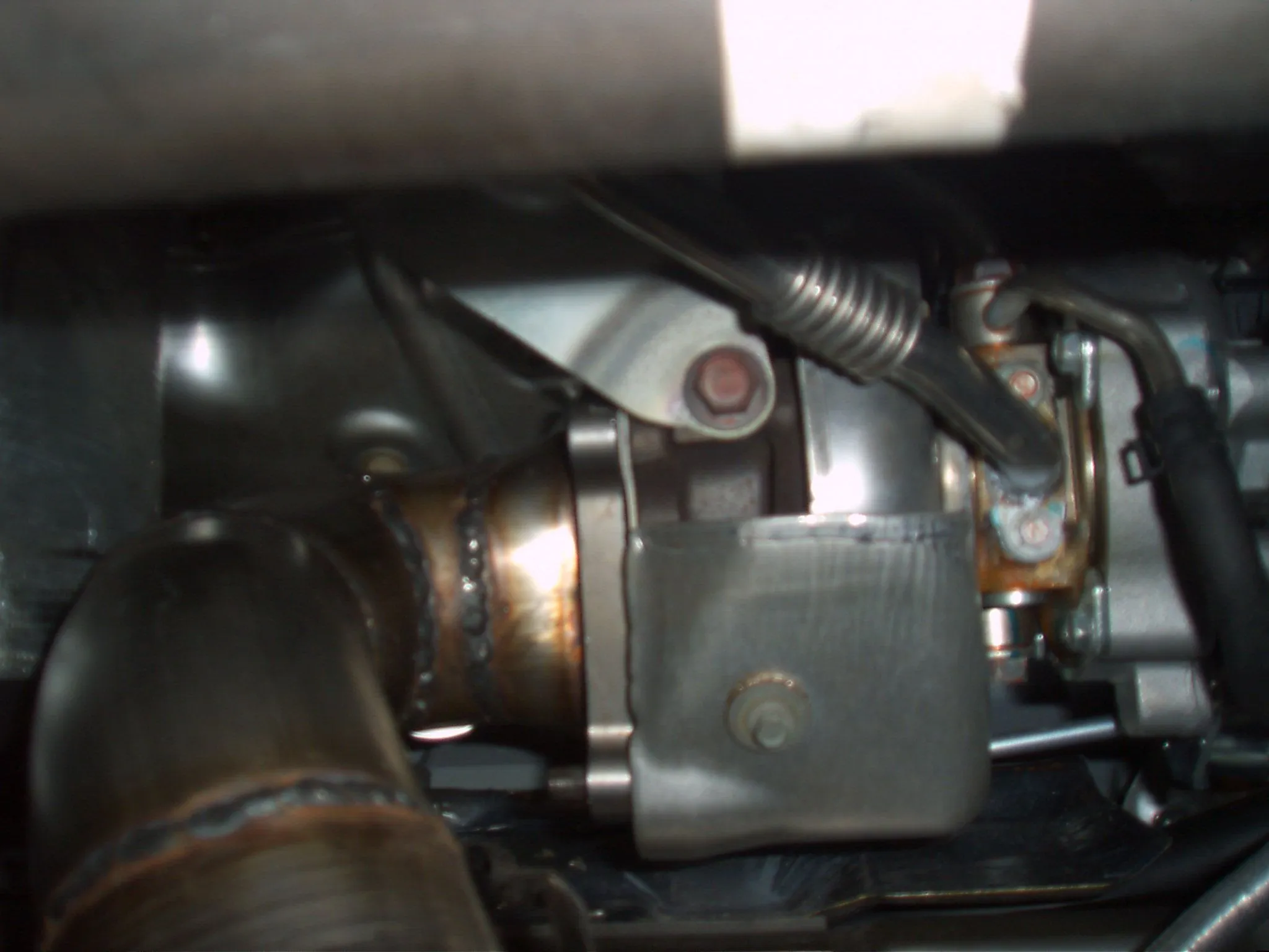

Note to everyone changing out the downpipe - be careful with the primary o2 sensor. if you break it, its a $300 part and very hard to come by from mazda at this time.

lol the first pic of the exhaust makes it look like a trucks turbo diesel exhaust. looks about to be id say a 5" exhaust system. but looks great hope for it to be out really soon, i want a louder system. i got bored and took out the second cat, i thought i would of thrown a cell but nothing yet and its been over 500 miles.

5 inch? haha no way. clearance issues make it very difficult to fit anything larger than a 3 inch system on this car.
definitely looks huge in the first pic. should you use a flex section with this exhaust?
the stock exhaust does not have traditional flex sections, so we went with none on the prototype. we will be adding them for the production model.
exhaust note is on the louder side, not obnoxious but quite a bit louder than stock. because this is not the production model i will not post any sound or video clips. the production version will more than likely not use the same muffler as that is part of the clearance issues. overall is is a great kit though even with the cat, butt dyno likes it !! it spools up much faster and has awesome low end power.... it always did but now it is crazy !! i get so much wheel hop i had to also get a motor mount from protege garage !! i will be doing the install on that today, i hope this will reduce the hop, at least a little.
the first two pics make the thing look ginormous! lol. any pics of it installed yet? just wondering how the muffler setup looks like on the speed3.

dang nice work ken that looks like a nice exhaust. The downpipe section is great, i wish i had one that wasn't divided but oh well. I'm intertested to see what it looks like on the car when you get around to taking some pics.

how many peices will the full TBE eventually be? will it be in 3 peices like the stock setup? will you be selling just the dp and test pipe or will it be all or nothing.
There is another guy who is making parts that match up at the stock flange locations and I kinda dig that idea of being able to peice together a system peice by peice.
5 inch? haha no way. clearance issues make it very difficult to fit anything larger than a 3 inch system on this car.[/quote]
lol i know it isn't that i just basically sayin that the pic makes it look like one. my fren owns a 4wd shop and i'm always there helpin out and thats what some gibson's systems look llike
