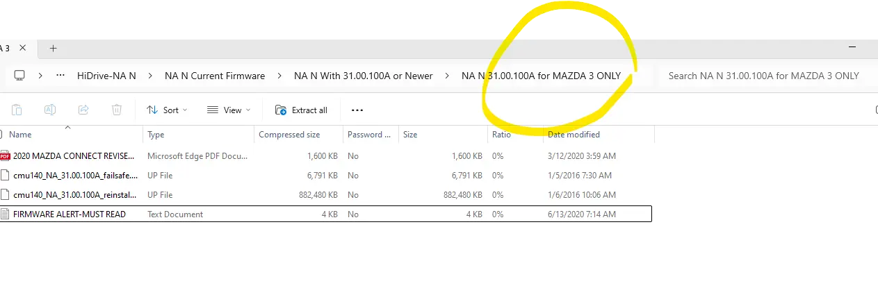

I have the files on a FAT32 2.0 tried 2 USB's and my CX9 Signature 2016 is not reading in either USB port did anyone else have this issue? Want to move forward with the update I received from @Candurin :>)
I was having the same issue. Do not do a quick format. Just completed the update using this video:
ok the ports are recognizing the USB's but it says no data available. I downloaded correctly on the flash drives. I followed printed directions and checked areas "2" and "3" on the screen prior to going to "99" to see available updates. When I click on that it says no data available. I hate to give up and go to dealer when I've gotten this far.....
Did you do the format and not the quick one? I had the same issue but after the reformat it worked. Try YouTube for install steps.
also this says Mazda 3 but I have a CX-9 does it matter?
