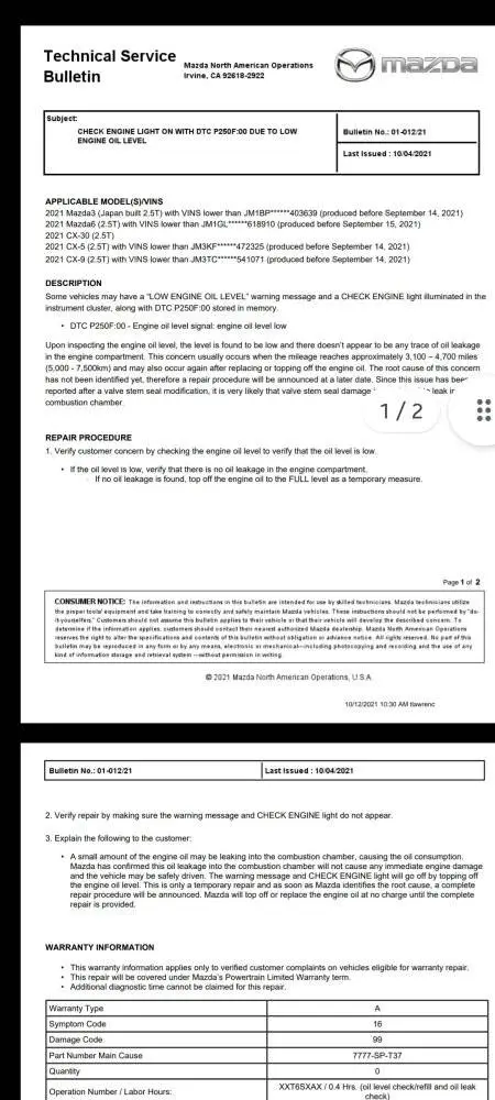

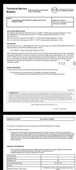

Mazda Oil Consumption TSB Turbo Engines
Components: ENGINE AND ENGINE COOLING, TIRES, ELECTRICAL SYSTEM
NHTSA ID Number: 10202685
Manufacturer Communication Number: 01-012-21-3832
5 Affected Products
Vehicles
MAKE MODEL YEAR
MAZDA CX-30 2021
MAZDA CX-5 2021
MAZDA CX-9 2021
MAZDA MAZDA3 2021
MAZDA MAZDA6 2021
Summary
Some vehicles may have a LOW ENGINE OIL LEVEL warning message and a CHECK ENGINE light illuminated in the instrument cluster, along with DTC P250F:00 stored in memory. DTC P250F:00 - Engine oil level signal: engine oil level low. Upon inspecting the engine oil level, the level is found to be low and there doesn't appear to be any trace of oil leakage in the engine compartment. This concern usually occurs when the mileage reaches approximately 3,100 - 4,700 miles (5,000 - 7,500km) and may also occur again after replacing or topping off the engine oil. The root cause of this concern has not been identified yet, therefore a repair procedure will be announced at a later date. Since this issue has been reported after a valve stem seal modification, it is very likely that valve stem seal damage is causing oil to leak into the combustion chamber.

Basically the TSB is saying a quart per 3,000 - 5,000 miles.
300 - 500 miles is excessive maybe, but the TSB is saying possibly every 10 tanks of gas check the oil and add a quart. Watch the oil level light.

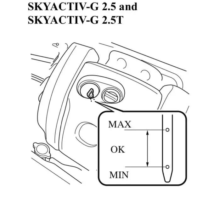

So what do you mean by “when I checked the dipstick, oil is below the 2 dots about halfway” when the Low Oil Level Warning Light was on? Was it below the MIN mark (hole) of the dipstick or in the middle between 2 holes? What was the oil level on the dipstick after you added ¾ quart?
And when you did the first oil change on your 2.5T with 5 quarts, did you checked the oil level at the time? 5 quarts should only give you about ½ between MIN and MAX mark of the dipstick. That’s why you’re getting the Low Oil Level Warning Light sooner within 1,500 miles.
Nevertheless your 2.5T is having oil consumption issue. But the industry standard for car manufactures when they consider it isn’t normal is the engine consumes 1 quart of oil per 1,000 ~ 1,200 miles. In your case the oil consumption is still well within specs from car manufacture’s point of view.
Nevertheless your 2.5T is having oil consumption issue. But the industry standard for car manufactures when they consider it isn’t normal is when the engine consumes 1 quart of oil per 1,000 ~ 1,200 miles. In your case the oil consumption is still well within specs from car manufacture’s point of view.
To clarify, the oil was below the min mark when I checked it as soon as the low light came on. Oil showed halfway between the end of stick and min mark.
I did check the oil level at first oil change and it was in the middle between min and max dots/holes.
I dont believe I should be getting a light/this kind of consumption with only 1,500 miles driven. I filled 3/4 of a quart and to me that's a lot of consumption. Nevertheless, Im documenting everything with pictures and notes in case something catastrophic happens or it worsens.
That’s scarily low when the oil level is BELOW the MIN mark of the dipstick!
That’s about right with 5 quarts for the oil change on the 2.5T. The manual says 5.1 quarts for the oil change on the 2.5T, although it actually needs 5.5 quarts to make the oil level to be at the MAX mark,
