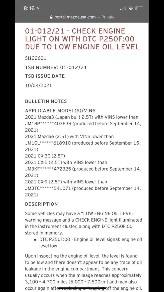

There is a TSB regarding the 2.5T engines about about this, however no fix yet, but seems Mazda is working on it.
Source:
https://www.mazda3revolution.com/threads/dtc-p250-error-code-low-engine-oil.243613/post-2522547
Wow. So this is a major issue. Oil is leaking into the combustion chamber and will require significant work to fix. It does confirm that the issue we are having is oil burning. This really sucks for me as I bought both a 2021 CX-9 and a 2021 CX-5 this year (both with the 2.5T). Argh.

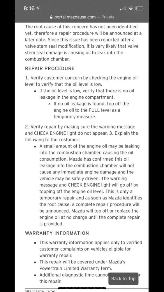

TSB No.: 01-012/21 CHECK ENGINE LIGHT ON WITH DTC P250F:00 DUE TO LOW ENGINE OIL LEVEL
posted above seems to haven’t posted on NHTSA website. Although the TSB says there’s no resolution for the problem, but it does say the symptom seems to start at 3,100 ~ 4,700 miles / 5,000 ~ 7,500 km, and the issue has been reported after the valve stem seal modification on the 2.5T.
What I was wondering is apparently the severity of this oil consumption issue is well within the allowed guideline which is using 1 quart of oil per 1,200 miles, does Mazda really need to come up a fix?

I don't know how unusual it is for a high performance turbocharged four cylinder to burn some oil. Hence the warning light. I have heard some say that a small amount of valve stem leakage can help lubricate the valve seats.
The problem the TSB describes sounds like one extra quart of oil between oil changes ( or a pint might suffice). Not much expense compared to the amount of gas.

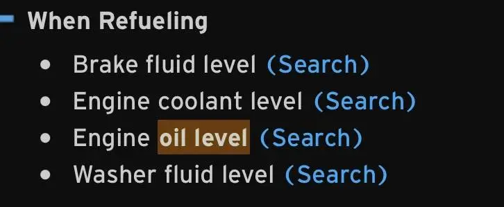

….I don't know what the manual recommends.…
Really? You don’t care enough about your CX to even RTFM? Wow. Just wow.
For those who do care about their ride, the manual recommends checking the oil every time the vehicle is refueled. I guess that today’s owners can’t be bothered….
2022 2.5GT
That’s a bit mellow dramatic. I check my oil weekly until I get to know what to expect. Could be every month or more after that. Checking the items above at every fill up probably occurs by 0.001% of owners of any car. It’s a ridiculous disclaimer statement.
