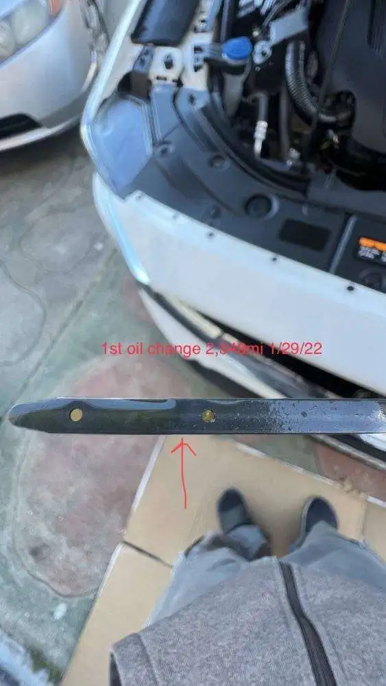

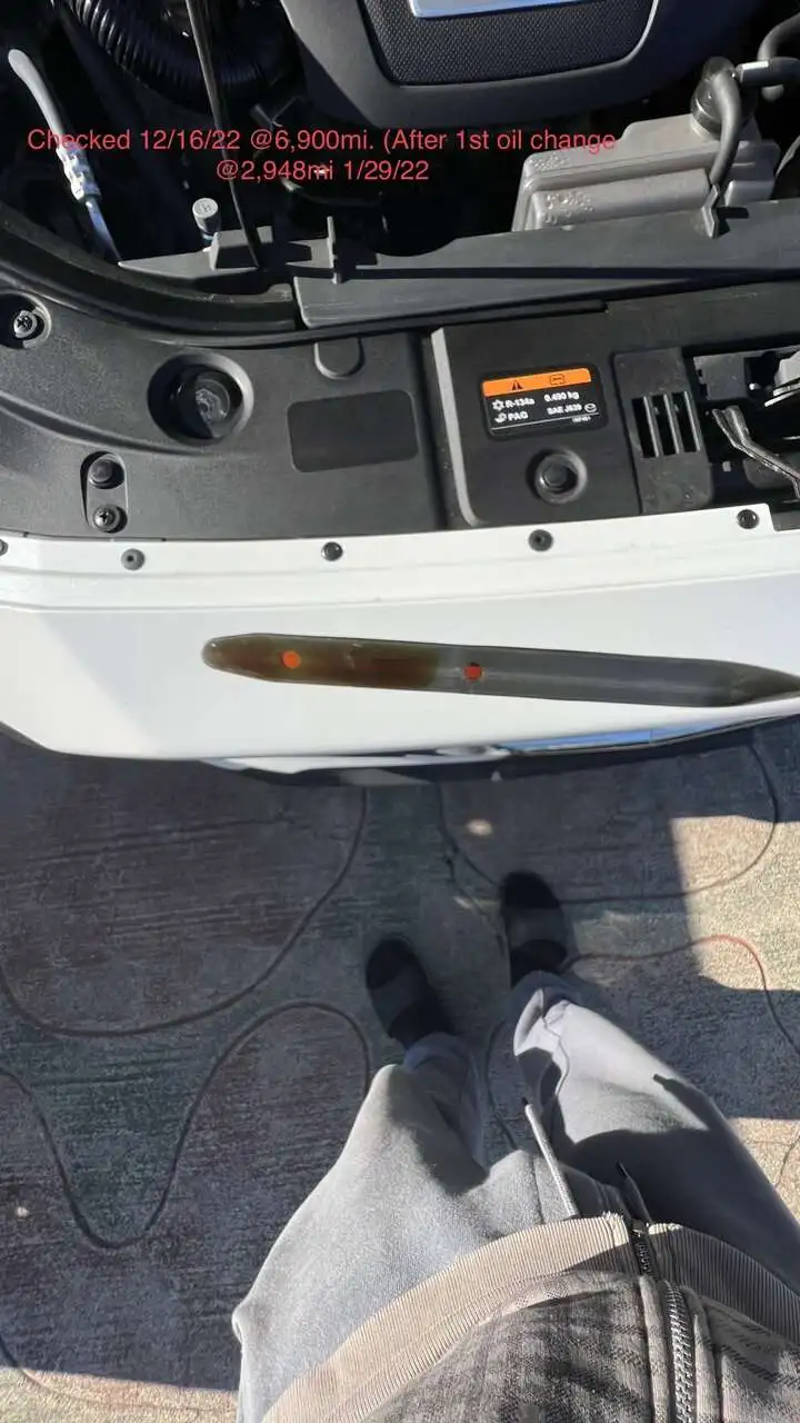

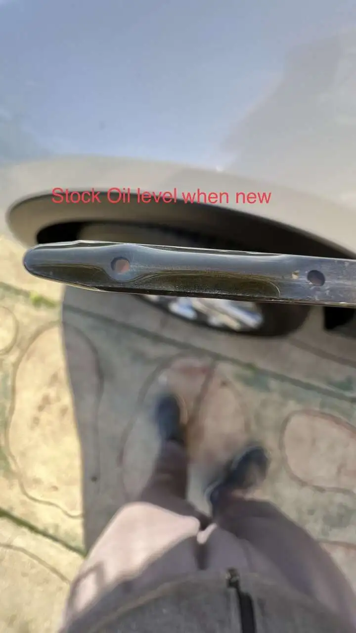

I'm not sure. My low oil warning light came on and I was not yet due for an oil change service so that's why I took it in and was told about the cause since there are no leaks.Here is mines:
Cx5 new:
oil changed at 2,948mi 1/29/22:
checked today (6,900mi) 12/16/22:
Looks good?
That is encouraging. Thank you for sharing.My Mazda 3 had the TSB fix in October. I’ve put 1500 miles on it and the oil level has not moved. It took them a full day but so far so good.
